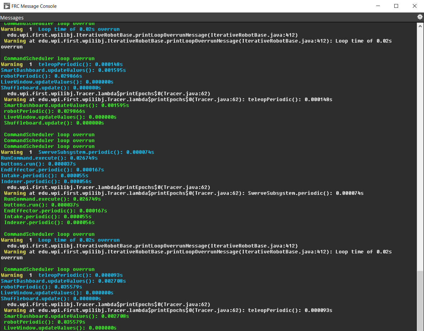

I’ve been experiencing a pretty bad error where the robot will disable itself temporarily due to a Command Scheduler loop overrun. I know it has something to do with the one of the commands I am executing, but I have no idea where to start looking. I am wondering if using multiple motors at high voltage could cause this, or where else should I look? I have linked the photo of the error log below and you can access the code here : GitHub - FRC1466/robot-code-2024: Robot code for 2024 season
Thats a warning not an error. The warning is that your code is exceeding the main 20ms loop.
Reading that console output, it looks like RunCommand is taking ~26ms. Looking through your code, you don’t have a RunCommand class, so I presume it’s the one from WPILib, likely instantiated from a call to something like Commands.run() or .runOnce(). I dont see anything too crazy in your code (assuming I was looking at the right branch).

That said, I don’t expect it will solve the overruns. The fact that the overrun is labelled RunCommand.execute in the log means that it is a single call to RunCommand.execute that is using the time. As far as I’ve been able to determine RunCommand is only used when your code creates a command with subsystem.run() or Commands.run(). It does not get used when your code creates commands with runOnce. And the only place I can find in your code that uses run is the commands for the SwerveSubsystem and that ultimately leads to the swerveDrive.drive method. I believe that comes from the YAGSL library and so I can’t see it in your code.
One thing to do that would be helpful would be to attach a name to the default SwerveSubsystem command. In the commit of your code that I’m looking at you could do that by changing line 78 of RobotContainer.java to
    () -> MathUtil.applyDeadband(driverController.getZ()*.8, .1)).withName("DefaultDriveCommand");
After that, overruns due to that command should be reported as belonging to DefaultDriveCommand.execute instead of RunCommand.execute. This would at least let you confirm that the drive command is the culprit.

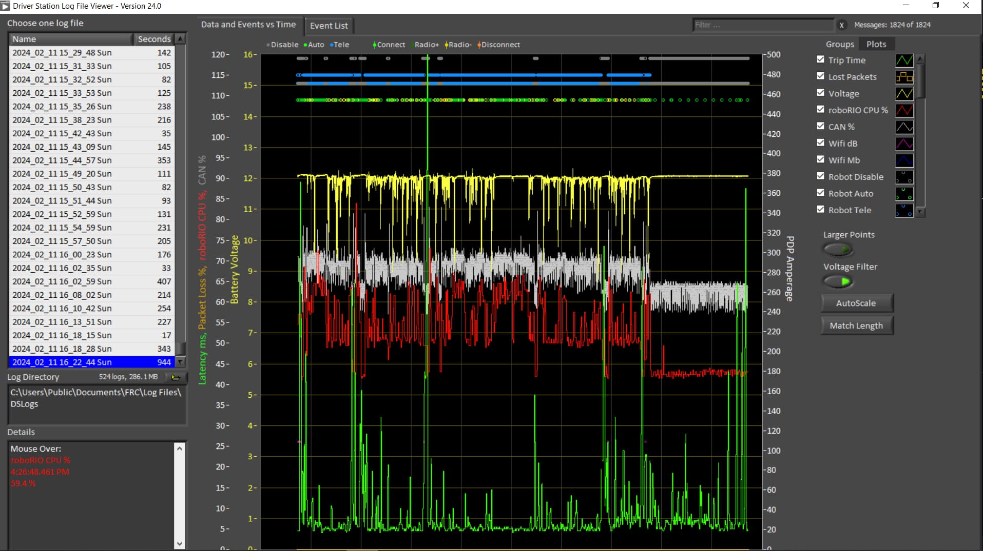

You are right, it did not fix my issue. The robot still disables both while tethered and while connected via radio. It seems that the issues are more prevalent while connected to wifi. I did the change you suggested, and have also updated the code since, here is the link - GitHub - FRC1466/robot-code-2024: Robot code for 2024 season . I am also posting the rio logs and charts for while I was driving the robot and moving the arm while tethered. The green spikes are the connectivity spikes where the robot temporarily disables.
Some progress. The named command confirms that the overruns are associated with the Drive method. I’ll look again but I was convinced before that it could only be in the YAGSL code.
I’m not fully convinced that the disconnects are due to the loop overruns. Could you upload the DS Log file (the actual file, not just the image) that you included in your previous post? That may help understand whether the overruns and disconnects are happening at the same time.

So I have a strong guess that updating to the latest YAGSL will fix the loop overruns. In the version you’re using, on each iteration each module calls CANCoderSwerve.getAbsolutePosition which will try up to 5 times to get a valid angle, waiting up to 10ms per try.
The newest version implements a cache that should make this far less likely if not impossible.
I would still like to see the DS log file as I’m not convinced that the disconnects are caused by slowness reading the CANCoders.
The loop overruns were troubling to me and that is exactly why i made thr Cache. It will get even more unlikely with the next update tomorrow that will reduce extraneous memory utilization we found a few days ago.
