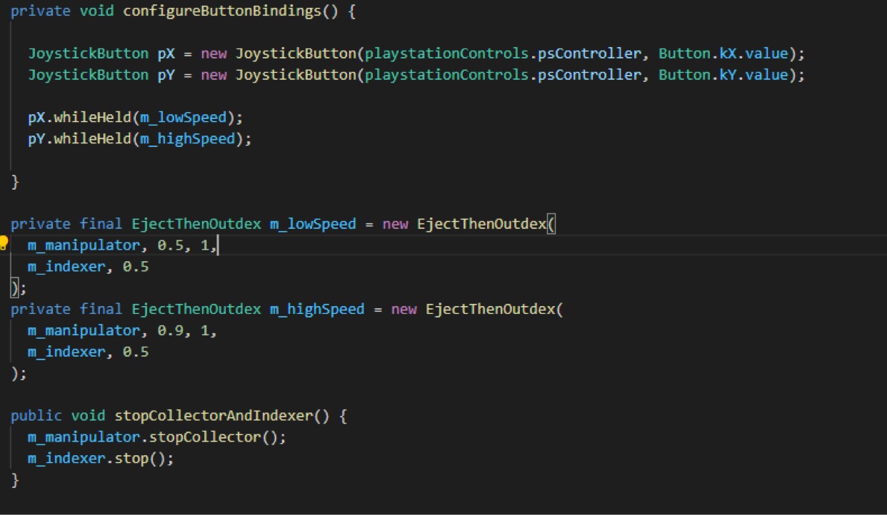

I’ve tried kX.whilePressed and a few things that pop up when googling it
That’s exactly what I mentioned above that I tried
What exactly did you try? You likely made a mistake somewhere, because the library is known to work.
This is what I have
That’s really not enough to do any debugging. Put your code on github, and insert some print statements during your next run to try to figure out what’s actually happening.
I think it was the Button.kX.Value I replaced it with the button number and the simulation works
The issue was probably that you seem to be using a playstation controller, but using the Xbox controller bindings (playstation does not have a Y button). If you want to use premade constants you can import the PlaystationController.Button class vs the XboxController.Button class
It’s a odd controller that’s mapped like a Xbox in the shape of a ps it’s the one I see a lot of teams using
