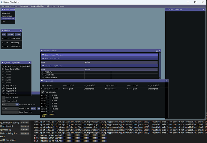

I have created a test project that works fine here. If you have any code that can reproduce this problem I would be interested, but as of now I cannot replicate your issue. Your 2022 code is completely different (this code was even available in 2022), but I agree that it proves that the trigger is working on your controller but the Driver Station should also prove that. You are using the trigger, (the variable press buttons on the back of the controller) right? You are also pressing it more than half way right?

We’ve been experiencing issues where the Driver Station randomly recognizes different axes with different configurations whenever it is asked to load USB Devices. So, whenever our USB Hub is unplugged and plugged back in, we put our computer into sleep mode.
The most notable difference to me between the configurations was the separation of the left and right trigger axis; in one instance, the two triggers were combined to create an axis that ranged [-1, 1], and in another instance, the two triggers were separated into two axes that ranged [0, 1]. In creating this additional axis, all of the subsequent axis ids were also pushed back by one, which caused our code to stop functioning correctly.
The issue on this thread seems similar to ours, which could suggest an issue with NI’s Game Tools this year, but I think there’s also a possibility that there is an issue with our Xbox Controller Drivers. We’re open to any suggestions for resolving this issue.
Following up on what @StarbuckBarista wrote, are the gamepad axes supposed to remain numbered the way they used to be in 2022 and before (i.e. LX 0, LY 1, LT 2, RT 3, RX 4, RY 5) or are they now dynamically numbered?
I now vaguely recall seeing some warning about a controller axis 5 not being found in the robot output yesterday (but working on something else and not really paying attention) …
