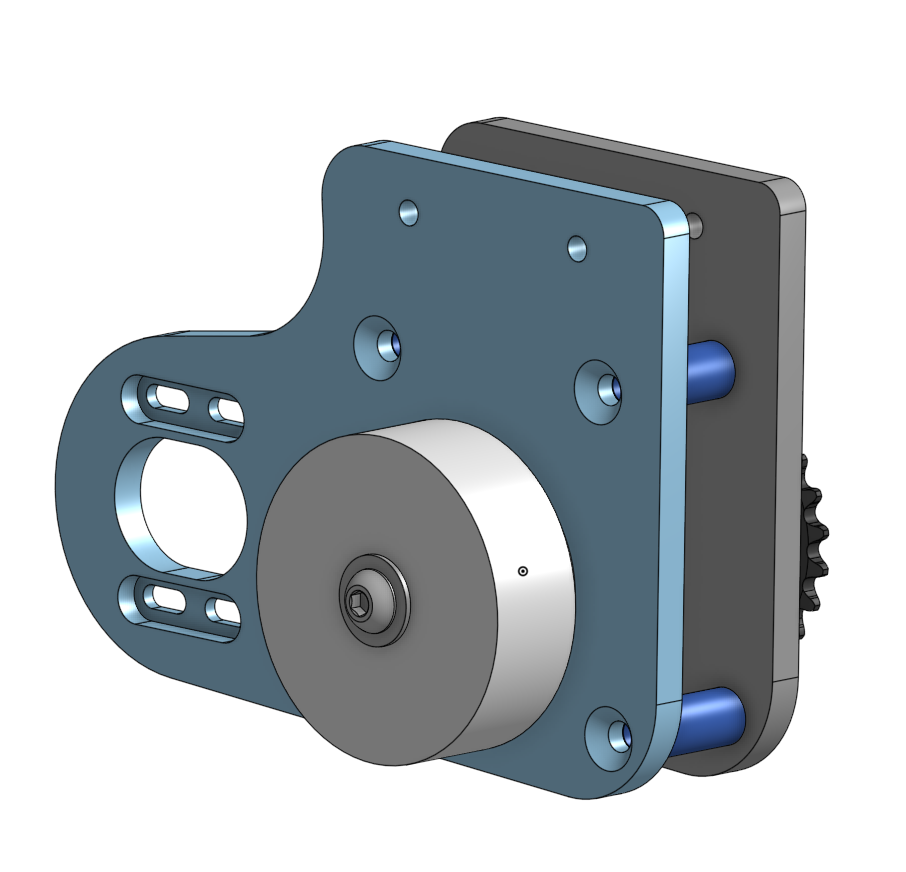

For reference, the designs I’m currently working on :slight_smile:

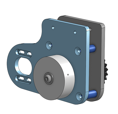

To me it looks like an in wheel differential/drive…at least that’s my best guess.

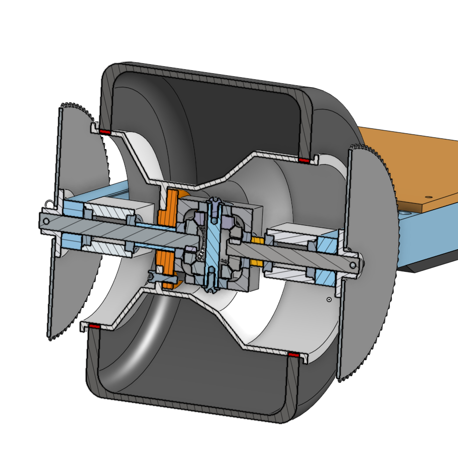

Building a hybrid gas-electric Onewheel. Doing a parallel hybrid, hence the differential
FYI, you need to think through the “off” state for each drive. You likely need a brake mechanism on both, if they are capable of free spinning. If one spins, you won’t get the wheel driven forward.

Both spin at the same time. The motor essentially smooths out the torque of the engine and biases the torque to the set point (since it’s hard to precisely control engine torque)
