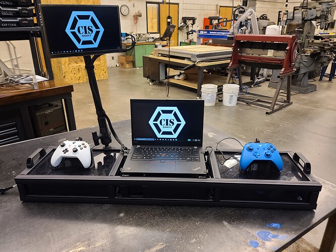

Here is our setup:
The computer is a Lenovo ThinkPad X395 with the following specs:
Configuration Details
● Processor: AMD Ryzen™ 5 Pro 3500U (2.10GHz, up to 3.70GHz Max Boost, 4 cores, 4MB Cache)
● Operating System: Windows 10 Home 64
● Display Type: 13.3" FHD (1920 x 1080) IPS anti-glare, 300 nits
● Memory: 8GB DDR4 2400MHz (Soldered)
● Hard Drive: 256GB SSD PCIe
● Graphics: Integrated AMD Radeon™ Vega 8
The frame was orderd from 8020.net - if you want the list I can send it to you, PM me.
The mounts are RAM Mounts:
(1) RAM Universal Laptop Tough Tray Flat Arm - RAM-234-3FL
(2) RAM 1.5" Track Ball with T-Bolt Attach - RAP-354U-TRA1
(2) RAM Socket Arm w/1.5" and 1" Socket 18" - RAP-CB-201-18U
(4) RAM 2-7/16" Dia Base - RAM-B-202U
Doesn’t matter how tough you build these things - the kids will find a way to beat them up pretty good. This set-up was built in 2019/20 and it already looks like it has been through a few seasons of FRC.
Let me know if you have any questions - I don’t think we are at any competitions together this year as you are at 10K Lakes and we aren’t in Minneapolis at all this year.
