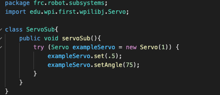

Update:
While following your advice and following FIRST’s Repeatable Low Power Movement guide, I created a small piece of code for the servo’s subsystems file under the subsystems folder (which is utilized to rotate it, such as the angle and positioning) but while I have a grasp for the subsystems what should be put inside the following command class?
Code(If wish to review):
Screen Shot 2022-11-27 at 2.27.19 PM
I don’t mean to insult your intelligence but you do know you need a lot of code for the most basic robot program be it iterativeRobot or command-based robot?
For iterativeRobot you put your movement operations in a periodic method such as teleopPeriodic().
For command-based you define a subsystem say DuckGrasper that includes servo and whatever else you need and then define commands using that subsystem such as resetStartingPosition like the code you show.
If you’ve never done WPILib programming then you need the lessons like Zero to Robot and the Command-based lessons.
We’ve reached my limited ability to help by remote. I can’t explain any better than I have. Maybe you need an experienced programmer to go through this with you. You could accomplish in an hour what I cannot do since I lack the knowledge, prepared lessons, and the Romi with servo.
I’m not insulted in the slightest just new to FRC programming, thanks for the help though
I’m not sure you’ll be able to grab a Duck before your competition but you could start with the Romi example in WPILib, delete all the stuff you don’t need and add your servo code. You seem to be an avid reader - you have lots to read!
