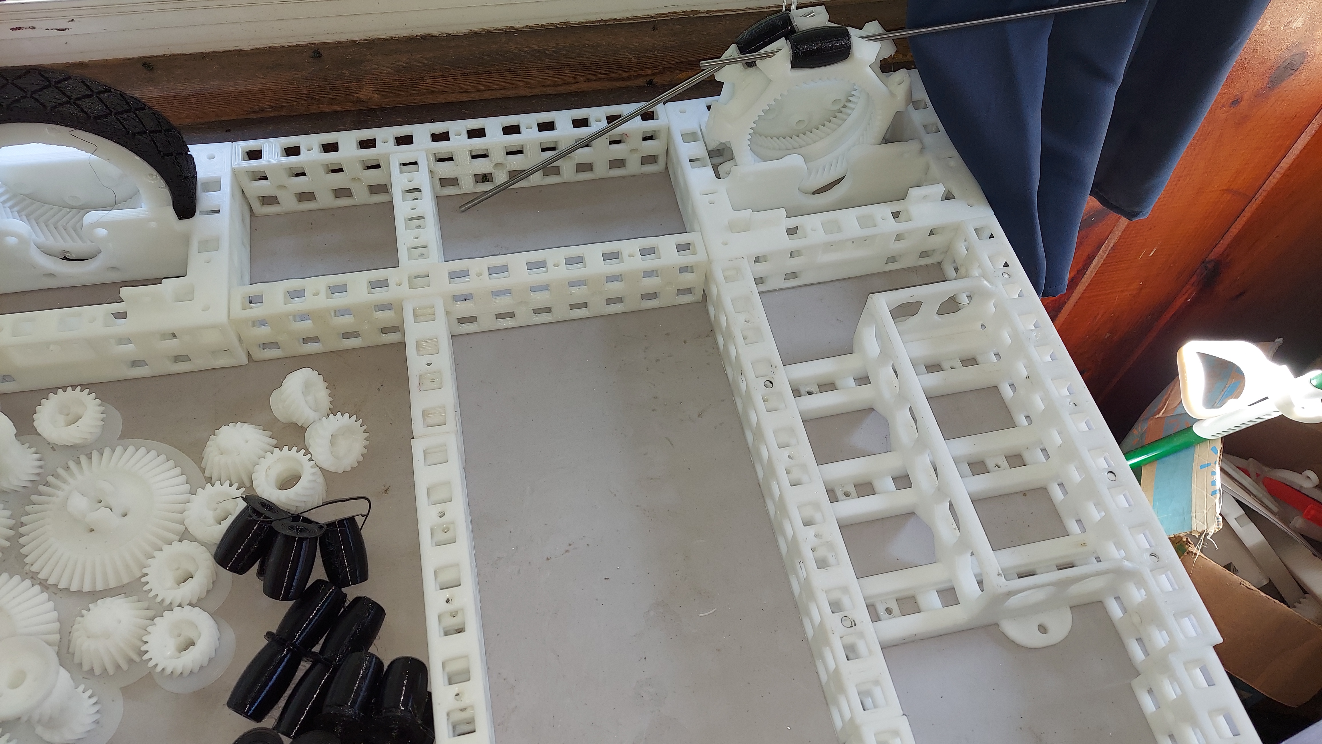

Doing a feasability study with a local team as to how inexpensive you can do a custom frame based robot. The robot will hopefully be part of an off season competition or 2 - That is if we can locate a set of FRC legal electronics to run it. If not it will be arduino/ESP32/BTS7960 run.
Of course as its me there is a lot of 3DP I have been busy 3 weeks now with that (I am retired). The bottle neck is cad. I probably can print it in less than a week with what I have - If all the cad is done. I had designs to mount some toughbox minis but no toughbox minis and the budget is allready strained. I got 10 CIMs though so everything will be run by CIMS. Ideally some should be PG71 but hey - its a build out of what you have project
The dimension of the robot is 29.5 x 29.5 so about 118 circumference. The 1/2 in in each direction is to allow for Fiber Glass reinforcement if we decide on that.
So the composite in the frame will be plastic (HIPS and PETG) probably in some places wrapped in 10 oz cloth 1-3 layers. the square holes take 1/2 in square tubing 16 gauge either aluminum or steel. The decision has not been made yet if we go for a light weight (just shy of 100 lb) or if we shoot to get close to the 125 max.

Overview of all parts cadded and printed so far. Its a revamp of the 1989 2019 frame with some upgrades and (hopefully) improvements so the next iteration if you so want.
This is a focus of the rear which will have the battery and electronics
The frame will have to 6.31 in bumpers in the front and an almost 17 in cutout for the recessed shooter/ball pickup.

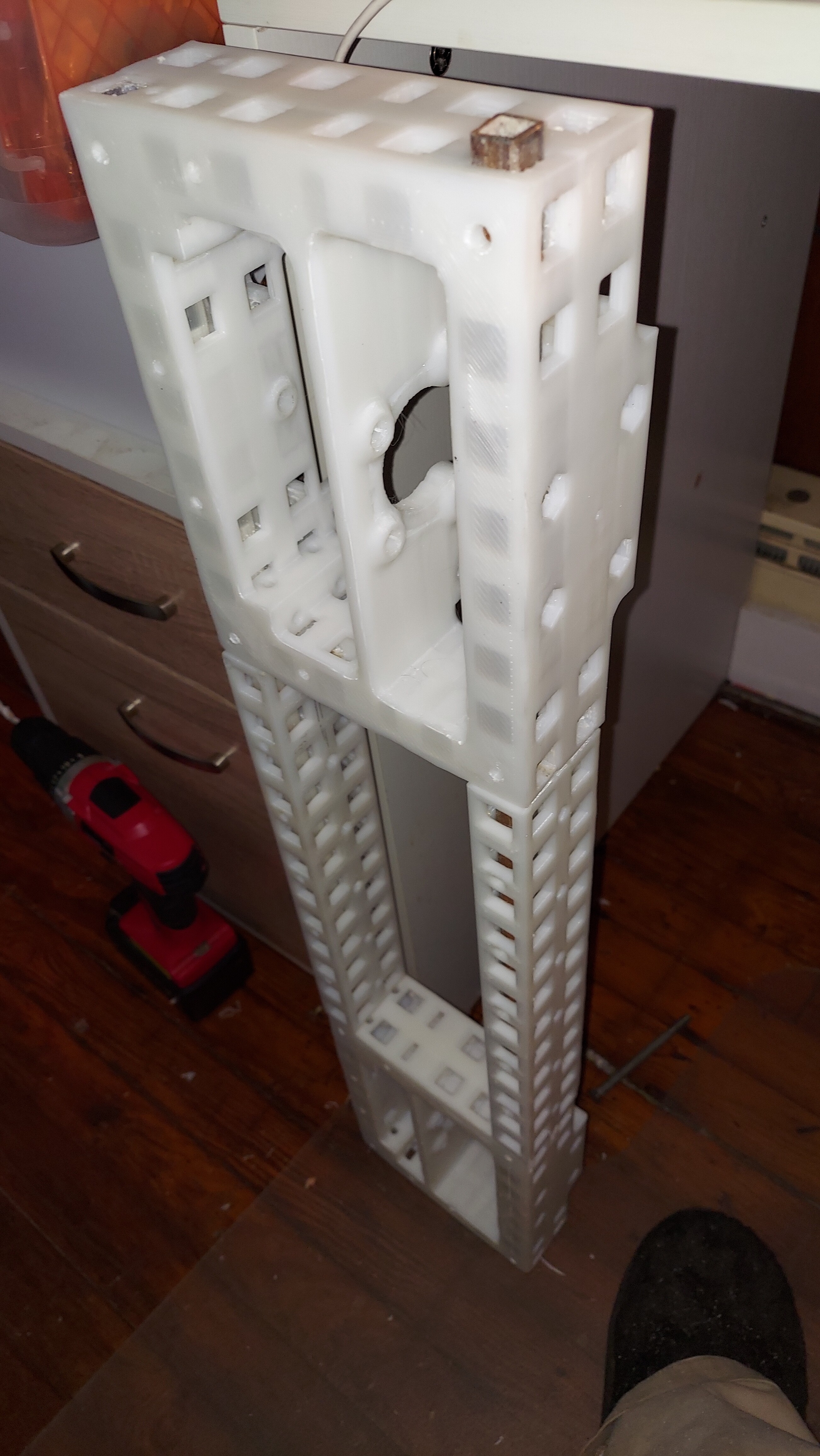

It will also sport a CIM powered with custom 40ish:1 reduction for climbing and a 2nd CIM with 20ish:1 for helping out and moving the arm to grab the next rung.

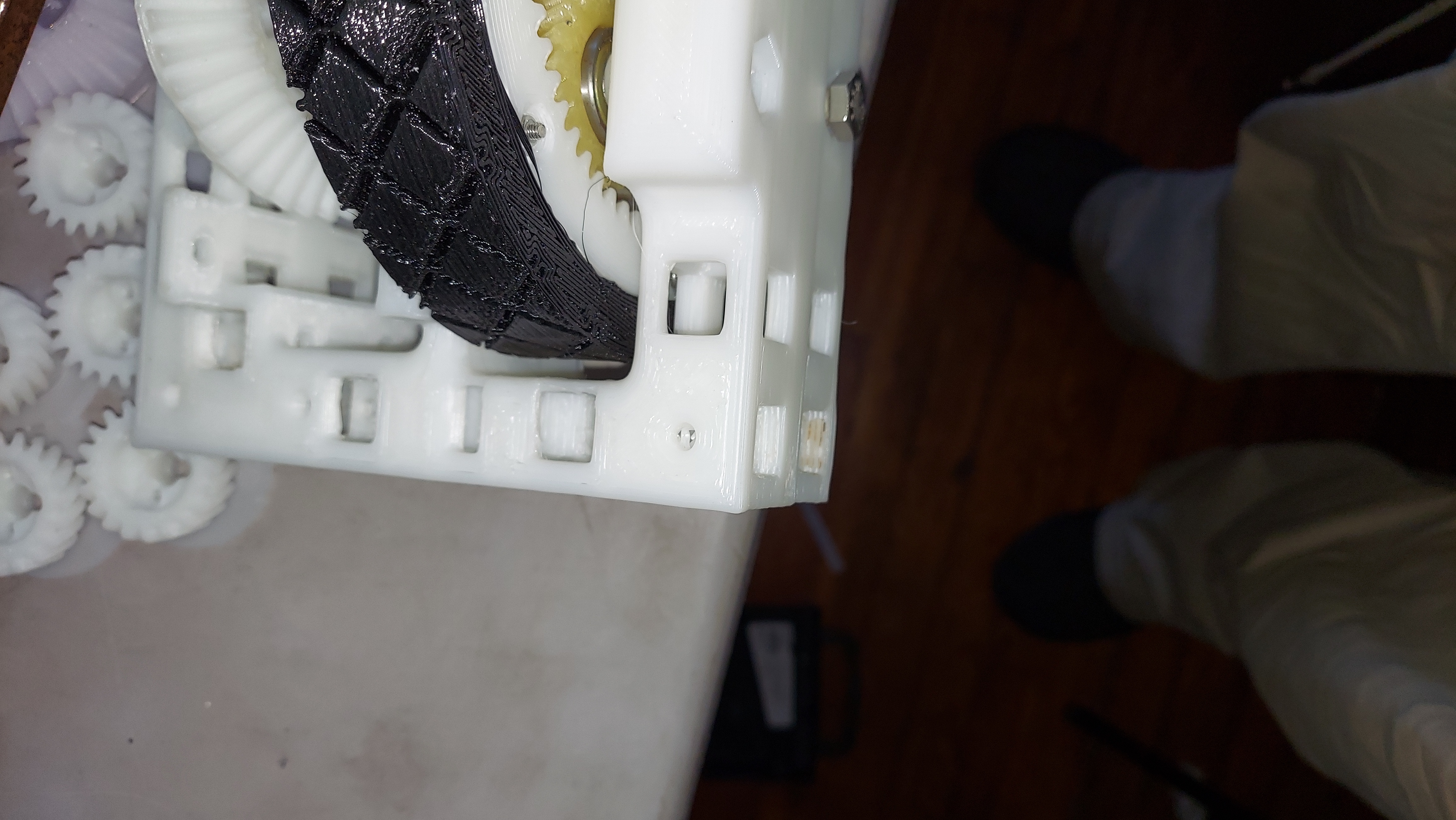

Here is some pics of the front wheel tank drive setup. It was desided to put the main wheels in the front (the opening) as it will make ball pickup and aiming in general easier for the driver. So the back where the climber is mounted will have powered omnis. The first stage is 41:19 on a bevel setup to save space so the whole drive module is 6.3 x 8.4 in thereabout. Allowing for a wide intake opening
Some pics of the tank drive module

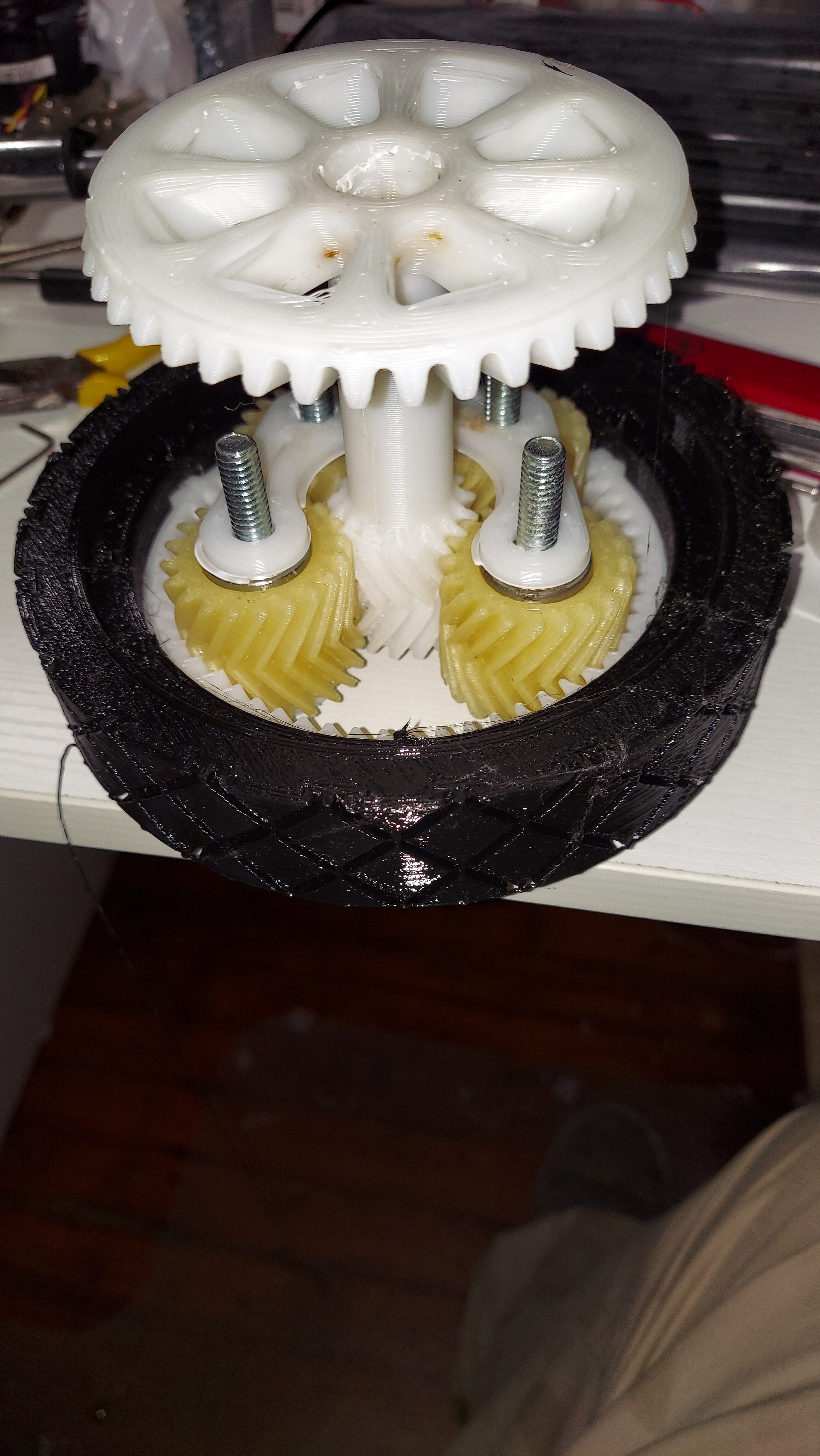

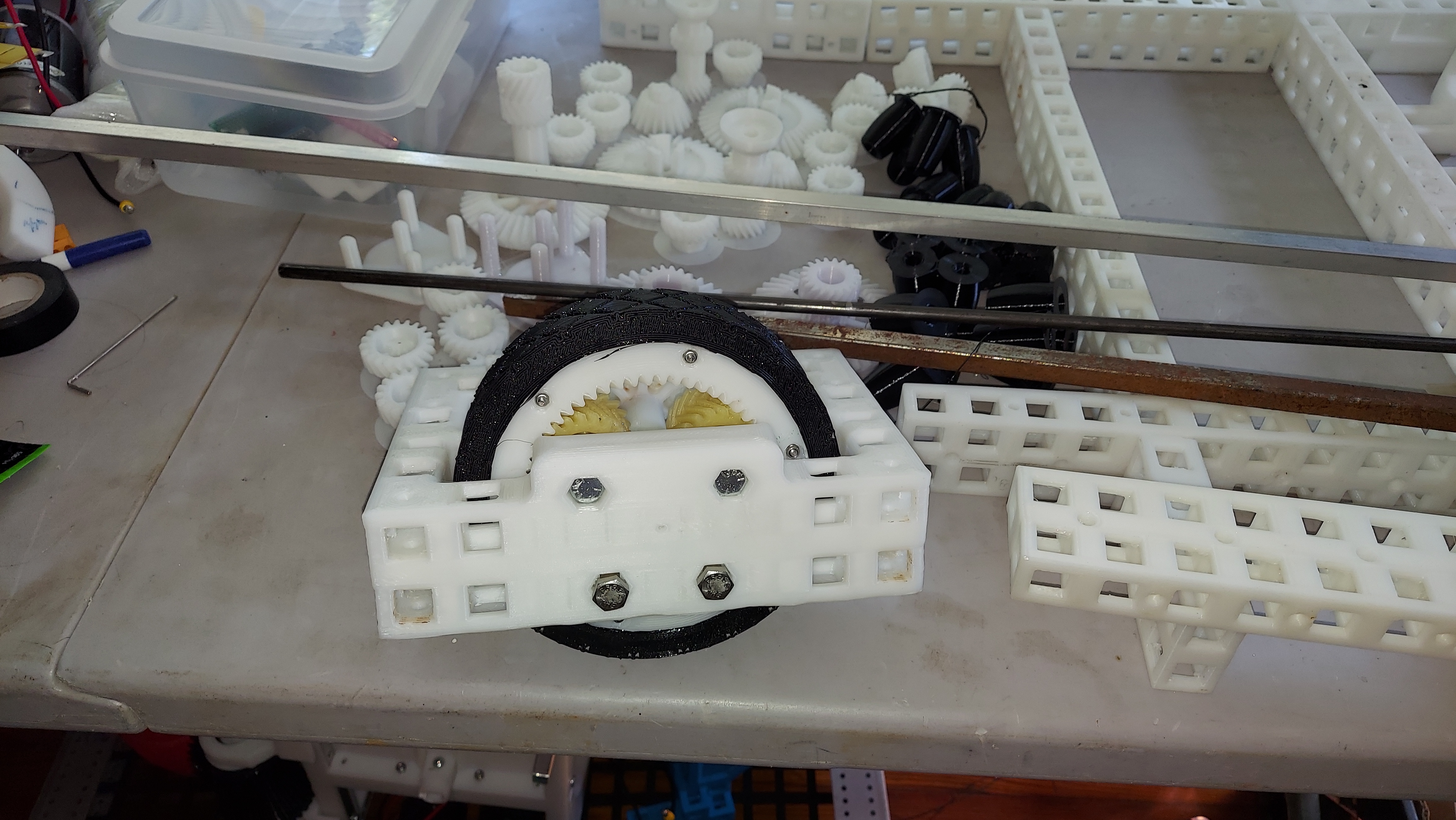

The rear will have the 2 in wide omnis with also a planetary inside and a bevel gear input. It was quite difficult to stuff the existing planetary from the front into a custom omni but looks like it happened (proof will be in it running and not breaking. The rim/omni setup might be a candidate for Nylon but for now its HIPS and PETG.
The prior tests have indicated that PETG and HIPS with a dab of silicone grease will way outlast a season. Now we will see if they survive the abuse of driving it.

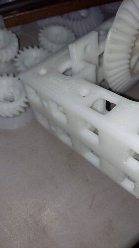

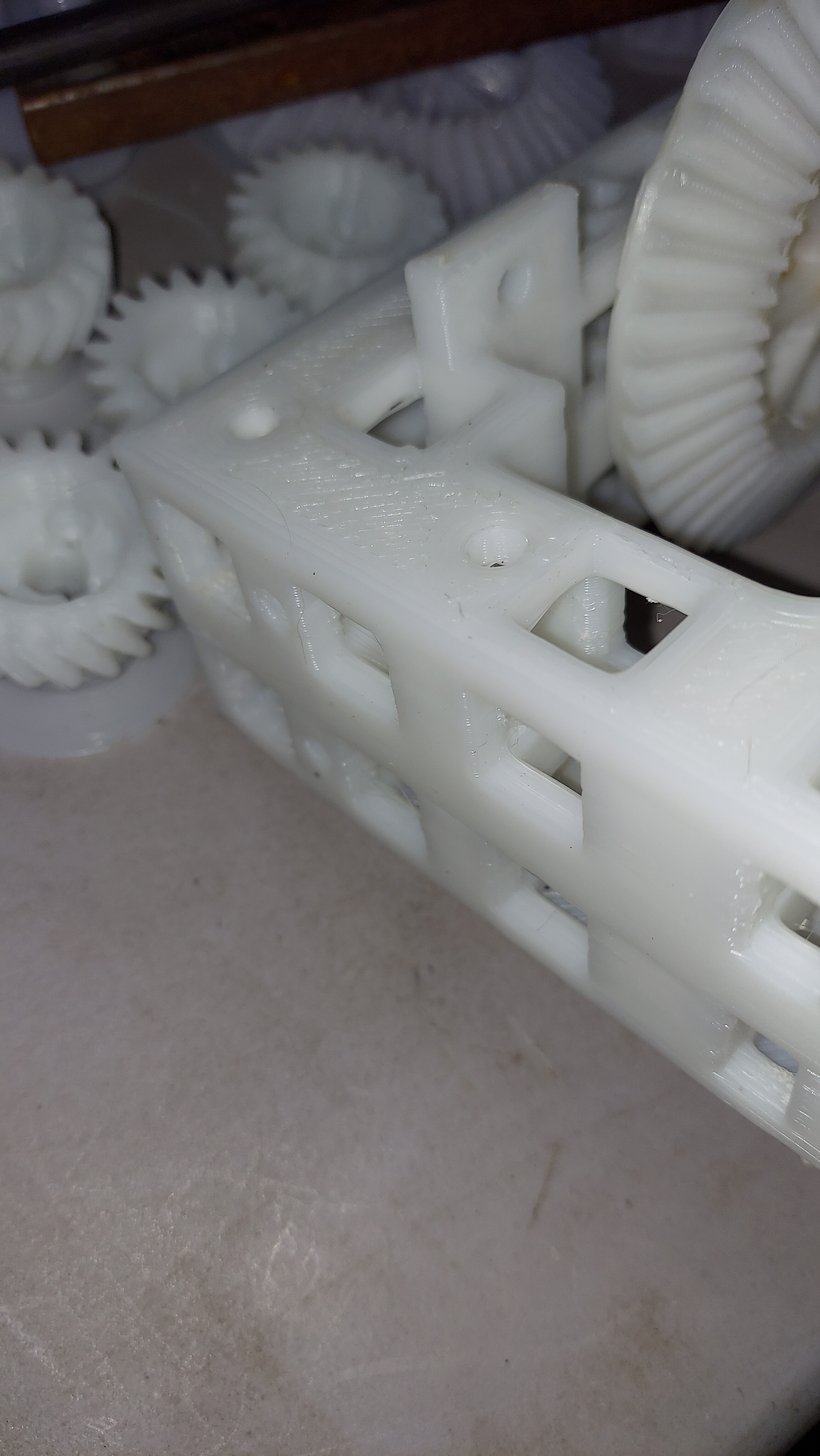

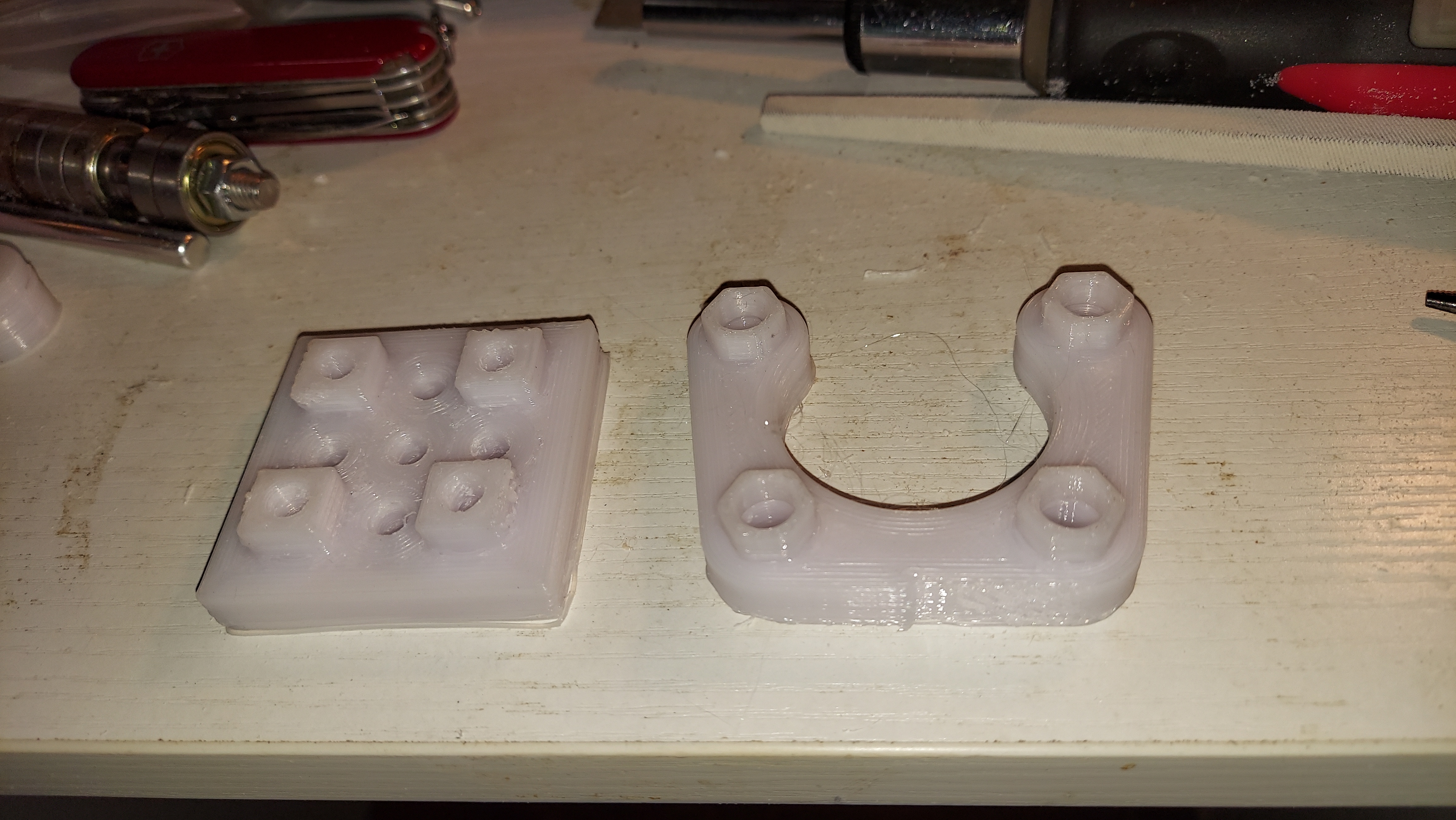

The frame is based on 26.7mm section so a 28x28 section makes roughly 29.5 x 29.5 mm section allowing to be legar with reinforcement either fg or even 1/8 in AL plate. which would bring it to 29.75 x 29.75. (hence that odd measure

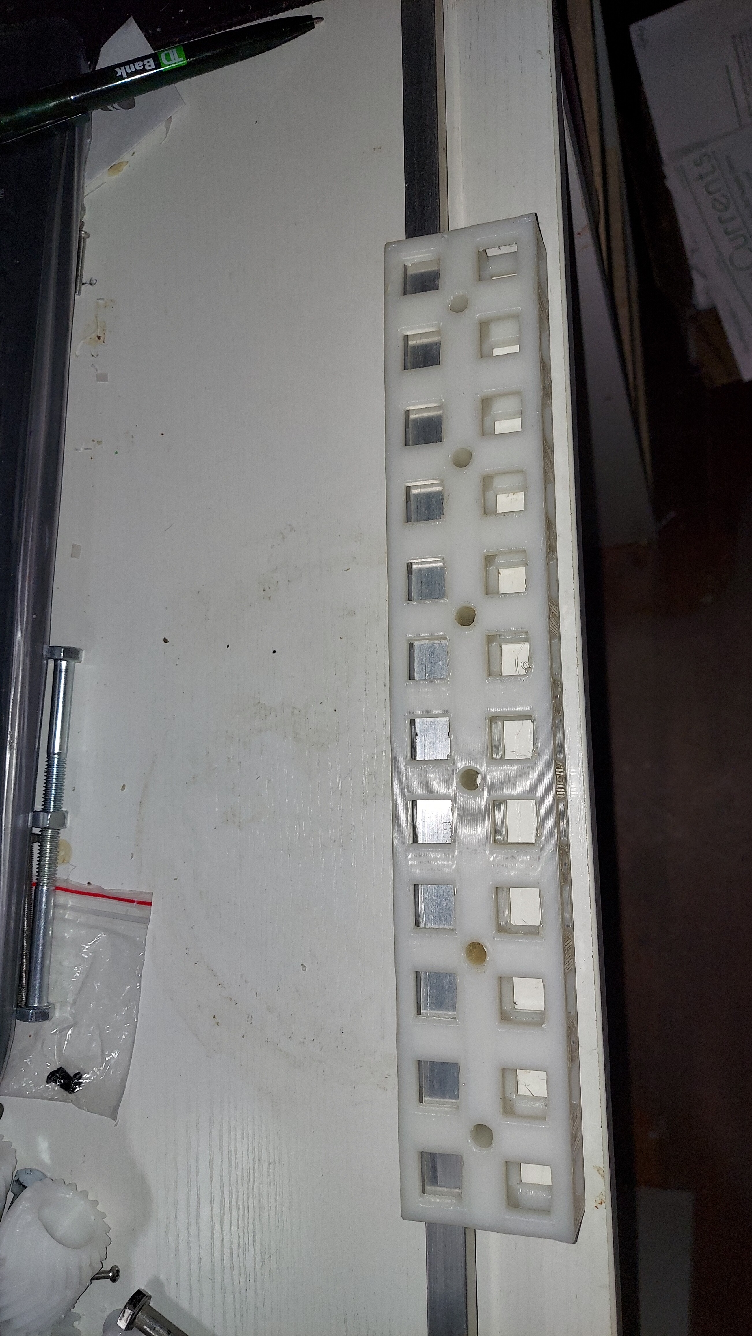

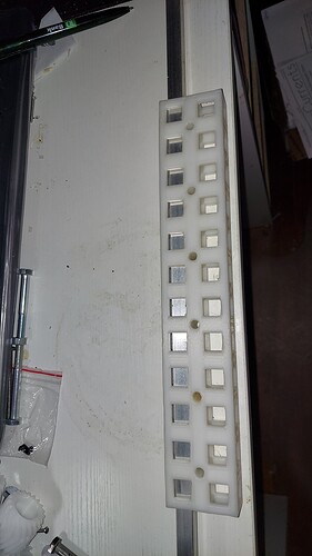

The square holes are 14x14mm allowing even with slight print imperfections and some slight possible warping to insert a 1/2x1/2 in square tube with minimal cleanup
there are 2 layers to allow to “double up” in critical sections and to mate the 1/2 in bars at corners
At the corners where 2 bars meet holes are placed to allow to drill through both bars (5.5mm drill bit) and fasten them with an M5 bolt. The size was also determined to its current dimensions to allow to countersink or place the bolt in one of the squares to mount other things without having the head to protrude. It also allows bolt selection and Nylock locknuts with minimum protrusion. As bolts come in 5mm increment in pretty much any case there is less than 3mm sticking out of the nut when the proper bolt is selected

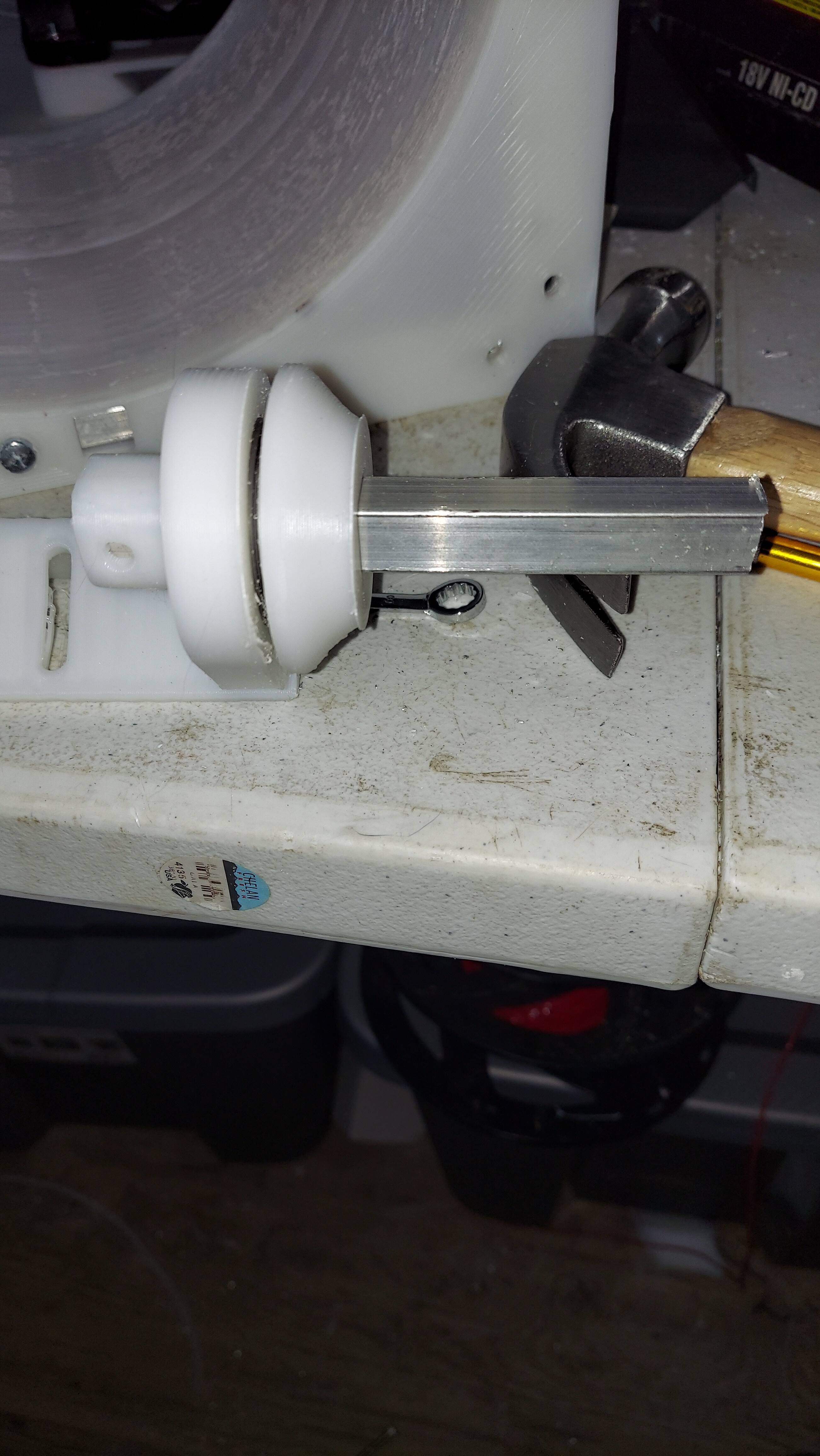

1/2 in square tubing will also be used as drive shafts. Plastic likes square better than hex
6805 bearings (25x37x8 (work quite well for that)

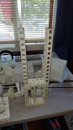

So all is based on a 26.7 x 26.7 cube with 14mm square hole and you can concatenate and combine them in cad to make pieces of your desire and complexity. In some cases a vertical mount is inserted to tie everything even together stronger
So you could say the plastic defines the location of the 1/2 in square tubes and guides the holes that mount the tubes together so the strength is a combination of the plastic and the steel or aluminum. The weight of the tube for steel is .39 lb/foot or about 0.15/ft for aluminum. The whole can be wrapped in epoxy soaked 10oz or so FG tape (or CF if you have the $$) up to 5mm thick if you want to. And the bumpers mount flush as this is intended to not have heads of fasteners stick out. so the plywood adds to the structural integrity and evenly distributes the hit over at least 6 in of the composite structure.

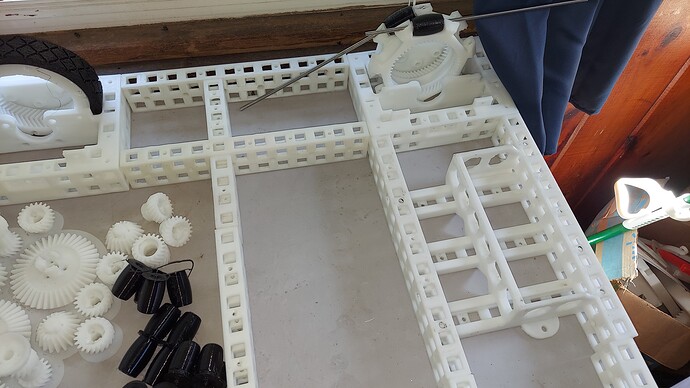

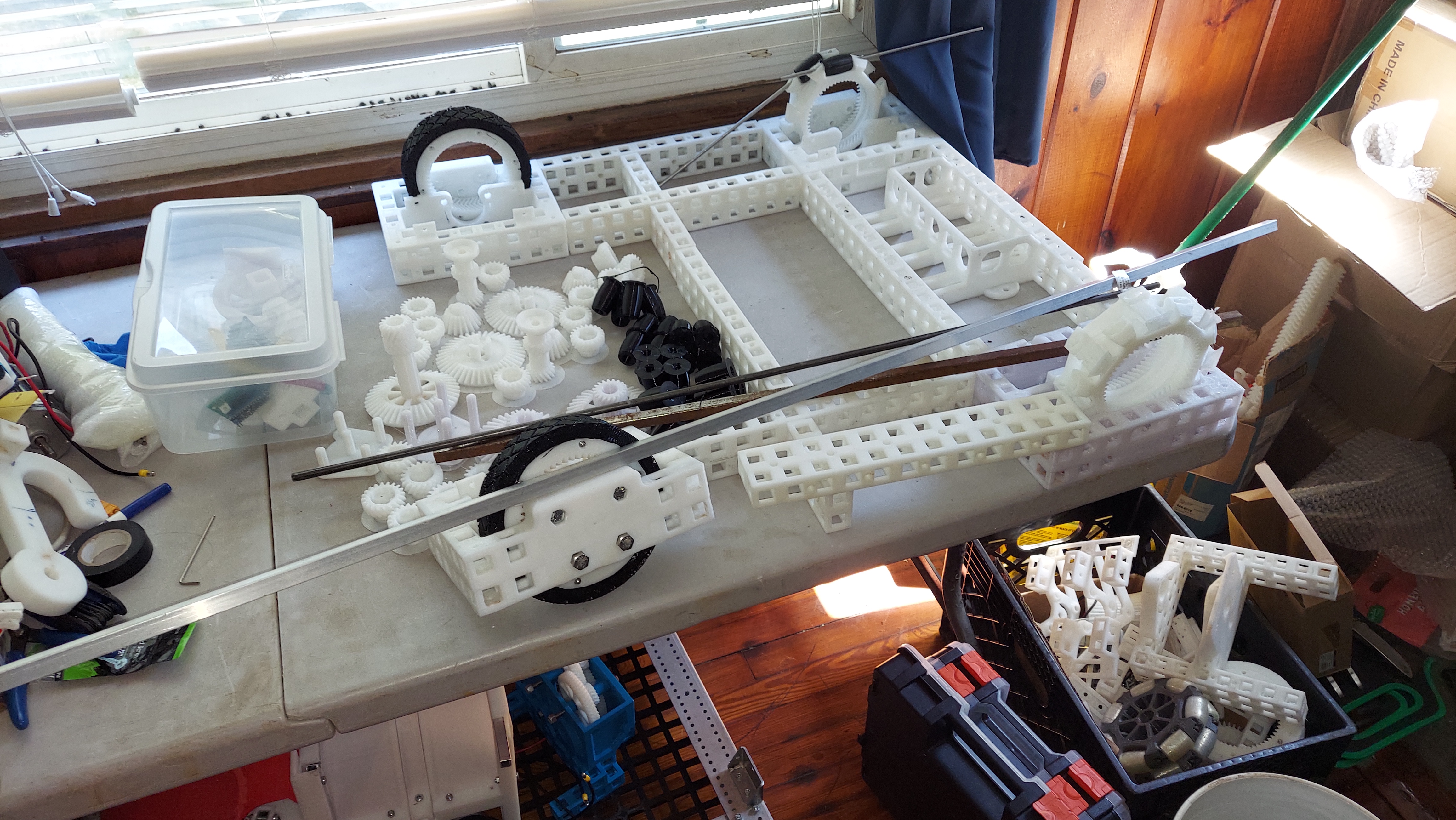

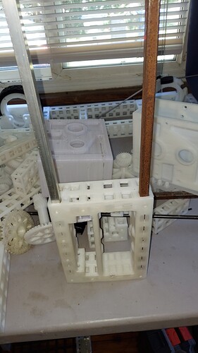

Starting Assembly and took some pic which hopefully make it clearer as to how the system of the composite frame workts

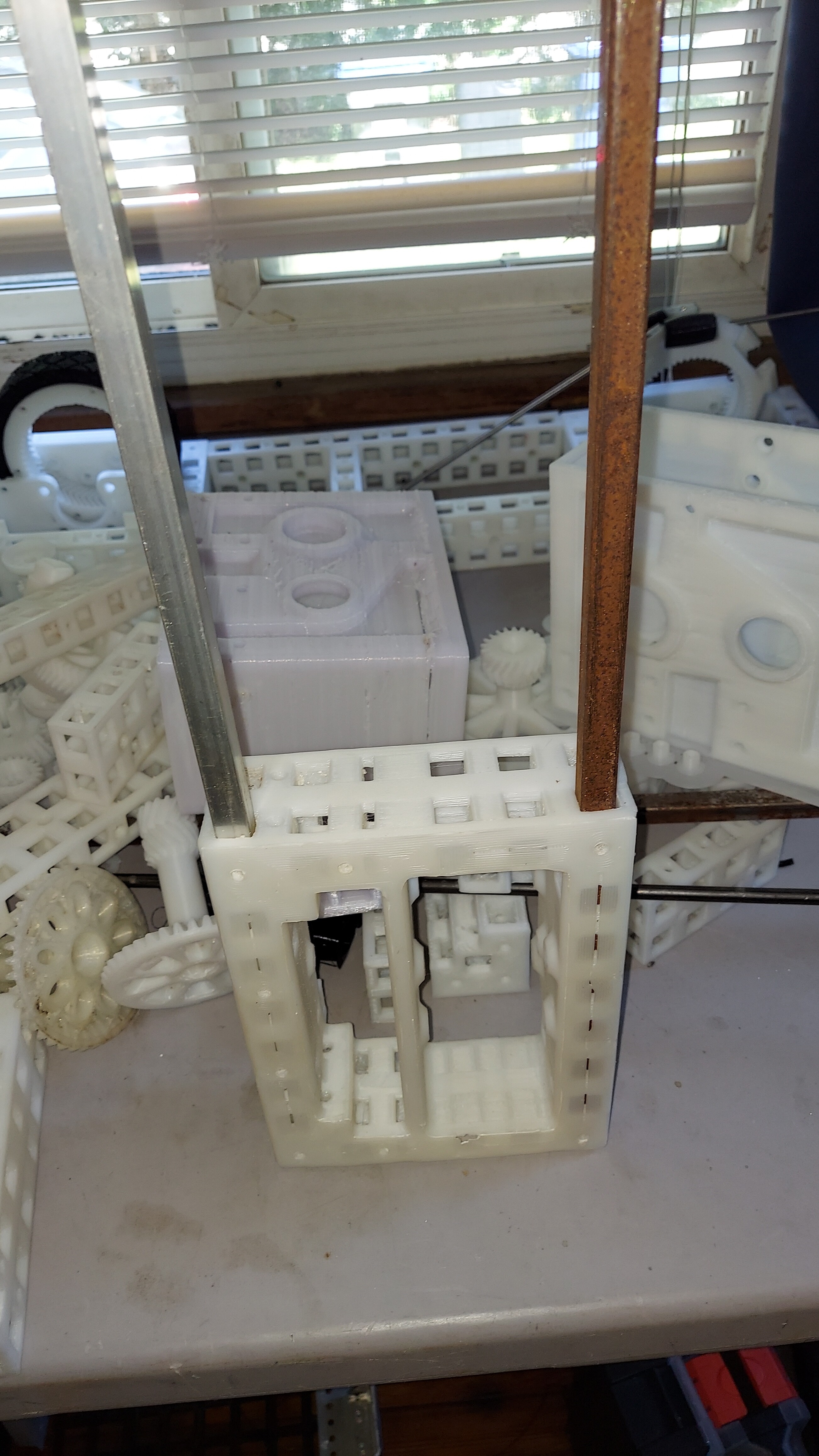

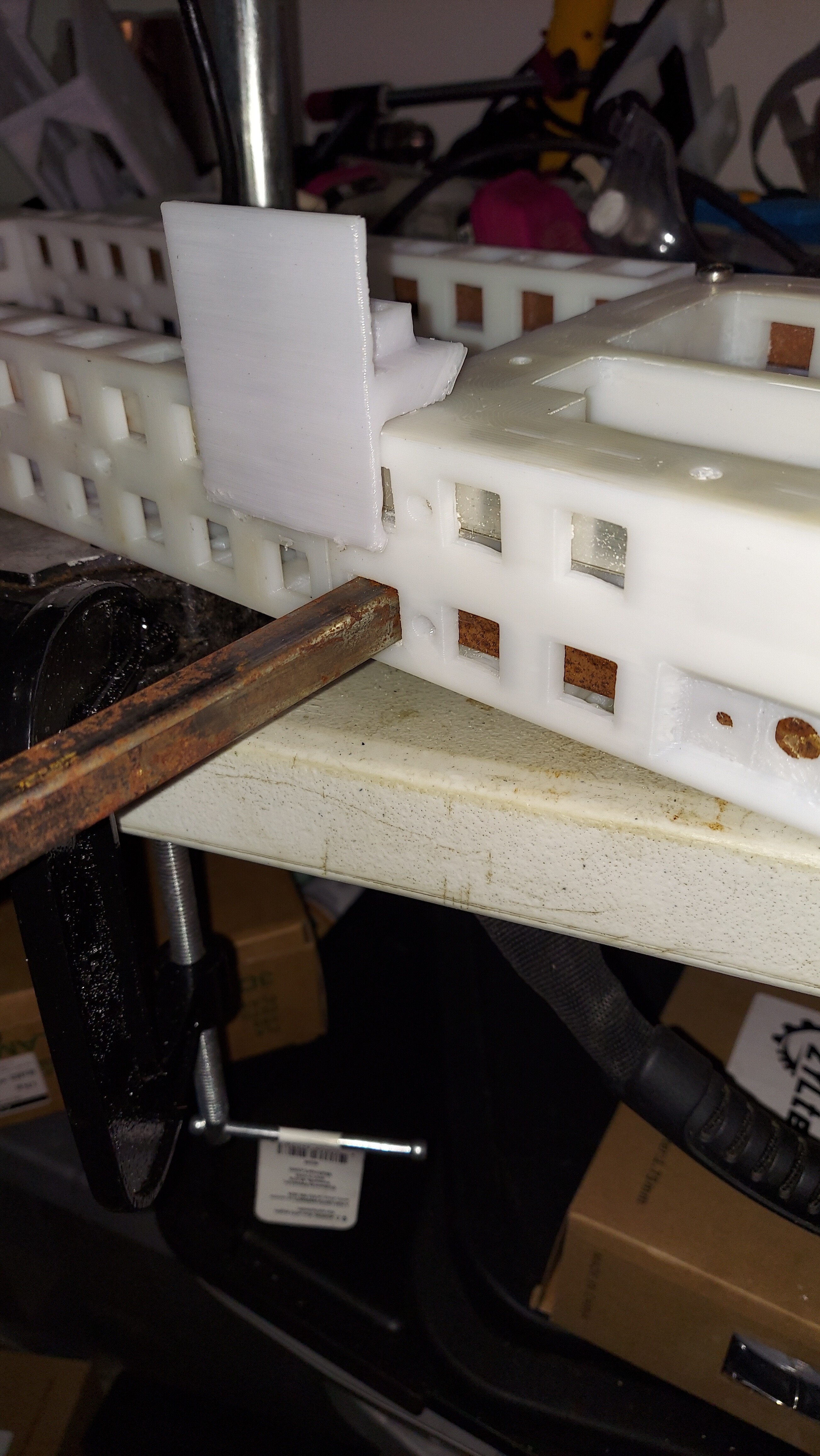

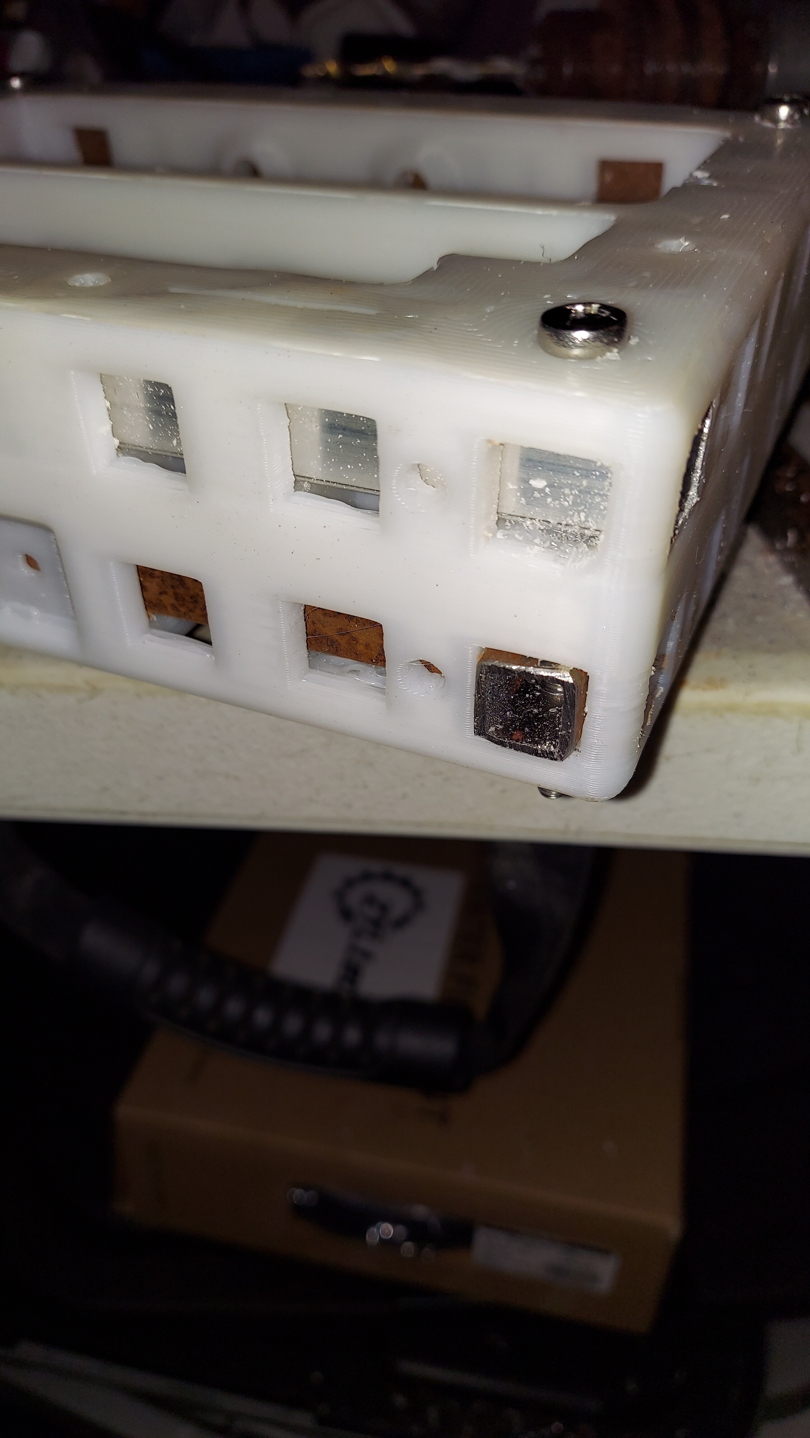

I decided to mix steel and aluminum so all reinforcements that face in a way that the support the bumpers or are the main cross beams I cut in steel 16 gauge 1/2 in square tubing mild (cheap) steel. the rest is/will be in aluminum also 16 gauge 1/2 in square.
So insert the steel/aluminum tubes in the printed pieces. The pieces are printed in a manner that no perimeter is less than 6mm
Here is the front with steel the outside steel the inside aluminum there is an M5 bolt visible to tie the square tubing and the plastic together
Here the view of one of the cross pieces mounted but this one will be naked across to allow the ball pickup to go low enough to properly (hopefully pick up the ball on top a 3DP tool helping me to line up the drill bit as atm I am down to 2 hand drills one cordless and one corded

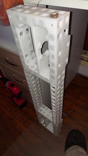

A view at the whole left side with one cross piece mounted. This will hold the 2 left wheels and motors and gears and the climber gearbox.

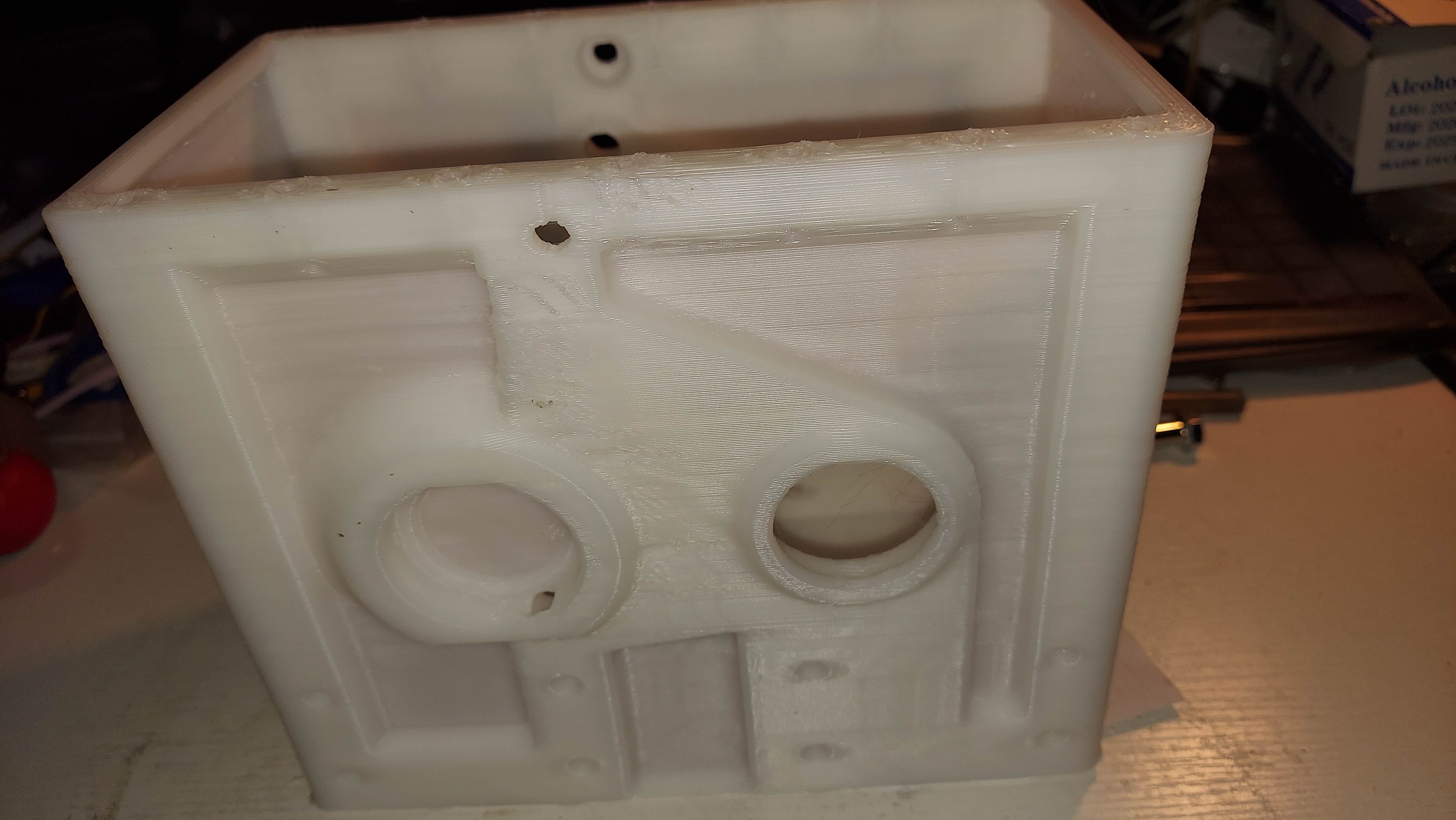

This is the housing for the climber gearbox 42:1 standard gears. The input will be just like the drive train with a 41:19 bevel gear stage on a 90 deg. That allows to leave more room for ball handling and electronics board and the climber mechanism inside the 6.5 in the rails above on each side take up.

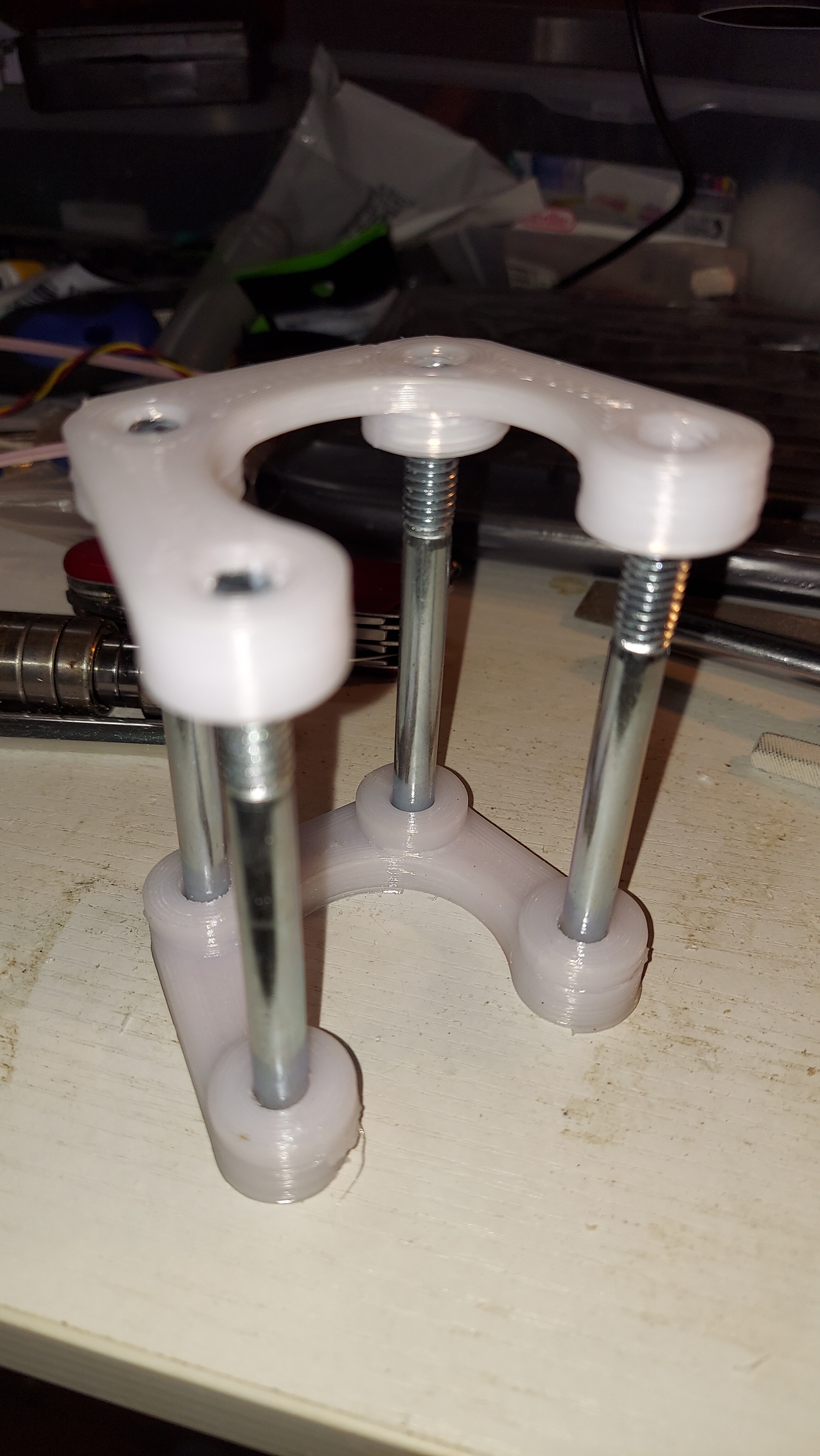

An alignment/assembly tool to help putting the planetaries that go inside the wheels together

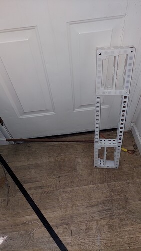

2 of the 4 hooks that will hopefully get the bot to the high and traverse rungs one with a slightly rusty square steel tube inserted.
