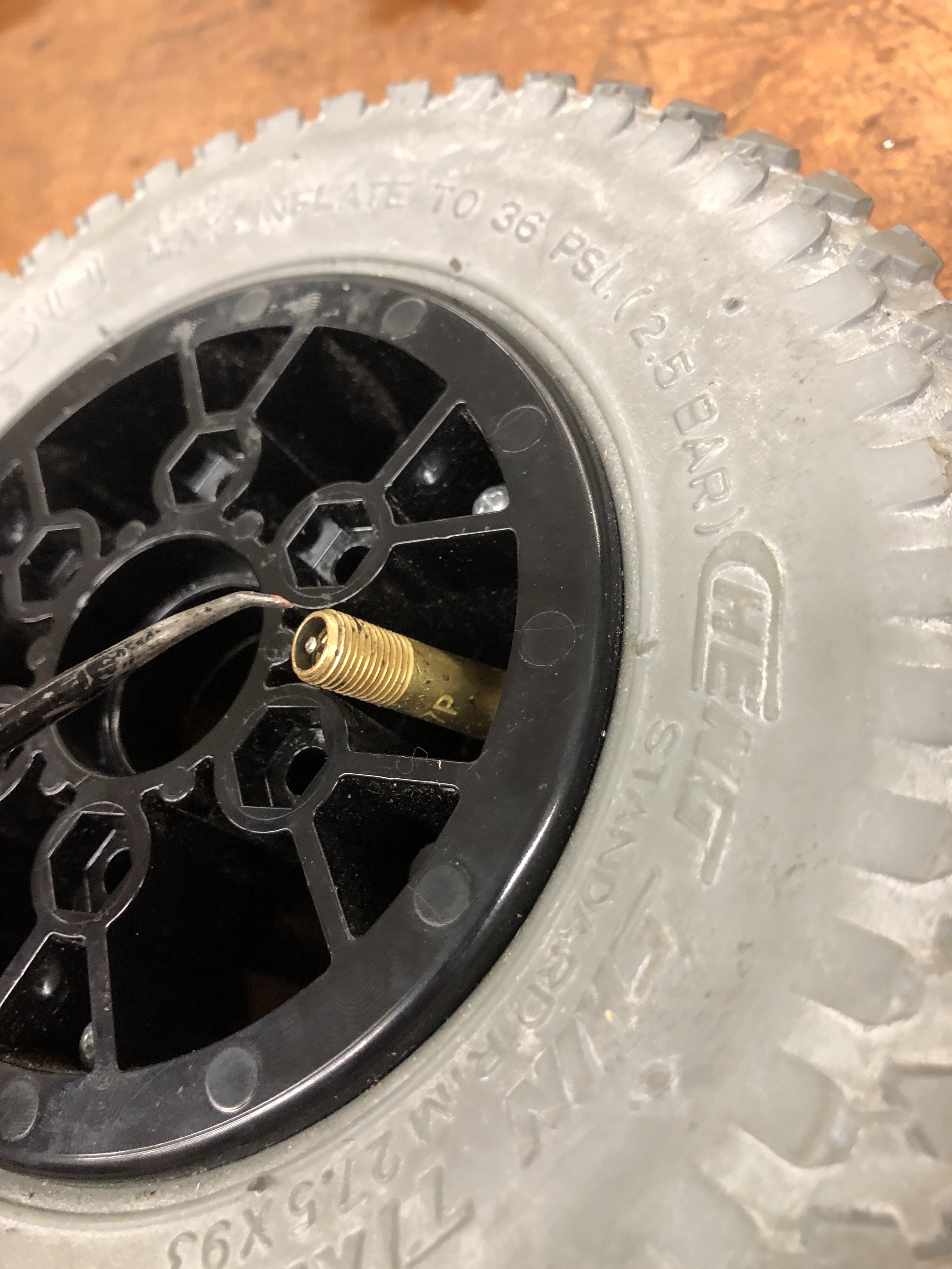

So we want to compress the pneumatic system before the match starts, we don’t want to use on board system eveytime. Anyway you see we could add one of those 1 way valves that are on tires to the system?
Someone else will be able to quote the exact rule but, you’re required to always use the compressor (and its attendant safety systems) to charge your pneumatics.
We figured out a way to not have an external one. But thanks for telling me. Could come in handy for future reference :slight_smile:
Please see R78 and R79
To add to what @EricLeifermann said:
You figured out a way to do it, but that way has been illegal since last year, per R78 requiring a compressor on the robot and R79 requiring all air come from said compressor (2020 version; 2019 had different rule numbers but the same function).
And I should give you fair warning: There are a number of inspectors on this forum. By now, any of them who have seen this post and happen to know inspectors at your events may have contacted said inspectors, who may be on the lookout. It’s happened before.
Glad you figured it out! The rule is probably around to stay for future years (it was hard to control the safety of off-board compressors), so this’ll open up good opportunities.
Edit: Eric, I keep rereading the sentence as I think one of us must have missed a negative, but I’m pretty sure it’s you? I’m still trying to reparse the phrase.
Which phrase?
As quoted, “We figured out a way to not have an external one.” (emphasis mine)
OH!
I think everybody was missing that. We thought OP was referring to no onboard compressor, which isn’t legal.
