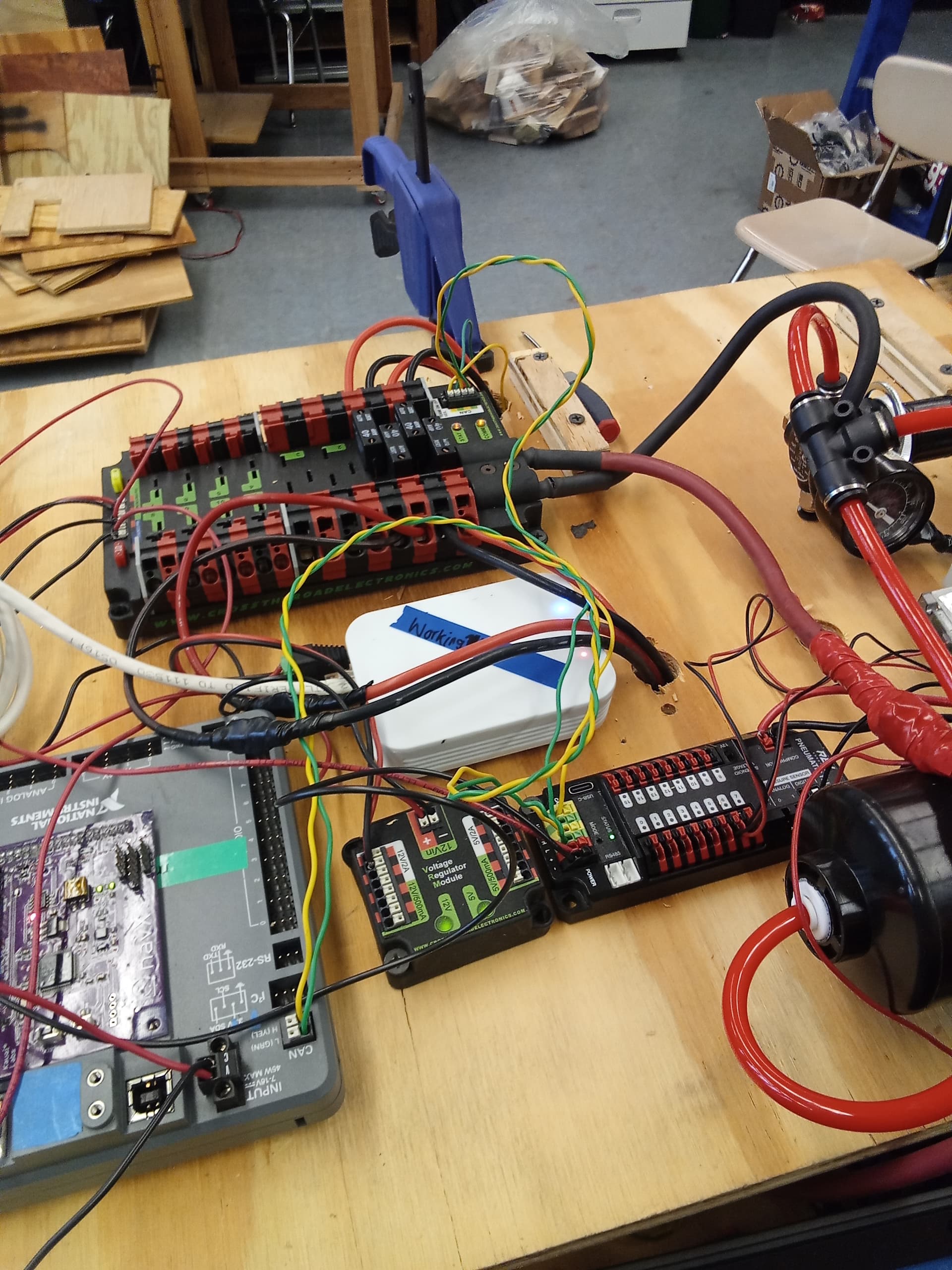

I’m not a very good electrician and I’ve never done pneumatics stuff. So I’ve uploaded some pictures of what our system looks like
I can upload more pictures if needed

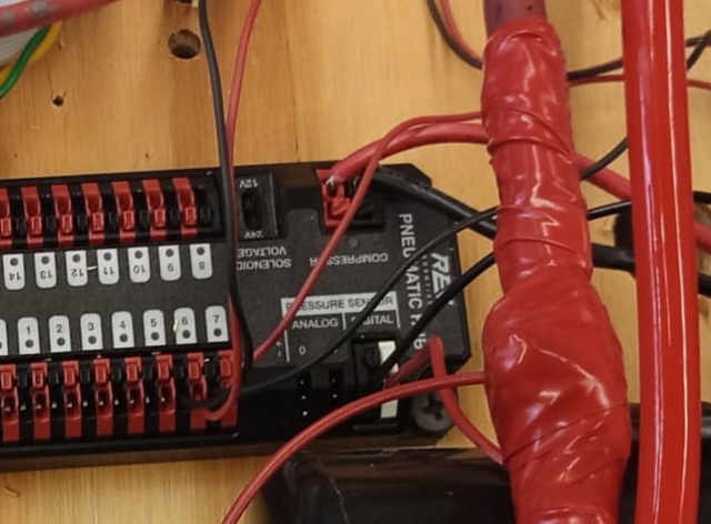

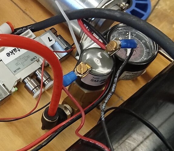

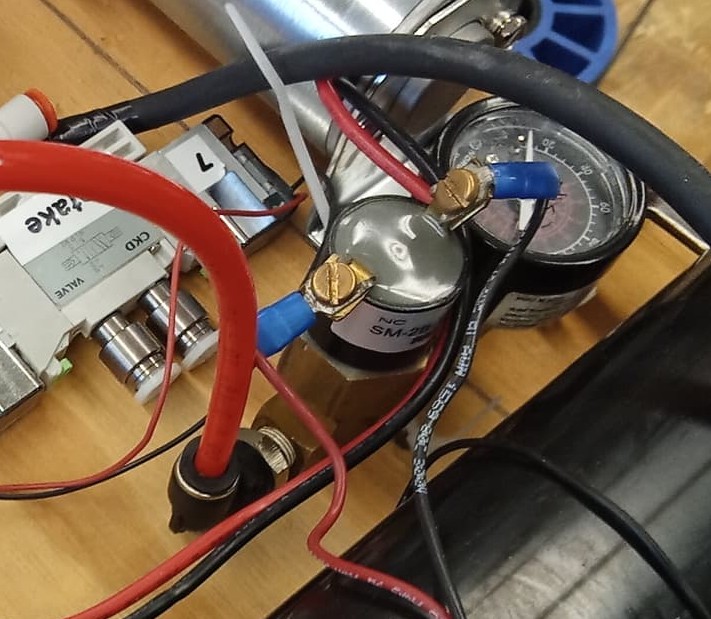

From the pictures it looks like there is a Digital switch wired into the system currently. It’s easier to see where it’s wired in the second picture. The switch itself is visible in the first picture.
IMG_20240124_125830
My next suggestion would be to short the contacts on the switch with a screwdriver contacting both posts on the switch to see if it turns on after that. Same as jumping it without the switch put in.

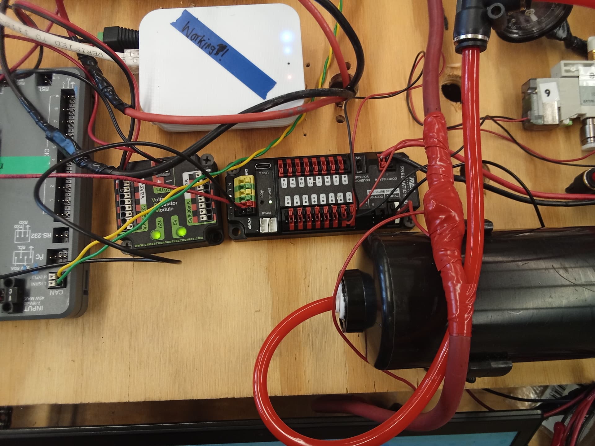

It looks like you don’t have your PH wired into the CAN bus, so it isn’t receiving signals!
Edit: refer here for details (section on CAN bus) - Wiring the Pneumatic Hub - ION Control System
We tried to wire the CAN, however I don’t think we’ve done this correctly, as we still cannot start the compressor
How are you terminating your CAN bus? it looks like you have something wired to it after the Power Distribution Panel. What position is the jumper on the PDP in?
