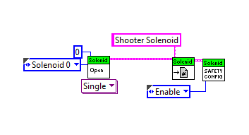

Are these Single Solenoids or Double Solenoids?

we got the PCM to enable and the compressor light was green. we also got these errors
ERROR 91 Variant To Data in WPI_SolenoidRefNum Registry Get.vi->Teleop.vi->Robot Main.viLabVIEW: The data type of the variant is not compatible with the data type wired to the type input.
ERROR -44007 FRC: The RefNum you are trying to Get does not exist in this RefNum Registry. WPI_SolenoidRefNum Registry Get.vi
ERROR -44007 FRC: The RefNum you are trying to Get does not exist in this RefNum Registry. Teleop.vi
images of the program
Alright, to solve the **-44007 **errors, make sure that your using the same refnum registry name in begin, Teleop and finish. In begin and finish you have Shooter Solenoid, but in Teleop you have Shooteer Solenoid.
To solve the 91 error, in the begin vi, set the solenoid to a double instead of a single solenoid from the drop down menu. Next, set the forward and reverse channels that the solenoid is wired to. After that, in the teleop.vi, change the On to a Forward and the Off to Reverse. I also attached a revised select function to drag and drop into the teleop.vi if you would like to do it that way.

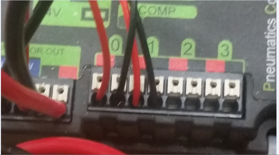

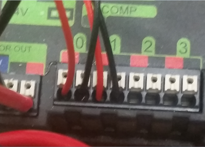

That will fix both of those errors. Also, do you have a picture of how this solenoid is wired?
We got the piston working, thank you by the way for that! Next question is will the air compressor shut down automatically?
Now here is the picture you asked for earlier.
Your Welcome and thank you for the picture. Everything appears to be wired correctly, so the compressor will shut off automatically once the pressure switch reaches ~120 PSI.
