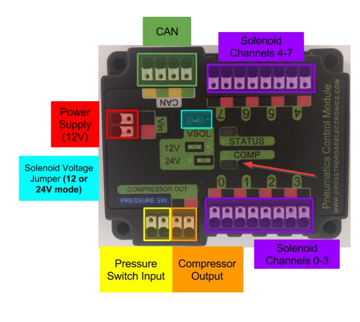

Just take one piece of wire, strip both ends, and insert each end into each port of the pressure switch. This simulates the switch reading < 120psi so it should start compressor.
by eahc port of the pressure switch do you mean the ports on the pressure switch it self or the ones it connects to on the pcm? we did it to where the wires connect to the pressure switch and nothing happened.
The ones in the pcm itself

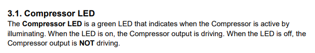

OP, what is the state of the Compressor LED?
From the manual:
If it is green, it implies bad wiring between the PCM and the compressor itself, or the compressor itself has failed. If it is dark, the problem lies elsewhere.
Note the compressor pressure switch switch wiring is designed for safety - if unplugged or not wired, the PCM assumes top-pressure has been reached, and will not attempt to enable the compressor.

No compressor light means it’s either the pressure switch or wiring to it, or code.
To rule out the pressure switch and it’s wiring, you can short the 2 pressure switch pins on the PCM (just don’t bend them). If the light turns on, it’s the wiring or switch. You can repeat the process by shorting the screw terminals on the switch together (after plugging the wires back into the PCM). If it works there, it’s the switch. Alternatively, you can check resistance/continuity end-to-end on the switch wires.
