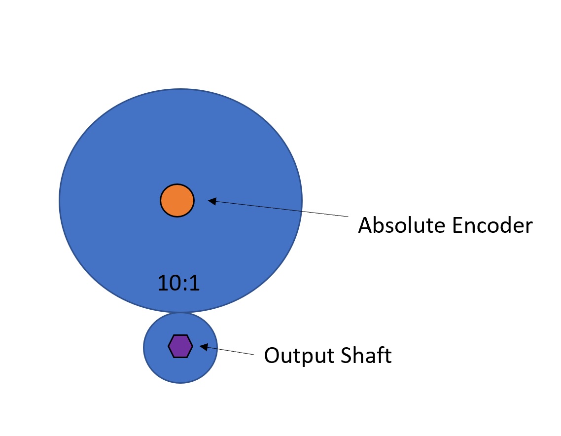

What I’m saying is, you need a way to map 1 full rotation of encoder, to the full length of travel of your mechanism. For example, say you are running an elevator that drives a sprocket/chain and it takes 10 rotations of that sprocket to lift the elevator the full distance.
On that same output shaft, you can add a gear, then a second gear with a 10:1 reduction, such that the larger gear has 1 full rotation for the elevator’s range of motion. The gears are “locked” together, so you always know how many rotations of the output shaft equate to a position in the 360-degree circle of the larger gear.
Made a very quick/crude drawing to explain:
Ohhh I see, so the absolute encoder goes on the output gear/gearbox rather than the motor itself?
Yep! This is generally a better way to get positive confirmation of your mechanism’s actual position anyway. If your chain/belt were to skip, the motor doesn’t have any knowledge of that and will run the mechanism to the wrong position. In general, the best place to put an encoder is where it can directly measure a mechanism’s position (if possible)

Putting the encoder on the output also helps with backlash. Also, since the magnet is indicating absolute position, it needs to be aligned, to set the zero position.
Because the magnet normally doesn’t have any visual indication where the North and South poles are located and, even if it did, the resolution is high enough that is would be very hard to precisely align it, there is normally an offset that has to be applied in order to adjust where the zero position is located. Often, any time a mechanism is reassembled, this will need to be reset. This is because things like gear mesh change. But, if the encoder is directly mounted to the output shaft, this last issue is often eliminated.
