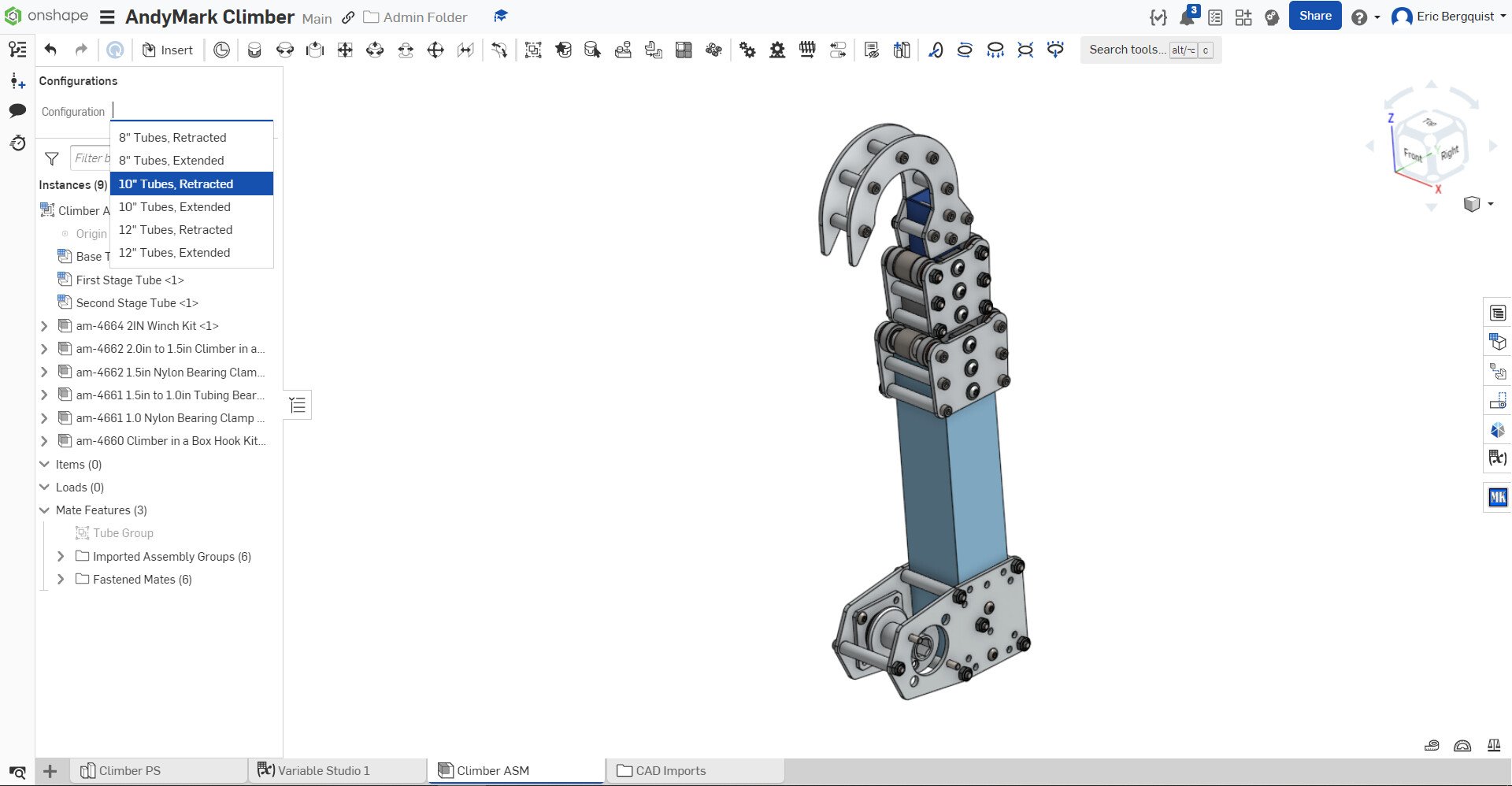

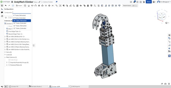

Side note: though I’ve made the configurable climber we need for right now, I’ve already run into the annoying restriction that in Onshape, assembly-level configuration variables can’t be applied directly to part studio features. This makes for unnecessarily bloated assembly configuration choices where you have to have an independent dropdown item for each value, and duplicate items if dropdown items share the variable but differ in another feature. See the pic below for an example.
Ideally, the configuration for this assembly would have two fields: a variable for tube length and a dropdown for extended or retracted (bonus points if you want to add a % extension variable instead). If anyone knows how to get that functionality, please let me know.

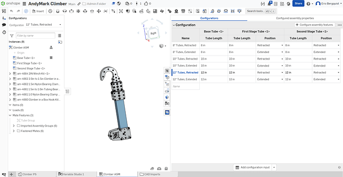

FYI, here is our current document. V2 should have all the tube holes in the right place and extension and retraction limits that match the AndyMark step file. I reversed the direction of the hook for internal design reasons. To create custom lengths in the assembly configuration, duplicate the current configurations and change the length entries to all be the same tube length that you want (see image below). This model is still using the imported step files for all the parts that aren’t the configurable tubes, so it will render slower than a native Onshape document.

You can have a variable in your assembly drive a configuration value of your parts, which should do the trick. With this, you should be able to create a configuration variable in the assembly for the tube length that you can do some math and also use in a distance mate limit to set the maximum extension.

Good call, the thing I was missing was that assembly configuration inputs can reference assembly configuration variables, which can then be passed to part studio configuration variable. So all I needed was for one of the configuration inputs to also have columns for every part that needed a tube length reference (See below). Still feels clunky because I have to have two configuration variables (tubeLengthPS and tubeLengthASM) and have to pass the assembly variable to the part studio variable for each part, but the functionality is there. V3 has these changes if anyone want to copy the doc for their own uses.
