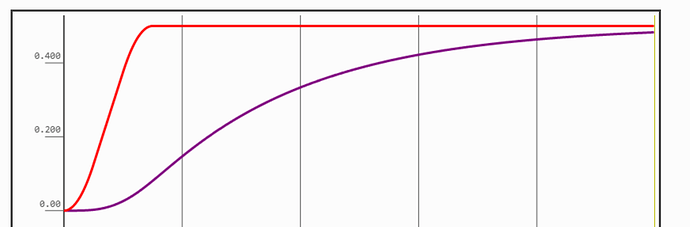

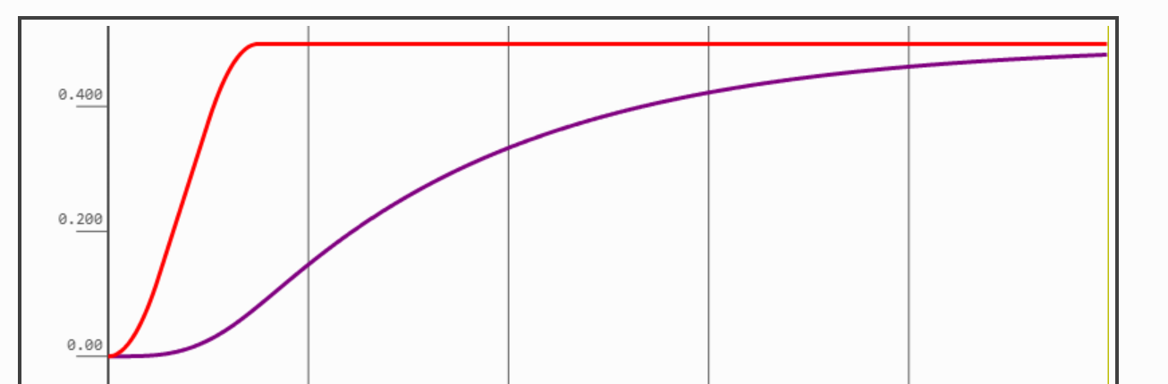

Hello, my team is using feedforward to make the elevator position more precise, but we are unsure about the configuration of kv and ka. According to the WPILib documentation, it is possible to configure these values using a graph, but we are looking for a faster way to make these changes. Is there a formula to determine these values? If so, how can we do that? We are using 2 NEO motors and a continuous belt elevator.
