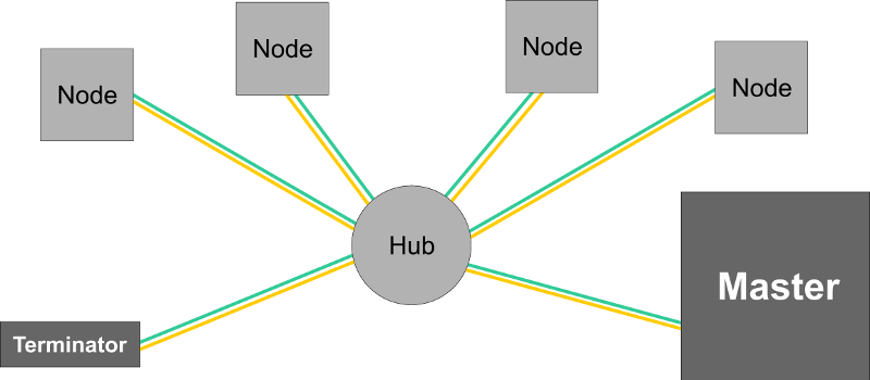

our problem is one of our canbus wires has disconnected from its base inside the motor, so we currently don’t know what to do
Your best bet is probably to contact CTRE and see what they say. Otherwise, you’re likely down a motor.
If you have one green wire and one yellow that are good, you should stillbe able to use it.
i sent them a mail and waiting for them to answer
how?
CAN is a chain, so while it does come originally with two seperate pigtails, both yellow wires and both green wires go back to the same contact points internally. You could add a Y connector onto the remaining yellow and green wires and treat it like you would the original seperate wires. The TalonFX wouldn’t know the difference.
Edit: for more information as well you could do a Star Topology if all of them only had a single pair and it would still work. A star also would still function even if one node was missing or faulty. The default way many teams wire their CAN bus is device to device. If one part of that chain fails it all fails. Of course you’d need a hub for this.
Mindsensors has a good topology guide
