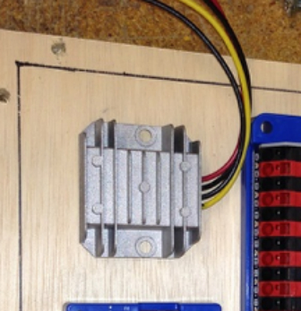

I always recommend teams only use their VRM to power the radio, and put any other devices on a separate buck-boost converter. All ports on the VRM go through a single non-resetting fuse in the PDP. If you should have a short or over-current in another device on the VRM it can blow that fuse and you’ll be dead for the rest of the match. That’s far too high a risk in my book. You can get voltage converters for reasonably cheap (I’ve been recommending something like this one), and they can handle much more current than the VRM at a wide range of voltages.
If you still have some old pre 2014 robot parts the 12V to 5V converter that used to come in the KOP for the radio power works well.
One the red and black set of wires is the 12V in that needs to plug into the PDP. They black and yellow are a 5V out that can go into the LED’s. Then you will need to hook up the signal line of the LED to at PWM port in the Rio.
If you do not have the old KOP voltage converter something similar can be purchased on amazon

That is what I am using it is rated 25W 5V output.
