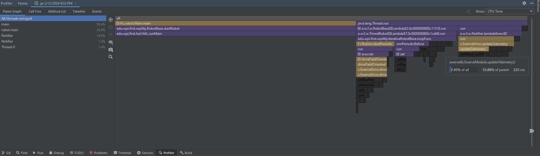

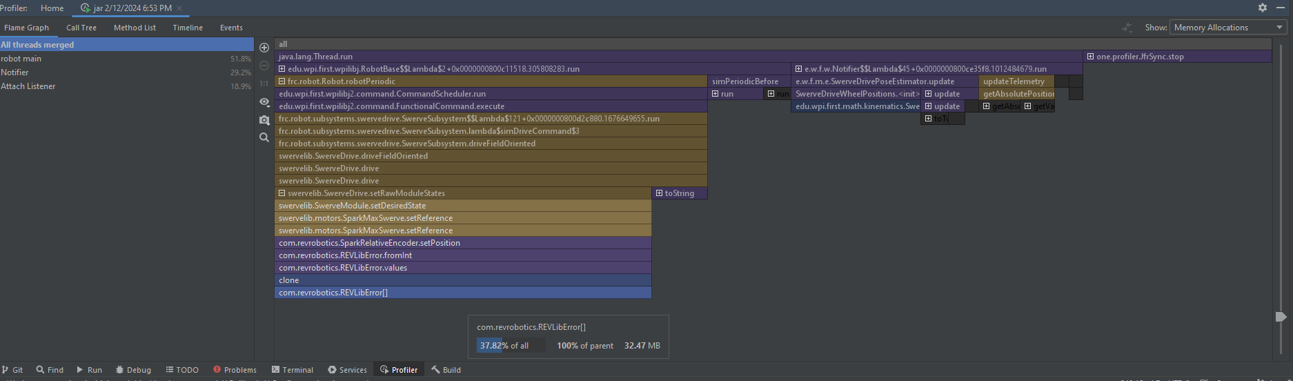

I used the InteliJ profiler for simulation and found it to work well enough. Even found a memory consumption issue with REVLib in it.
You can also use VisualVM if you want to profile CPU usage. Idk if it does memory well.
In their library? Or your code? If the library, has it been fixed? We use Rev controllers for our swerve drive. And its when I turn these on that I get pushed over the edge on memory.

It’s in their library. It originates from REVLibError.fromInt which is called from every setReference and setVoltage call among others. You can read about it here
