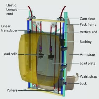

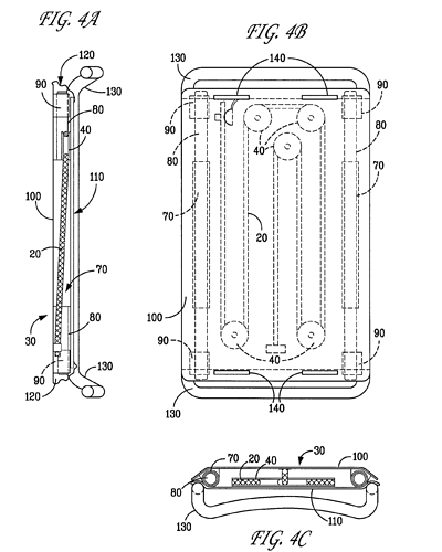

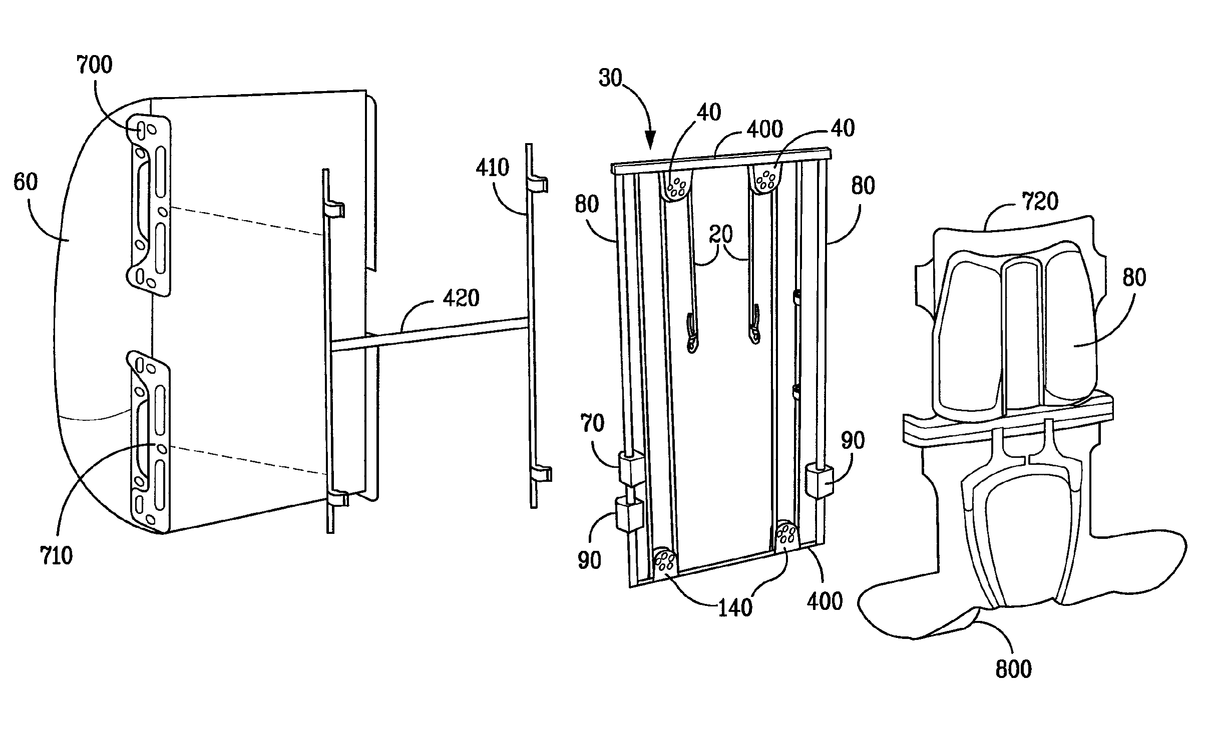

The window counterbalance springs are a good idea. Going off of the rubber band comment, you could use surgical tubing or bungee cords. If you need more stretch length than a short piece of surgical tubing can provide you could run a longer piece through a series of pulleys and tie it off at the end. I have seen this done on a fancy backpack. US7931178B2 - Suspended load ergonomic backpack - Google Patents
