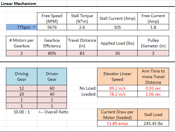

For calculating the optimal gear ratio, I plan on using the JVN Calculator’s Linear Mechanism tab. Please let me know if this is meant for elevators or not.
The following is a screenshot from 254’s 2018 build blog. Should I aim for similar speeds, or is this showing climbing speed instead of their normal speed?

The speeds in the screenshot make me think that that is the speed during normal operations (not climbing). The reason I believe this is that ~1 second travel time from one end to the other is something to aim for. It is quick, but elevator travel speed is very important for quick cycles in 2018 and 2019. As for your other questions, I’ll defer to someone more knowledgeable. However, I do think that 2 NEOs would be a strong replacement for 4 775-pros.
I think you’re seriously overpowering this elevator. We ran our 2019 elevator (also constructed of 80/20 extrusion) that was lifting a similar load and used only one 775pro in a 25:1 gearbox. Our time from rest to tier three on the rocket was about 1.1 seconds using Andymark wheel hubs for the cable spools. Four 775pros is manically overpowered, as the stall load in your calculations will tell you. 478 lbs is almost 16x the load you’re actually lifting (you put the load in at 30 lbs). One 775pro (or one Neo) is more than enough to do the job. The only reason to put four 775pros on a winch is if you’re lifting your entire robot with it.

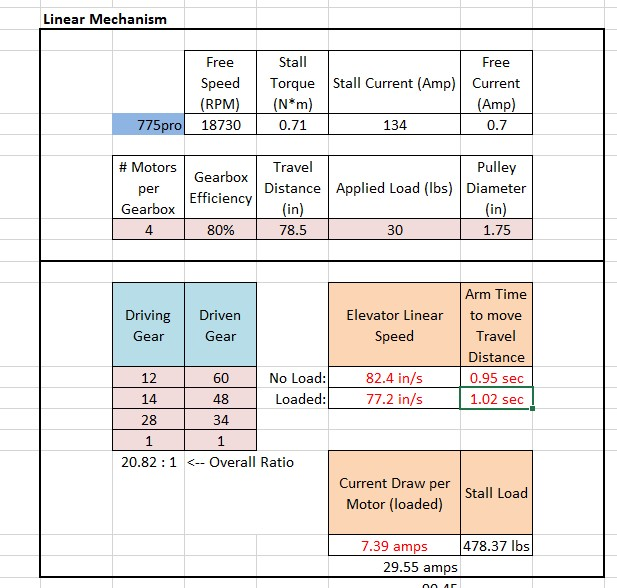

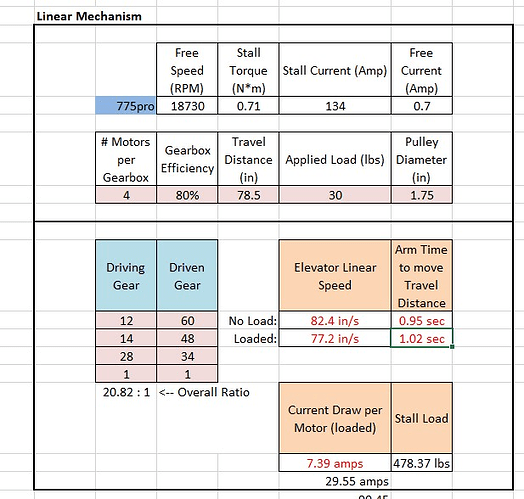

Thank you for your advice. Does this look alright? I might change the gears around depending on the gearbox geometry. It says 775 pro but the specs are for two Neos. The gear ratio is low because of the large pulley diameter (I designed a helical pulley). I don’t care about climbing and I want it to be fast.

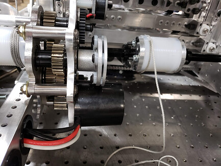

I would appreciate it if someone would explain the advantages of having a 2 speed gearbox on an elevator other than the ability to climb.
Disclaimer: I have not been on a team that has built an elevator with a 2 speed gearbox while I was a member of the team, this is just my speculation
That said, having a 2 speed gearbox would make it a lot easier to justify not having a brake on the elevator. If the elevator needs to be held in the air for a decent amount of time, having a high gear to get it there and a low gear to minimize current draw to hold it there could be beneficial.
I don’t think a 2 speed gearbox is necessary for an elevator unless you intend to climb with it, and even when you do intend to climb with it sometimes you don’t need a 2 speed gearbox.

The original gearing looks fine to me, based on the duty cycle. We ran similar numbers in 2019 to account for a healthy factor of safety and climbing. Dual falcon or neo is likely an improvement that saves motor slots without sacrificing performance.
We ran dual 775 redlines at 5:1 ratio and a 1.25" diameter spool (Pulley Diameter) initially on our 2019 elevator and the motors got dangerously hot after only a few minutes of practice. We changed the ratio to 25:1 (still with 2 motors) and it ran fine for the entire season (except for one time in practice when the lower limit in the code got re-set and the motors were stalled for 30 seconds or so against the lower stop of the elevator). It still had plenty of speed.
I would be a little dubious about 10:1 with 775s, especially with a 3" pulley diameter. That seems like a lot of load, especially if you are going to be using the motors at stall to hold the elevator. But, I think you are saying that the calculations are actually for NEOs and not 775s? In that case, you should be fine with that ratio.
Gear ratio and pulley diameter are important, but ultimately the loaded current draw is the most important. The loaded current draw is only 7.4A in the first image, which is a fairly low heat output (maybe 5W per motor). Even if the current draw ends up being double what you expect, that’s still only about 20W of heat per motor, which can easily be handled with some 40mm case fans if needed.
Our 2019 elevator had 4 775s geared for a loaded current draw of about 6A, and due to large cantilevered loads and an aggressive duty cycle we saw a lot of heat, killing a few motors by champs. A better designed system or added cooling fans would have been a big improvement.
Going to NEOs or Falcons will cut the generated heat due to lower coil resistance, for the same output speed. That lets you use fewer motors. Falcons have about half the equivalent winding resistance as 775pros, and are more efficient with their torque to boot. Falcons also have built-in overheat protection which is awesome.

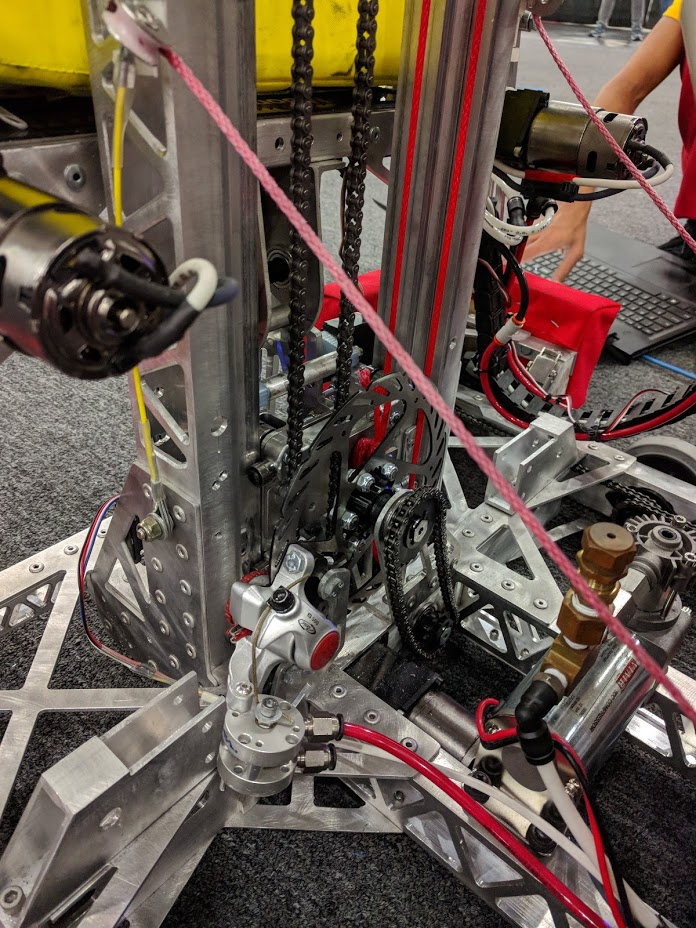

If you’re just lifting a “typical” elevator (IE: you aren’t buddy climbing with it like 254-2018), and you either have a brake or a counterbalance (or both), then you can get away with relatively little power. Sourcing from my experience:
Our 2018 elevator had a single 775 and a bike brake. It lifted fast enough that it wasn’t our scoring bottleneck, and the motor never needed replacement. (picture below, left)
Our 2019 elevator had a single NEO and a “971 brake.” It was lifting a pretty heavy elevator with no counterbalance. That motor was also able to lift the elevator in about a second, and never needed replacement. (picture below, right)
