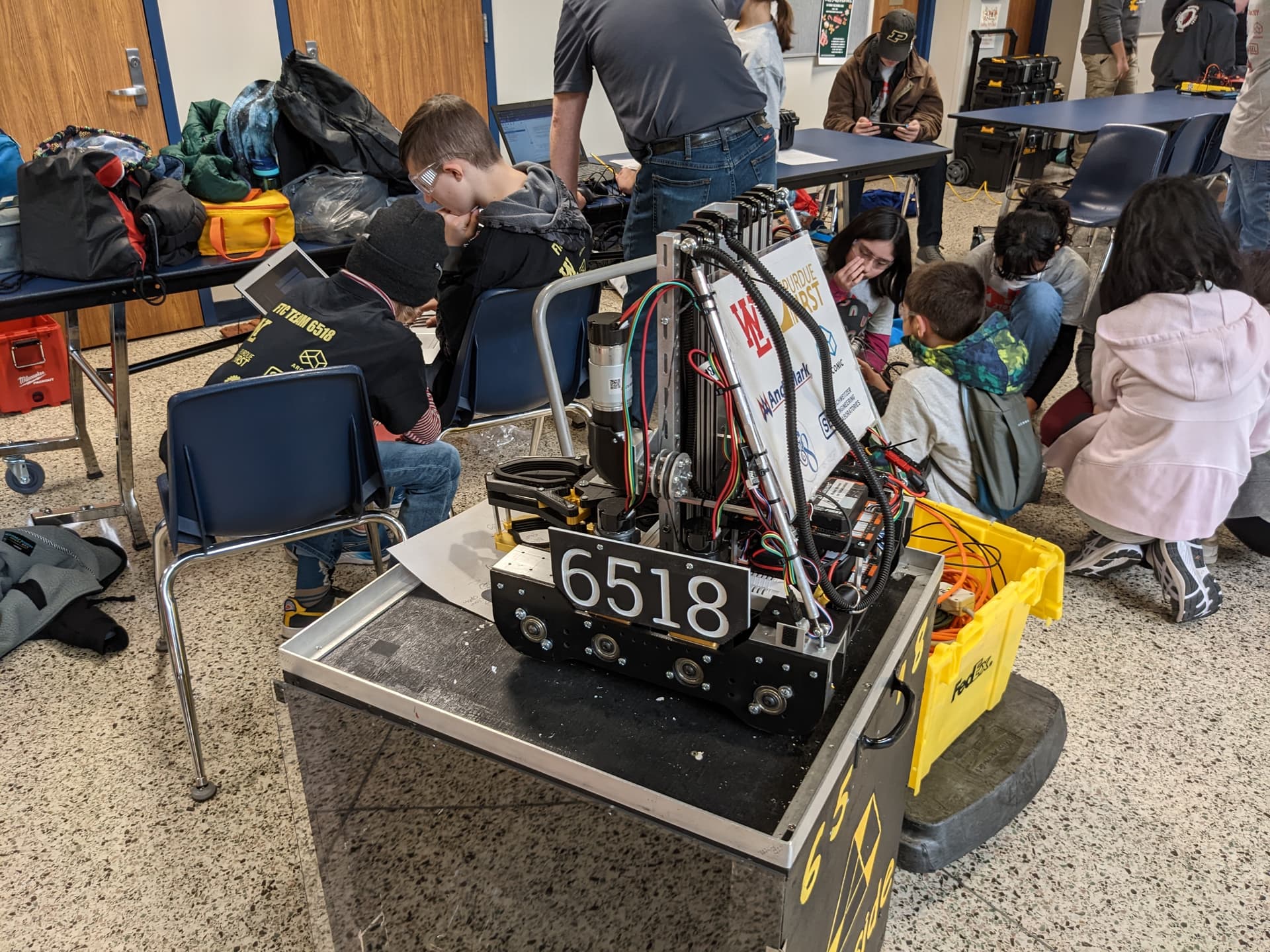

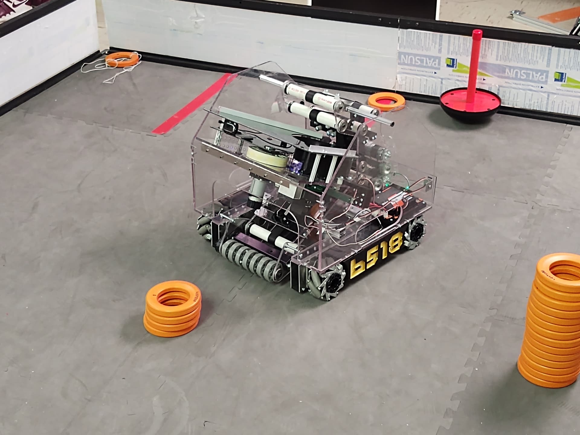

We first noticed this in Ultimate Goal season with the control hub simply no longer powering on. When we pulled it off it was warm but after leaving it alone for a few days it was able to power on without issue. We swapped in a new control hub anyway and mounted it to an aluminum plate just to make sure if it did get warm, the metal plate would help transfer the heat. This season, we had one overheat and fail to power on. We replaced it but the old unit still took a few days to power on again.
Ultimate Goal bot: Mounted flat to a piece of 1/4" polycarbonate and the bot was mostly enclosed like a big plastic box. Hub had 2 REV servos and a linear servo plugged in.
Power Play bot: Mounted flat to a 1/4" 3D printed plastic piece directly under another hub. Hub only had 1 REV servo plugged in.
