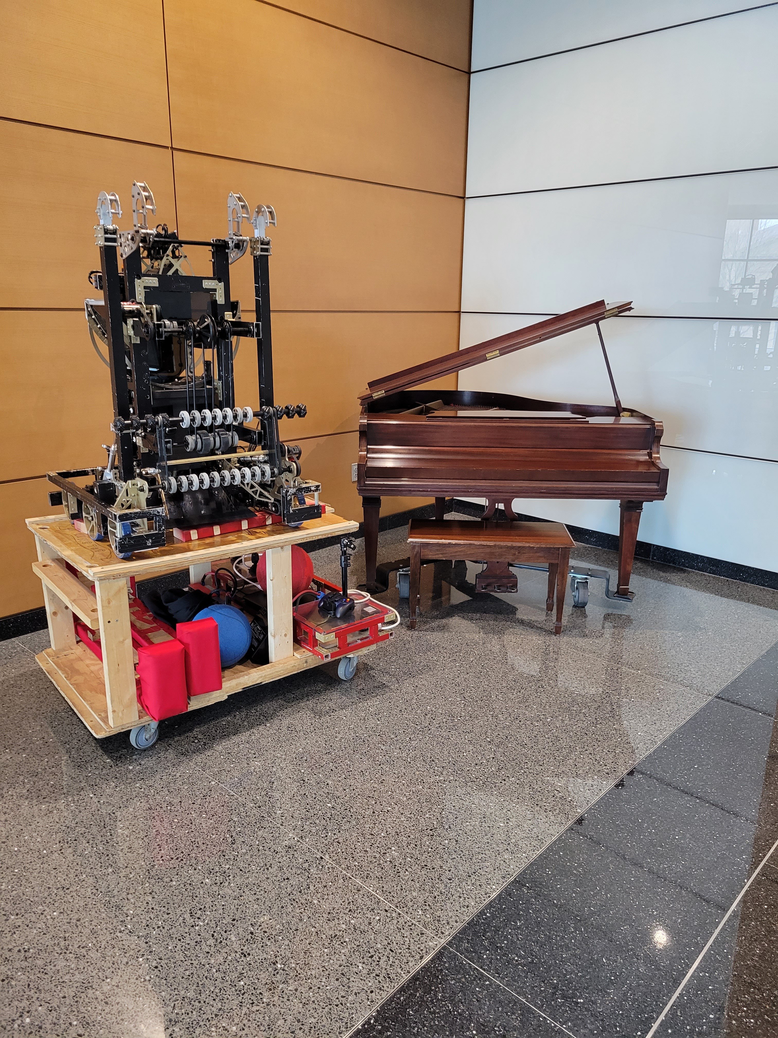

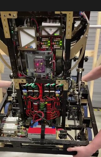

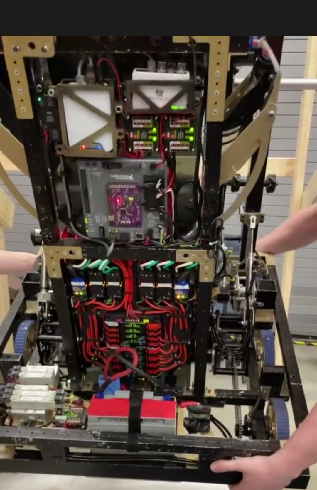

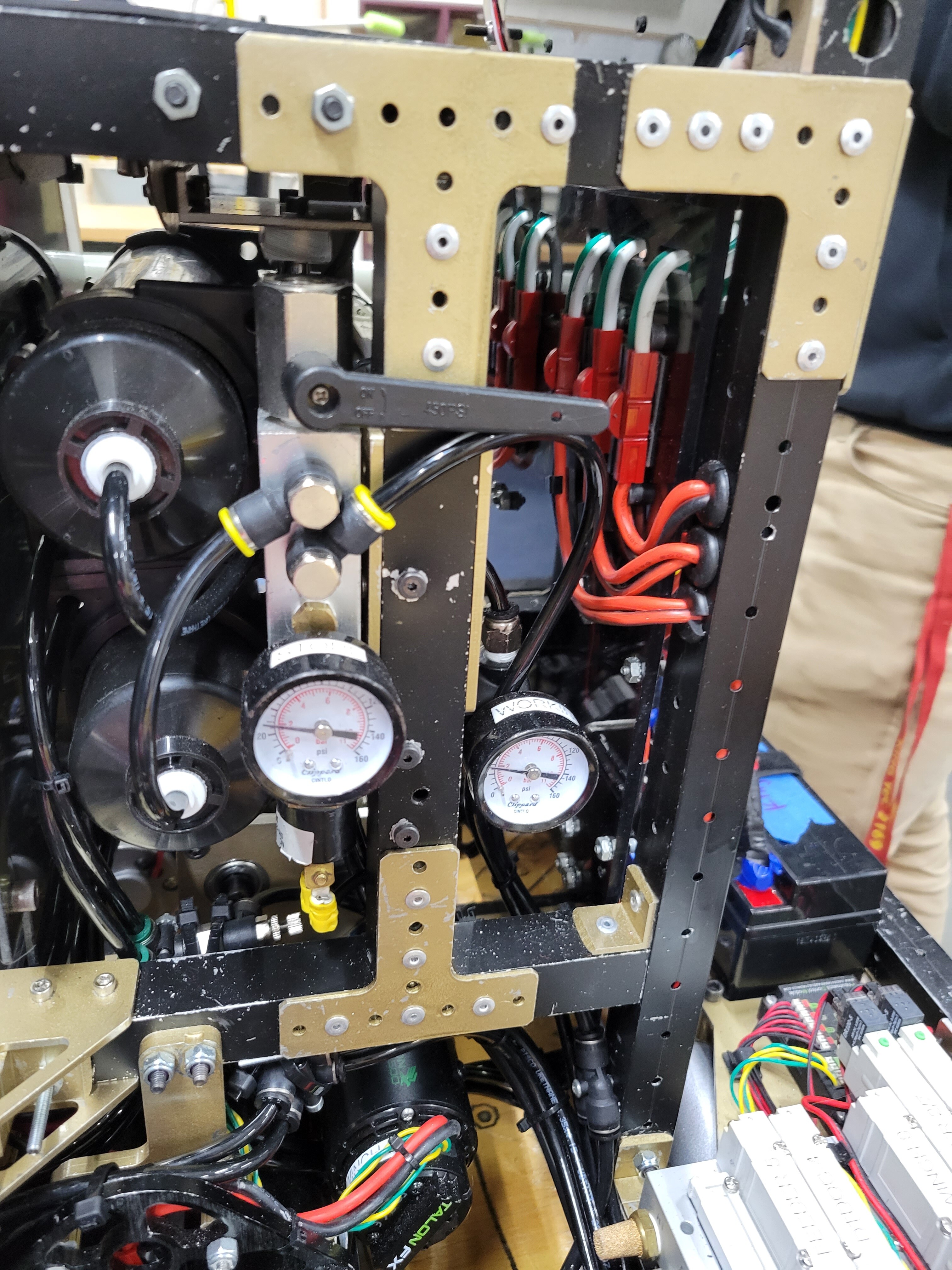

Hello my name is Jacob I am the head of electrical for team 2169. We had a pretty rough last couple of years COVID hit us pretty hard and we have had very few new members. Because of this I am the only member of my department. I decided that I was going to do everything in my power to win 2 control awards for our team one for each competition we attended. I was rather disheartend when we ended the season with 0 It was absolutely crushing. So I’m wondering what you think of our controll system and if you have any information about how the judging process works. Did I miss understand what the controll award is about?
Let me go over some of the things we did this season to try and win the controll award

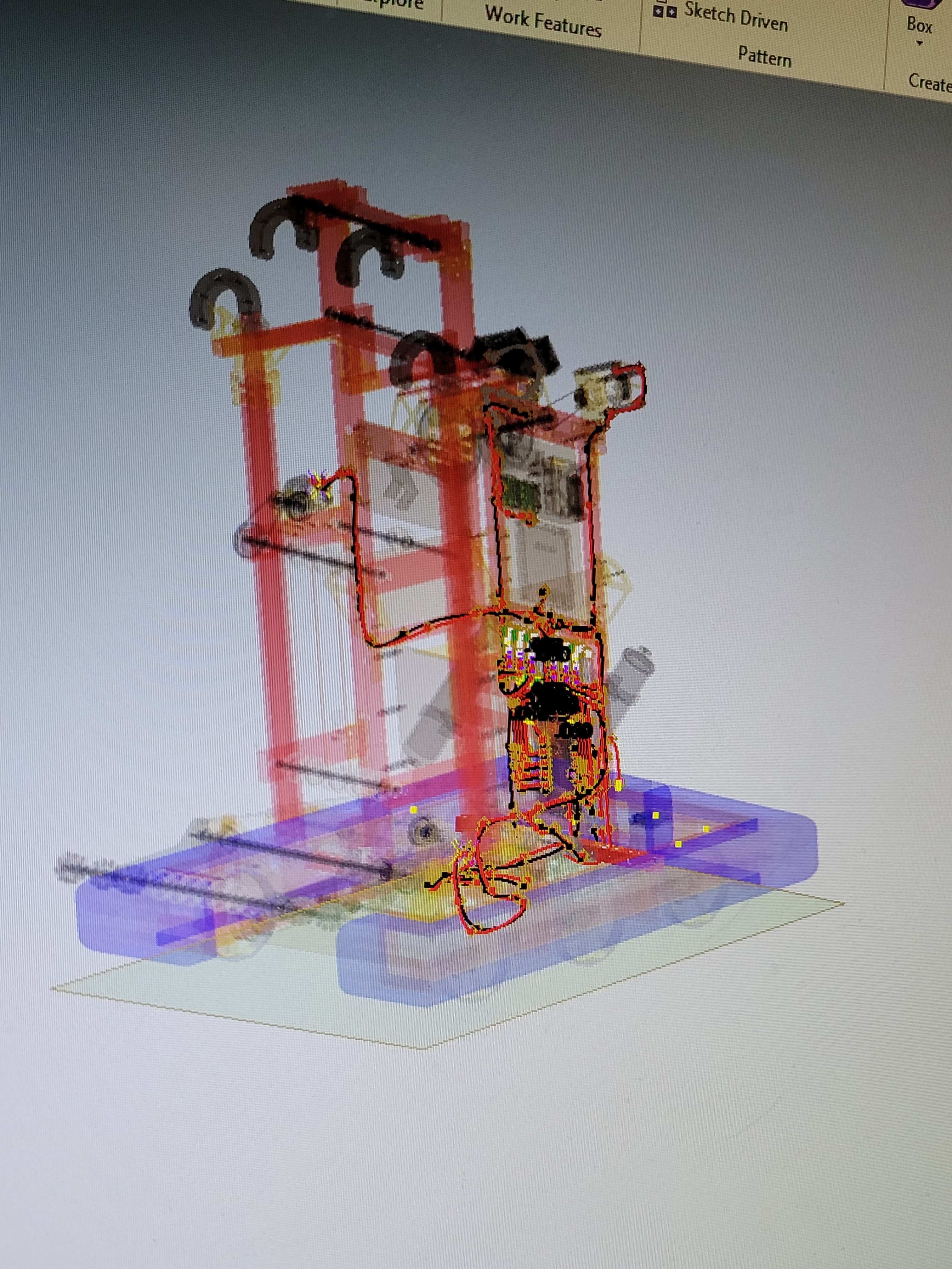

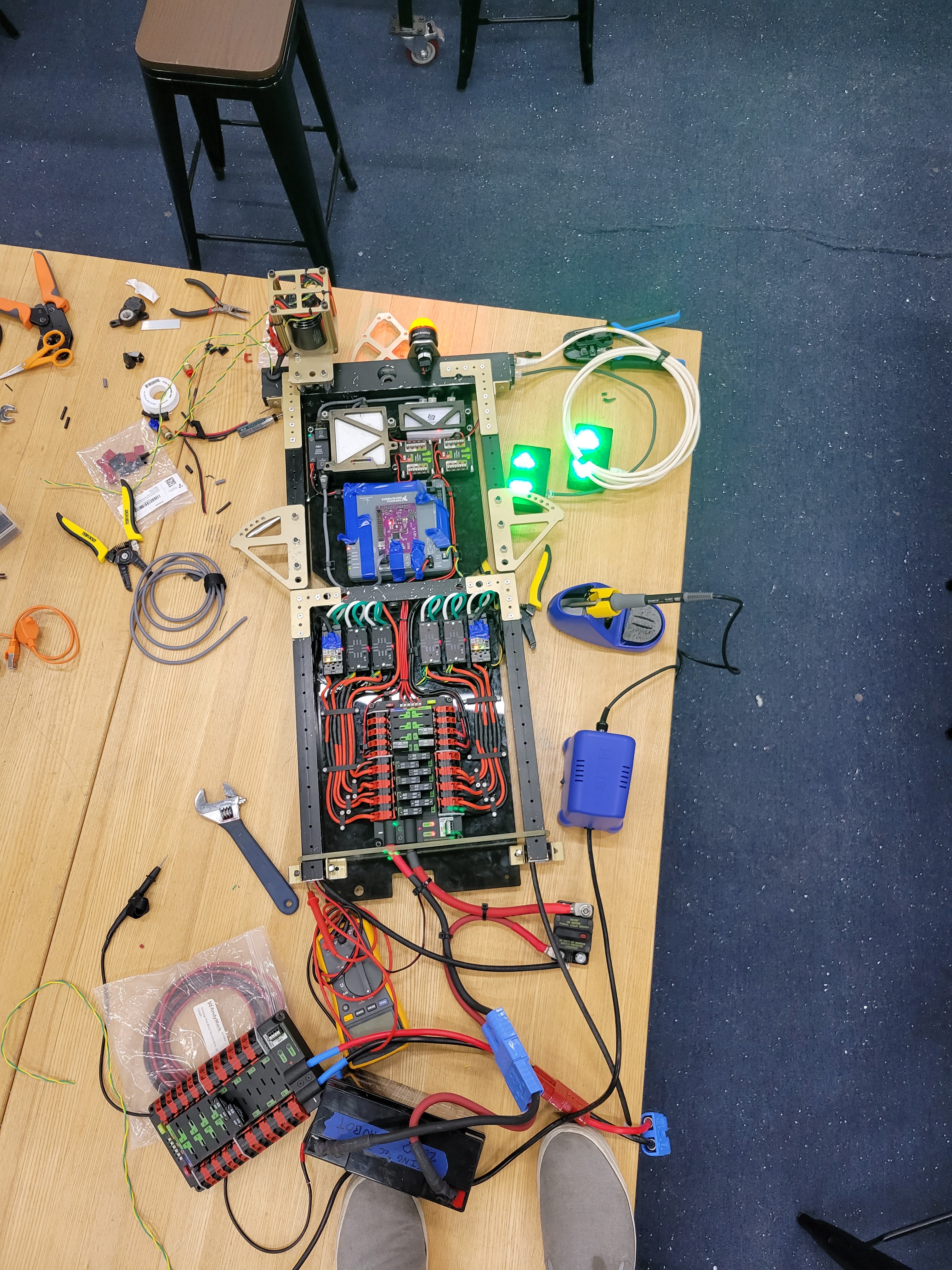

1. We made all of our wire runs in CAD and actually used them to improve the controll system. All of our wires were cut and crimped to there CAD lengths before the robot was built. We also printed custom wire guids based on the CAD and used the CAD to get an accurate weight estaminet. As far as I’ve seen online we are one of the only teams that have done this.
2. Vision systems and AI. We have a double sided shooter that uses 2 limelight vision cameras, we also have the ability to change the feed and use the lights as driver cameras. We have a driver camera in the front of the robot and another camera In the front that is being used for computer vision to track balls. This was being ran off of a neural network custom made by programing on an Intel neural Compute Stick 2.

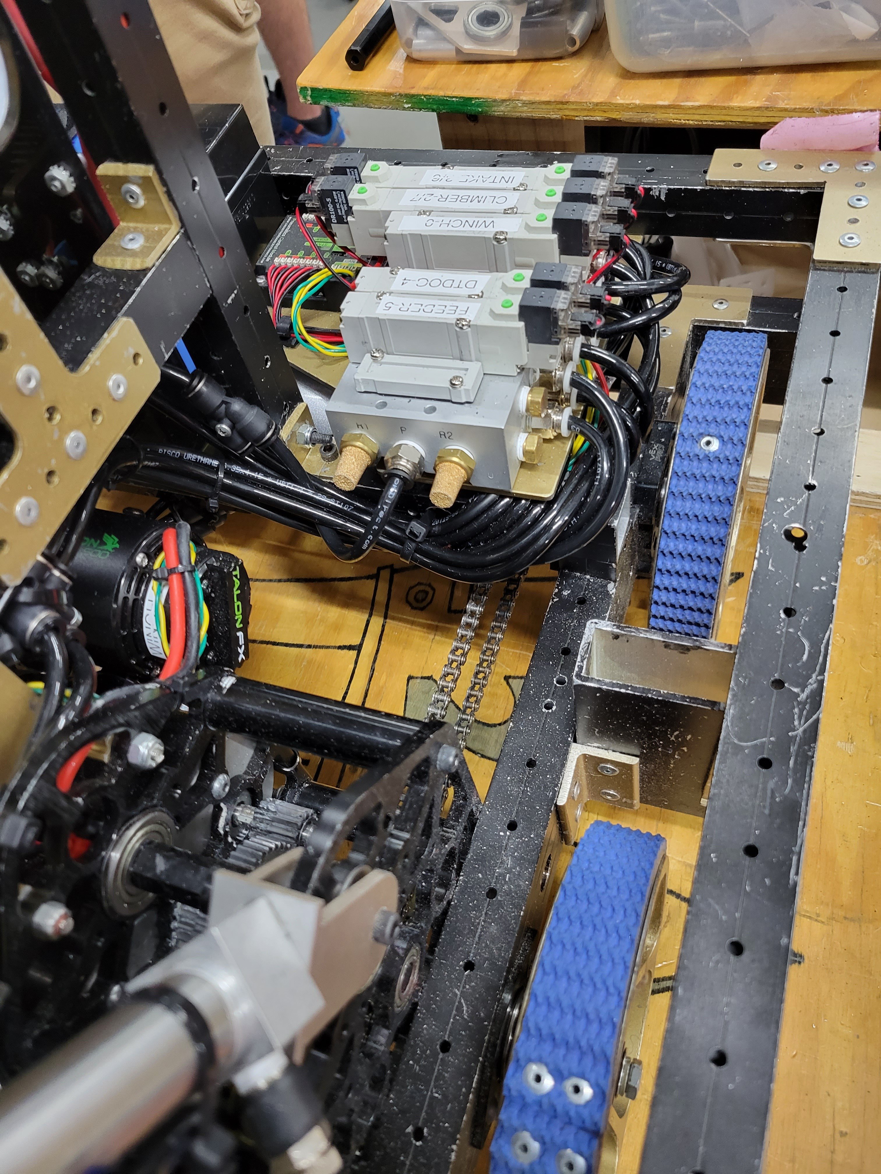

3. We have a multitude of sensors and indicators. We have beam Break sensors in our indexer to intake balls autonomously. We also have a pressure sensor in the indexer that allows us to change our shooting speed for over or under inflated balls. We also have a color Sensor to eject balls of the wrong color. We also have LEDs that indicate the direction we are shooting and the statues of our climbing winch.
4. Redundancy. We have very redundant programing that allows us to take manual control of robot systems if the sensors used to run them autonomously break mid Match. We have redundant power to any system that will accept it. And every wire had spares made to be replaced.
5. Management. Everything is very well managed and well labeled. Envry single wire has at least 2 forms of online documentation. Everything was logged labeled and documented in a way that anyone could understand.

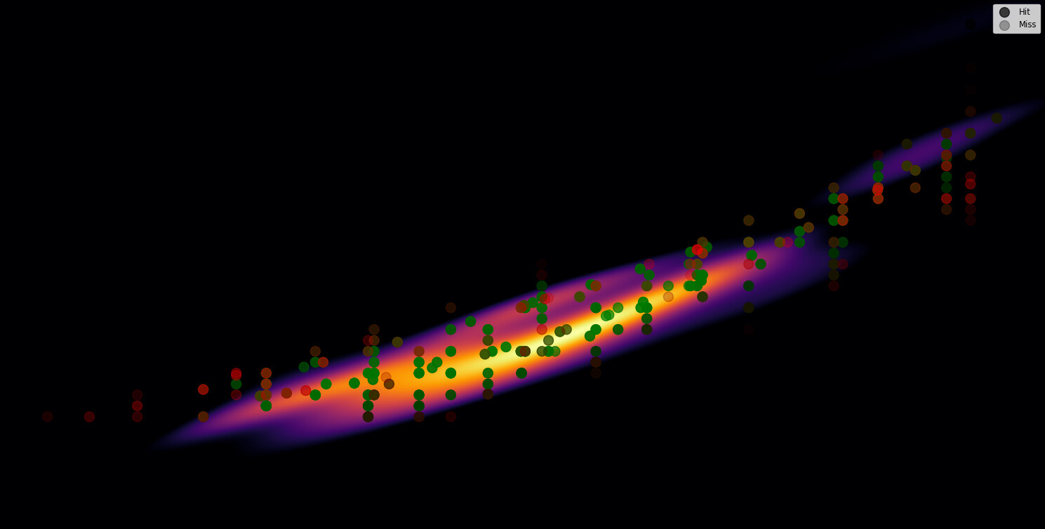

  2. Try to give a lot of demonstrations of what you’re explaining. This could be turning on you robot to show judges how it functions, or other visual demonstrations of your control system. As an example, I made this visualization for our swerve drive inverse kinematics https://i.imgur.com/fj3C8kN.gifv, and this “heatmap” of our shooter accuracy (the x axis is distance from the target, and the y axis is flywheel RPM).

Kudos on the exceptionally clean electrical and pneumatic layout and wiring/plumbing.

Lastly, my opinion is you are spending too much time on item #1 by going into too much detail. At the various companies I have worked at, we only drew in wiring channels, sized based on estimates of the number of wires following that path. All wires were trimmed to length, individually, after being run since real life is different from the CAD often enough that precutting the wires can lead to wasted time and materials. You should also consider using COTS wire guides since you have only so much time during build season and they are made from resilient materials that are meant to take a lot of abuse. For weight estimates, just use the average/typical lengths for a group of wires that all follow the same path. If a few inches of wire is going to put your robot over the weight limit, you have bigger problems.
