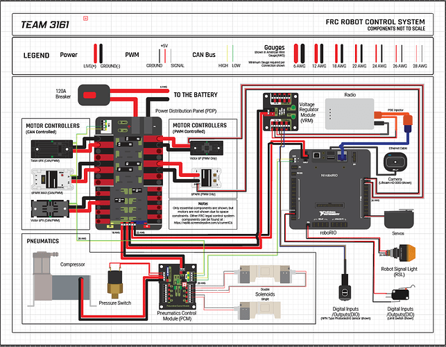

Control System Layout Infographic
so like this?
I’d add the resistors in, though the switch isn’t necessary.
The switch should have signal and ground connected, not 5v and ground.
The wire to the DIO looks grey [signal] to me. As I think on it, I would likely also want to bring the ground (0V) wires from the PDP and the DIO together so the signal isn’t entirely free-floating relative to the RIO.
Added: Looking at the limit switch - IIRC, the DIO signal wires are normally pulled high through a resistor, so you use ground rather than 5V to the other side of the switch. Yes, in figure 16 of the User Manual.
Yes, you would generally put Ground (0v) on the common (as it is in the image) and then your Digital Input Signal line on either the NO or NC pin of the switch (where the red wire is currently running), relying on the pull-up resistors to keep the input from floating.
Also, amazing work on this Graphic! A few more revisions to the above noted concerns and I will certainly be looking into getting one or two large posters made for 3468’s shop and/or programming room!

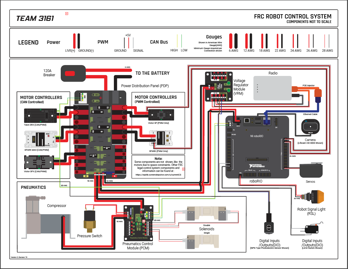

Thanks
also here’s a version optimized for 24 x 30 posters or larger sizes with the same aspect ratio: FRC Control System 30 x 24.pdf - Google Drive

This diagram is excellent. I’m also looking for any similar block diagram that shows example FRC code (preferably Java) and what each section of the code does?
There are no code snippets, and I am not the best at diagrams, but I did make a sort-of “flowchart” of data for the Command-Based Model. You’re welcome to take a look: https://docs.google.com/drawings/d/1wHg6VO_nu9xQN1JkYuypXY1jV53XThowEHbQEw92HNo/edit?usp=drivesdk
