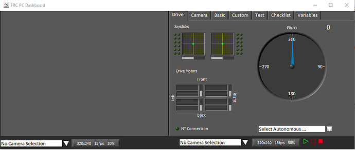

We’re using Logitech F310 controllers. The buttons all map correctly into the FRC Driver Station (current, v24.0.1), but about half fail to map into the FRC PC Dashboard (current). We’re using JAVA and have created a simple tank drive program for testing purposes, but the controller fails to properly control the drive (no specifics - I will ask one of students to post more if needed).
Our workspace is offsite, so I’m asking with incomplete information. Double-checking the CANbus addresses is at the top of my list, but I do think that mapping was done correctly.

What do you mean “FRC PC Dashboard”?
Is it the simulator that you mean FRC PC Dashboard?
This^ It was called LabVIEW Dashboard, apparently? Do we even need this? Last year we built an Everybot as a warm-up to joining FRC and I don’t recall using this.
You do not need that for your robot to function correctly.
Other Dashboard alternatives exist, SmartDashboard, Glass, Shuffleboard to name a few. Those are all provided with WPILib’s installer. There are other 3rd party dashboards that exist as well.
The main thing to know is that the axis values and button numbers MUST be correct in Driverstation because the axis and button polling will be sent to the robot as the Driverstation sees it. If Driverstation is good, and the robot is still not working, then we can help troubleshoot the code.
