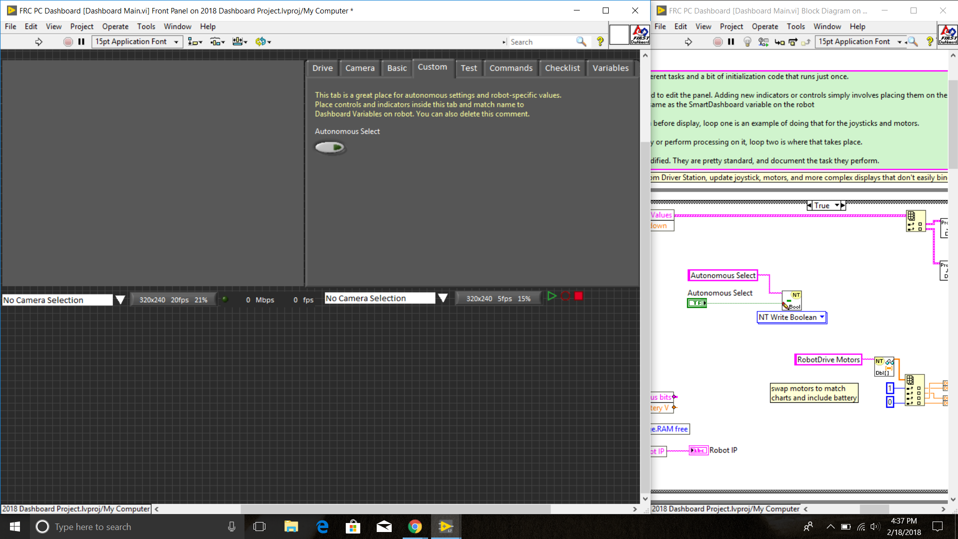

This year for First Power Up we are trying to do multiple autonomous strategies and we have tested all of our code and it works. We have autonomous’s for going to the scale and the switch but we would like to be able to have a button on the driver station to be able to control whether we are going to the switch or the scale with a push button Boolean. We aren’t completely sure how to edit it so we can switch between the two using a button.

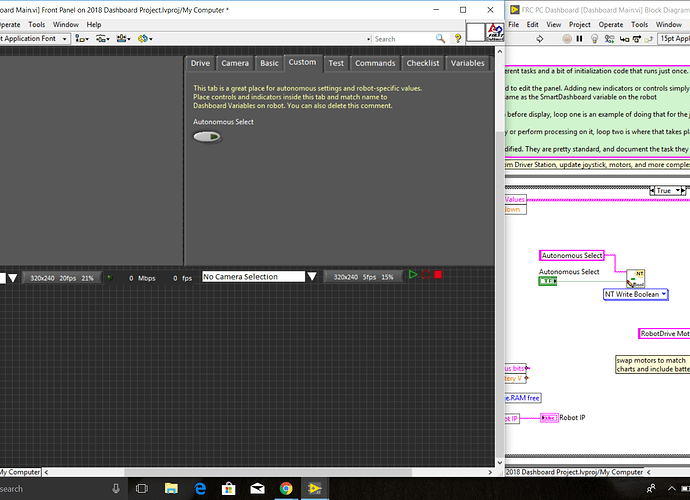

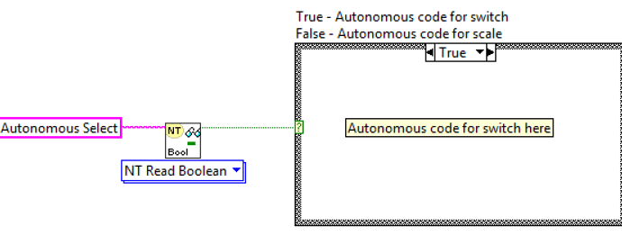

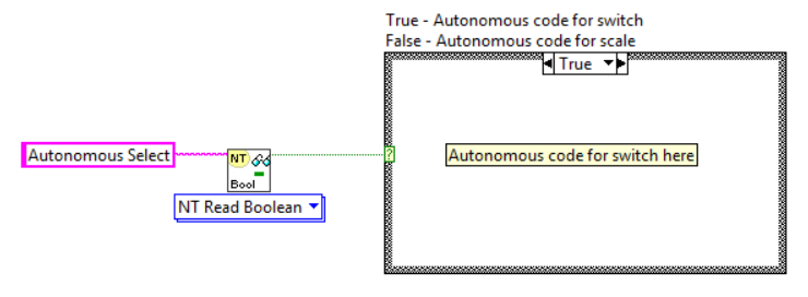

Probably the easiest way would be to use network tables. You could create a custom dashboard that includes an autonomous select button. Then, you could read that value in autonomous to select between the autonomous programs (see the auton select picture). This page has some useful information on using the dashboard program. I would suggest adding a boolean switch to the ‘custom’ tab of the dashboard, which then connects to a network table vi (see the dashboard picture).
