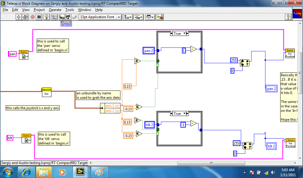

hi so I got the stuff put into my program. all it does when I run it in the drivers station is it just turns to one side and stays there no matter what I do with the joystick. I have attached the program I used that I inserted your program into.:confused: :confused: :confused:
Teleop.vi (37 KB)
Teleop.vi (37 KB)
I just realized that the wires may not be working on my version of labVIEW. Here’s a screencap. (I am using 8.6)
I am not at a computer with labVIEW right now, but I can take a few guesses. (correct me if I’m wrong on this everyone, I have yet to open up the new version of the robot project)
I believe I remember reading somewhere that references are no longer used in 2011, so the two VIs with pan and tilt going into them on the left I don’t think are used (however I have no idea what IS used at the moment, we got hit with snow and have not met since kickoff). Same goes for the far right, I think difference VIs are used. But once again, the code I gave you was never tested with actual servos, just simulated in labVIEW. I’m afraid our team is running a little behind. Tomorrow we are meeting so hopefully then I can help you more.
