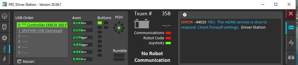

I have a more basic question to make sure your joystick is properly connected.
Since, if it’s not connected, then none of the controls will do anything at all.
Check on your Driver Station on the USB tab (left side of the DS window)
  • Does the joystick show up there?
  • Is it in the “0” or top position?
  • When you press the joystick trigger, does the joystick entry light up on the Driver Station USB tab?
Also, what model joystick are you using?
