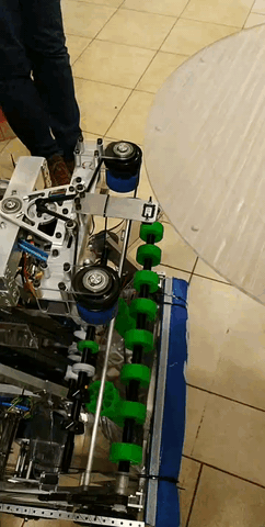

I guess since we’re doing whole mechanisms now i can’t not mention our control panel mechanism. Since we had a tall robot we didn’t need a linkage for it, but we did put it on a pivot to make driver alignment easier, we initially wanted to put surgical tubing for the compliance but ended up using team wristbands (mostly cause it was way cooler). Also it had the coolest serpentine belt path ever.
WhatsApp-Video-2020-02-10-at-190
Apparently this is just what happens when you give one of your best designers unlimited time to make a control panel mechanism.
