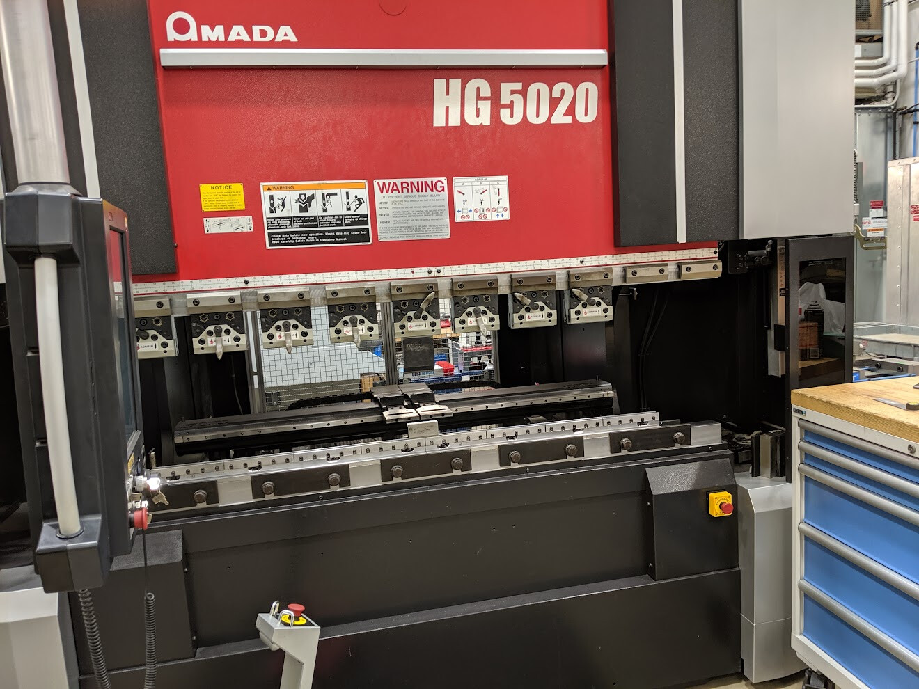

For a team genuinely looking to bend 1/8" aluminum (I’d argue the most any FRC team would need to bend), a press brake would likely be the best route to go. I’ve been considering one of these for my home shop to play around with (heard good things about them elsewhere on the interwebs).

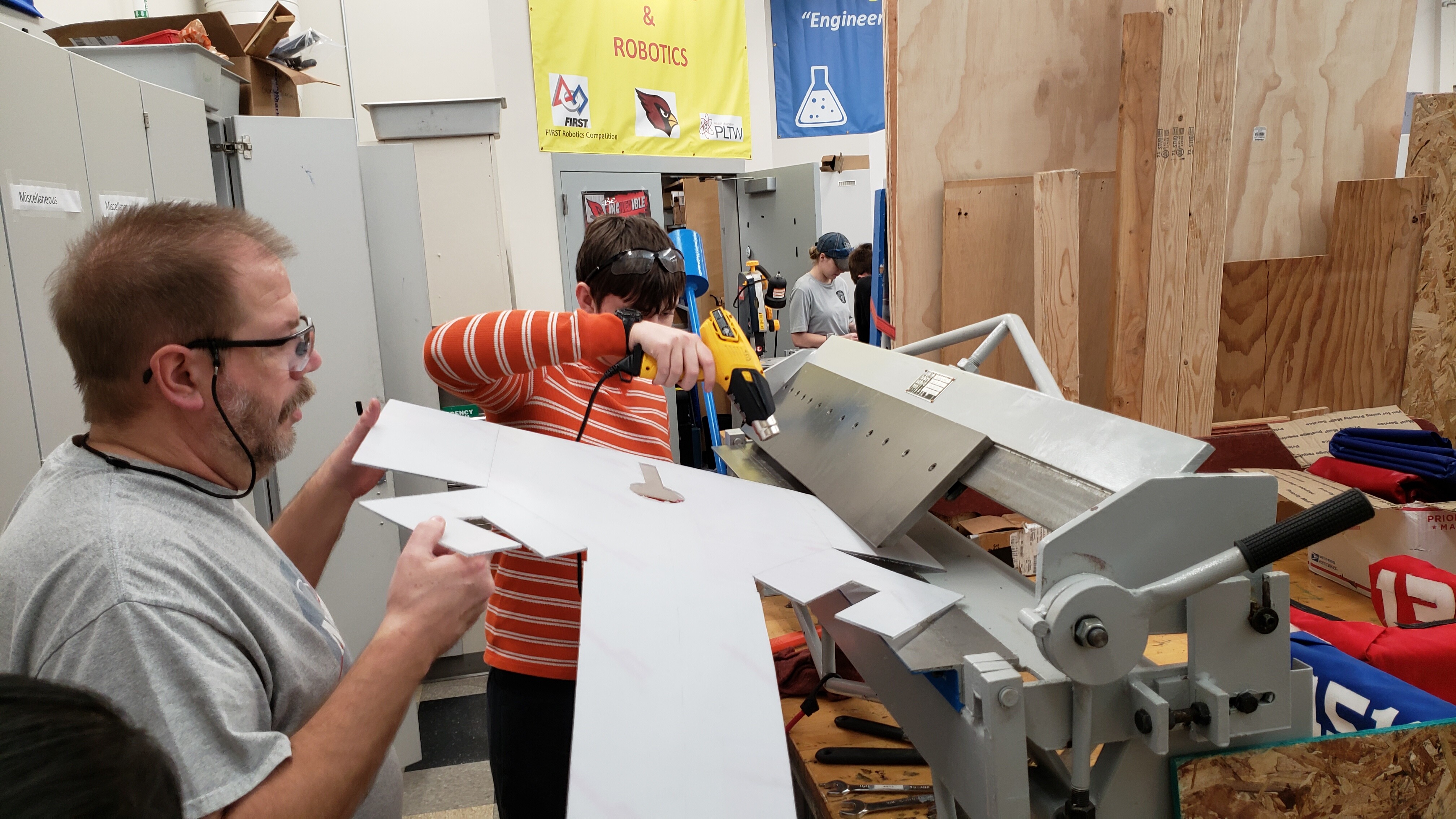

We are a big fans of bending sheet metal and poly. A sponsor used to bend our stuff but in desperation, we recently got one of these. Worked better than we thought keeping in mind that all these cheapie tools have there limits.

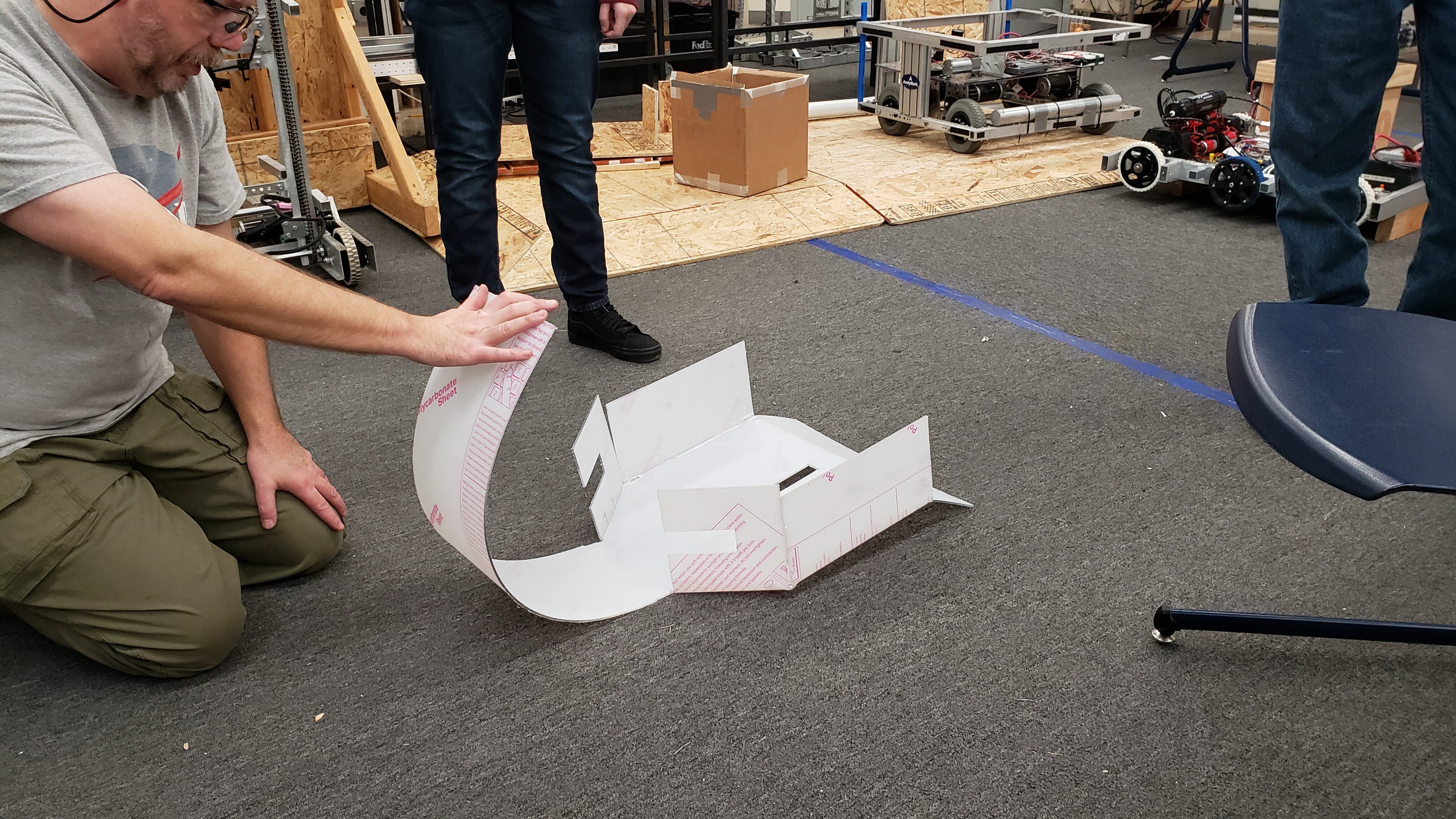

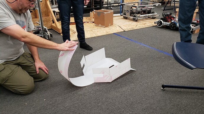

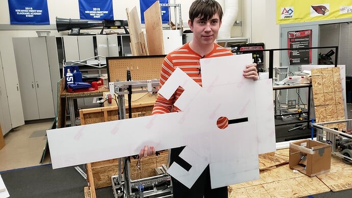

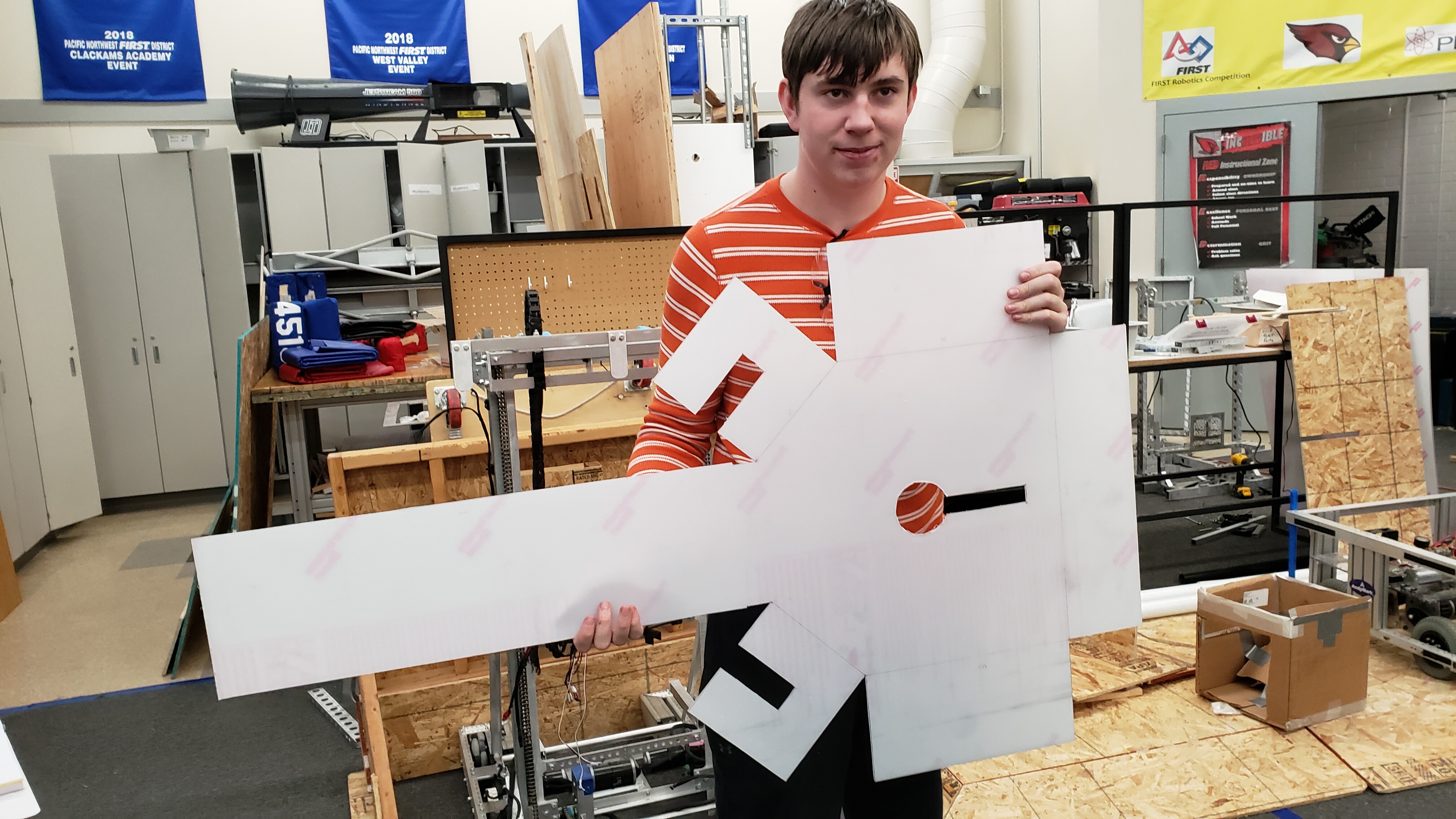

This key shaped piece of polycarbonate became the majority of 4513’s 2020 bot. It had some issues (balls would get trapped) but due to covid the team never got a chance to improve upon it.

In our old shop, we had access to a table top polycarb bending tool (home built) that included this heating element embedded in a plywood table. Once the tool was warmed up, you could just set the polycarb on the table so that the intended bend line was resting directly above the heat element and then just wait a couple of minutes and it would just bend nicely along the line where it was heated. It was much cleaner than using a heat gun (we used the heat gun process for many years with a good percentage of success and only occasionally cracking, bubbling or discoloring the polycarb). We had “calibrated” the tool so that we knew how long to leave the polycarb resting on the table before it was ready to bend (the thicker the sheet, the longer it would take to get to the bending temperature). I highly recommend this method over trying to bend polycarb cold (in a brake). If you have some money to spend on tools and you like to use bent polyarb (and don’t we all), this would be a good investment.
Polycarbonate bends great without heating. Just like sheet metal, but more spring back. Heating just causes bubbles, discoloration, and warping and makes it brittle. I never heat polycarbonate to bend it.
5660 has used this Vise Brake insert a few times to bend polycarbonate and aluminum brackets over the last few years. 4" Vise Brake at Grizzly.com
We’ve got a nice, old finger brake (probably 50+ years old, we’re at least the third owners) and it works great. Yes, we need to adjust the bend radius (there are adjustment bolts for that!) when switching between aluminum and polycarb, but it can easily handle both with beautiful results. With aluminum, it’s important to use the right alloy - the wrong one will definitely crack, no matter the type of brake you have. With polycarb, you need to overbend it due to the springiness, but that’s a learning curve with different material properties, not an issue with the brake. We almost never use heat with polycarb, unless there’s some reason we can’t use the brake for it.

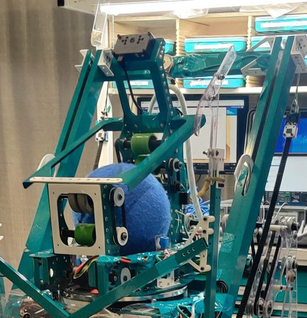

Not the best picture but my senior year we added a “funnel” to our manipulator to better support the cargo. From a sponsor, we have a surplus of polycarbonate, primarily 1/8"-3/8". We decided to make the funnel out of 1/4", and we cold bent the polycarbonate to make the funnel. We started with a rectangular piece and machined it down towards the ends after bending it. Although this isn’t that insane of a piece, polycarbonate can be a bit tricky due to the spring back, especially with the thickness of this, and attempting to mirror both sides of the funnel with a single piece. I did this myself using my work’s brake specifically meant for polycarbonate, but was mostly commonly used for 90 degree bends.

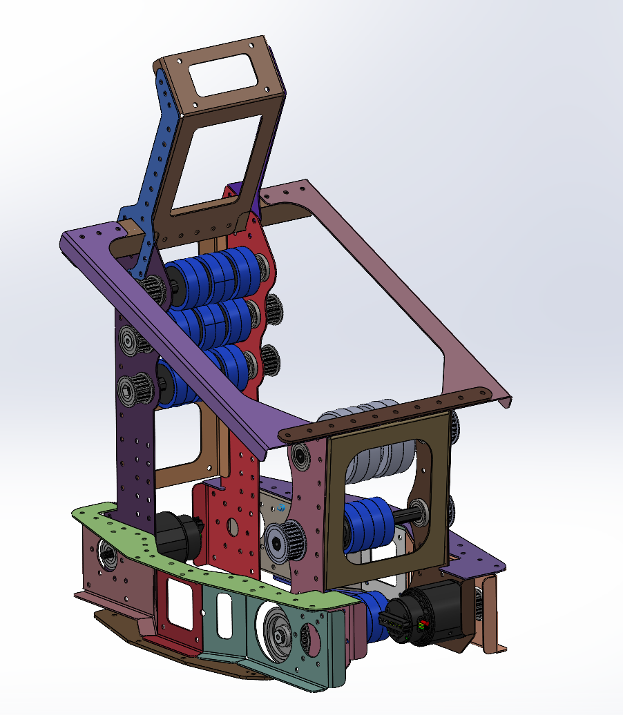

We did our second shooter revision out of sheet metal and saved quite a bit of weight compared to the 1/8" version. This was all bent in either a vice brake or a harbor freight table top brake (https://www.harborfreight.com/30-inch-bending-brake-67240.html). The key to making this work is that every flange on the entire shooter is the same length (0.75") and we set up a backstop so making a bend with that flange length is very repeatable. You don’t need to buy anything fancy - you can get a cheap bender for < $100 and make some great parts.
What sheet thickness and alloy were you using?
Also it doesn’t look like you have holes designed in most of your flanges, correct, you match drill those during assembly.
1/16" 5052. Correct all holes are match drilled. No critical dimensions are set by bent surfaces.

On the topic of press brakes, back on 696 we had a Baleigh BP-3305CNC It was about $13,500 back when we got it, so it’s gone up a lot. It worked fine, but I wish it had true hydraulic downstroke control and a more precise back gauge. But, there aren’t a lot of great options in small or affordable press brakes. Before buying the Baleigh, I was considering an air-powered Atek Bantam, but it’s pricetag gets pretty high with options.
I think @Michael_Corsetto has a different model Baleigh press brake and I know 971 has an old Di-Acro that they use very successfully. Hard to find though.
