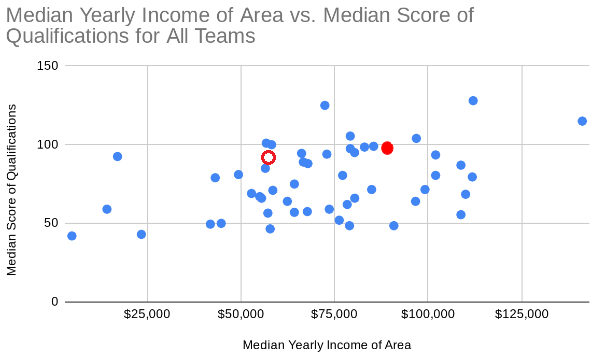

Hi all. I’m just getting around to sharing it, but last year I finished off my AP Stats class with a project examining the correlation between the average income of an area and the success of their robotics team. I know that the project is far from perfect, but at the very least, I think it has some pretty interesting data and graphs. Let me know if you have questions and feel free to correct any mistakes I may have made.
The Association between the Income of an Area and the Success of their Robotics Team

I think that the average income of families with students on a robotics team in a county is not equivalent to the average income of families in that county. While our team strives to support underserved communities, there are a lot of barriers that prevent students from lower income households from participating in our robotics program.

Interesting analysis.
I know you said you used county income because it was most readily available. However, as Ambrose said, this is too broad a population. My county has communities with some of the highest incomes in the state, and some communities among the lowest in the state. If your random team selector picked a team in my county, it might have picked a team from an area far from the county median income, by a factor of 3 or more.
Looks like an interesting project
There are some interdependencies and bounds that are kinda difficult here. Out of the gate I am not sure how you would get around a few of these problems, but considering you have obviously looked at your assumptions a fair bit I ask you the following.
  1. Sample size. 10 teams per week is far from robust, but if you had to limit sample size for practical reasons we will move on.
  2. Median score of qualifications, this does not have an underlying linear relationship (i.e. diminishing returns) and some years it is really out of wack (2017 bracketed gear scoring, 2018 time based scores)
  3. Qualification score relies on other teams, yes those teams are more likely to be from a similar area but not everyone plays in their own county. Is there a better metric you may know of that has attempted to decouple the influence of other teams?
  4. By randomly selecting teams you are less likely to run into the tails of your income distribution, which in turn limits the amount of power the data can provide. Is there a sampling method you know of that partially addressed this?
  5. Is county median income (population in the thousands)representative of a team that has a population of 40?
  6. Median income isn’t a normal distribution (it would be great if it was!) It more closely follows a gamma distribution, so you need to be careful (in a general sense) of applying anything that has an assumption of normal distributions
  7. False discovery rate adjustment may also be a good idea, but you can play around with p values all day if you want.
  8. Some counties may distribute resources to more teams so everyone gets some sort of experience rather than “stacking” resources on a single team. Just something to consider.

Interesting analysis re winning matches, but I don’t like calling this analysis team “success” and defining “success” as winning matches. I would call “success” something different and much more difficult to analyze with public data: things like student outcomes (college completion or ultimate incomes, or % of careers in science or technology fields) of students on the team being greater than the larger student population at that school. There’s of course a self-selecting bias even there (are students joining teams those already more likely to succeed), but is at least more aligned with the goals of the program.

  1. Regarding sample size, I completely agree that 10 teams per week is not nearly enough, but as I was manually entering the data into the sheet, I had to limit it to a relatively small number if I wanted to have a sample from more than one week.
  2. As I was only using data from the 2023 season, I tailored my data choices to this game in particular. It is still definitely imperfect though.
  3. Finding a measure of success that is free of influence from other teams, as well as being easy to analyze and accurate was my largest struggle with this project. I made the decision not to use OPR or EPA as I felt that using a statistic that had already been calculated from a rather complex formula created by someone else was not true to the purpose of this project. I was willing to sacrifice accuracy to create a project that I could label as my own.
  4. It’s been a while since I took stats, so at the moment, no, I do not know of a sampling method that addresses this.
  5. The county median income refers to the median income of all households in the given area (most frequently county)
  6. This was a critical oversight on my end; thanks for bringing it to my attention!
  7. I thought about doing this, but once again it wasn’t practical for the time allotted.
  8. I’ve never heard of this before. Had I known that this was more common practice, I definitely would have changed the project to something that better encapsulates each individual team.

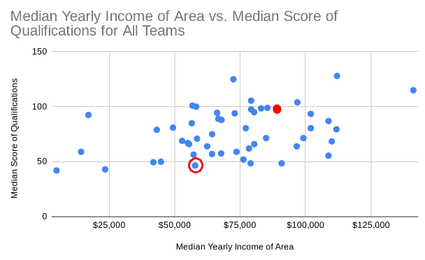

I laughed when I saw that 59 was drawn as one of the teams in week 1. 59’s robot was rough in week 1 even they would admit that, but in week 3 Orlando they implemented a new scoring mechanism and had a whole competition of driving experience increasing their average score from 46.5 to 88.6. The average income of the area they were in did not change but because of the week they were assigned thanks to the random draw it where they are represented in the data is
I believe this is their dot on your histogram
Had they been selected after week 1 was filled thus be using their Orlando data this would be roughly where their dot is
I can make the same argument the other way with 86 by picking their second event where they have more practice as opposed to their first they are given credit for 101 average score when a week previous they averaged 85.8.

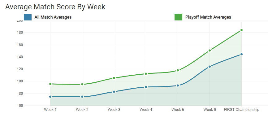

This also brings up that in general scores go up as the weeks go on as TBA clearly shows us.
A better metric may have been how these teams scores compared to the average score of a given week.

I think this is really interesting data, but it does definitely need to be normalized based on week of competition. Using something like the ELO rating or score in the same week of competition would be more personally interesting, but may not pass muster for class.

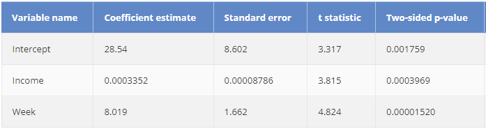

Here are multiple linear regression results including both income and competition week as independent variables. Week was modeled as a continuous variable.
The income coefficient changes slightly from the author’s univariate regression, but by a small amount. Both income and week are highly significant. Interaction between income and week was not significant. Given the small amount of data in this set, a categorical effect of USA vs non-USA team was also not significant. That doesn’t mean such an effect does not exist, but such an effect is not supported by this data.
To put things in perspective, a $10,000 increase in income results in a score increase of 3.4. Moving from one week to the next in the season results in an 8.0 score increase.
While many valid concerns have been raised about the data, one concern that can be answered is that controlling for competition week does not change the significance of the income effect in this dataset.
