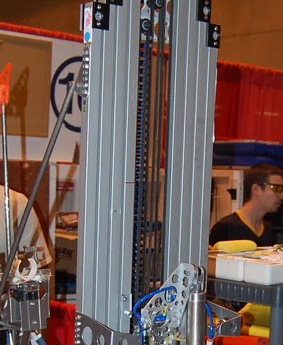

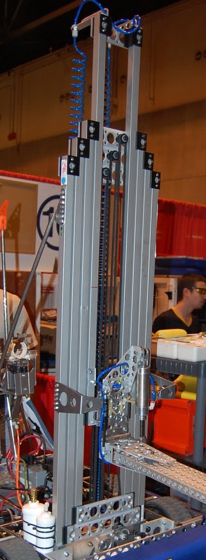

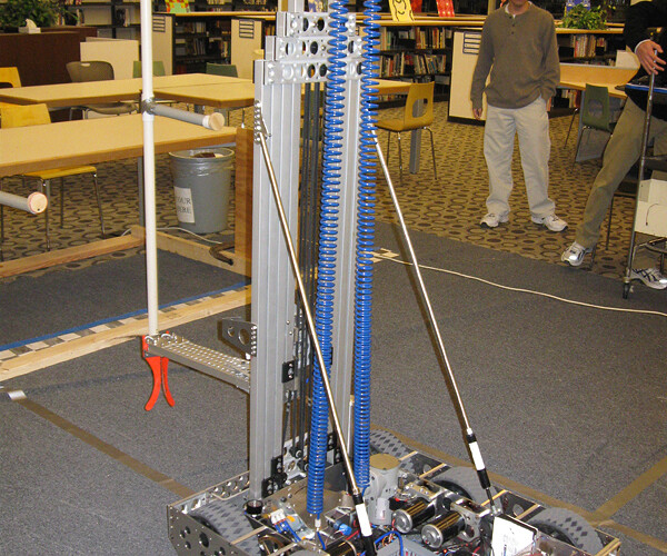

I modified Craig Boezwinkle’s drawing of 254’s 2013 climber because it’s essentially the same thing. I also attached an example (25 in 2011).
How did you guys brace the REV structure? I was trying to CAD it up yesterday but i realized that the brace got in the way of the bearing
This is a great example…but if you can stay away from multiple stages…please do.
I second this. As a part of the build team of 103 during 2011 (25 and us build twin bots that year with a few modifications for each of us), I highly suggest staying away from this many stages. The less stages the better. Although this lift did work very well, we had some significant problems with the belt stretching (Because it was so long), as well as some other problems.
Another thing to take not of in this design: The top lift (middle section in the picture of 25’s bot) Had the grabber attached to the bottom of it, so the robot height was significantly taller than it needed to be when fully extended.
Other than that this lift worked extremely well for us, and we even made it to the finals on curie with that bot!

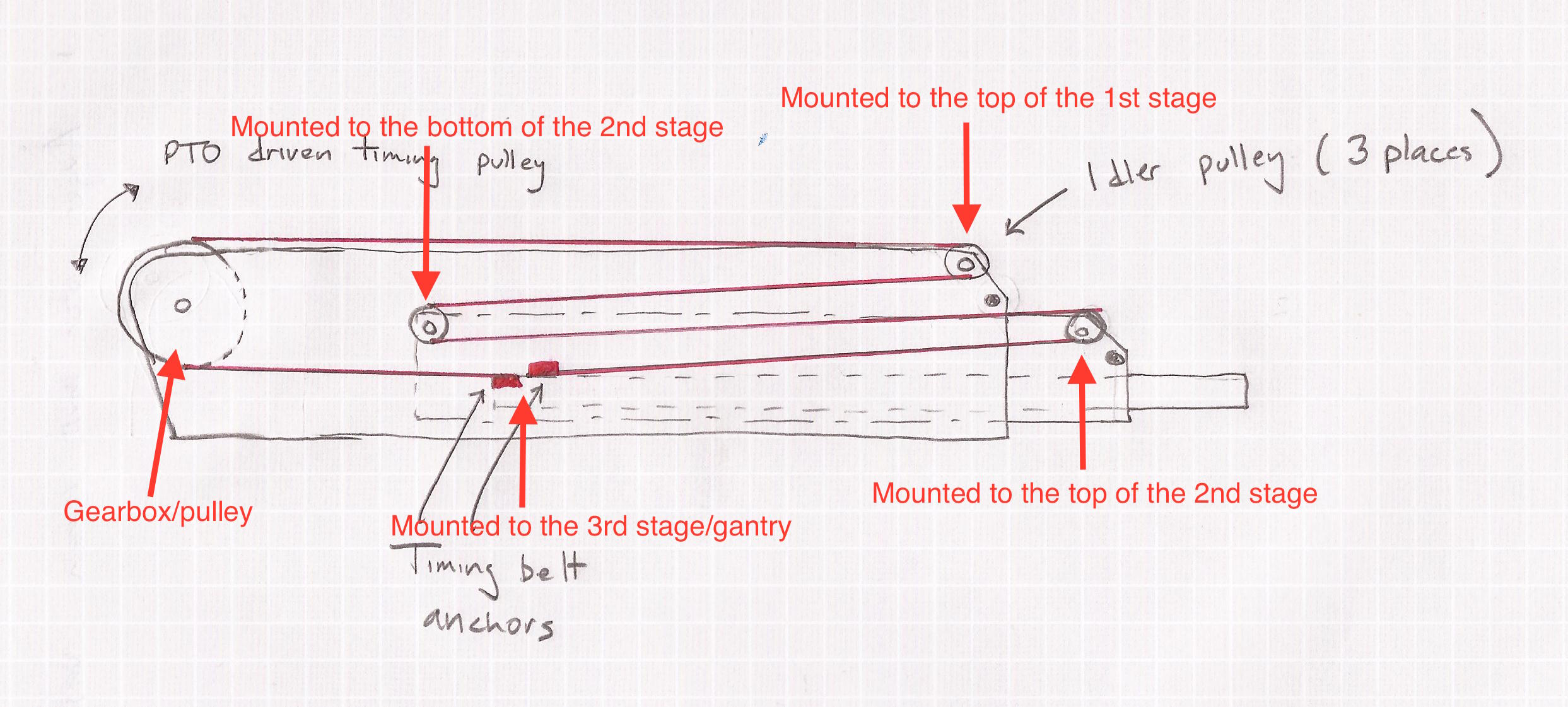

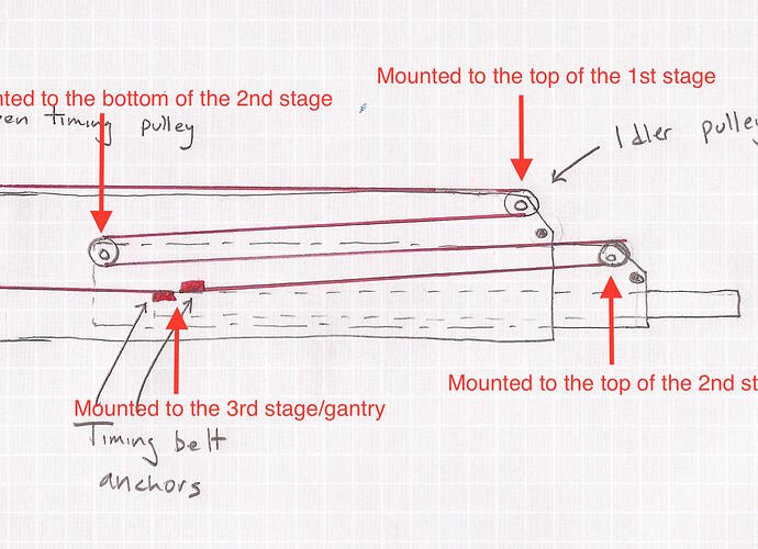

And since there’s one height limit for the whole match, and nowhere to do “the limbo”, a vertical multi-stage elevator for this game is unnecessary. On the other hand, maybe a horizontal one could be useful:
http://www.chiefdelphi.com/forums/showpost.php?p=1424330&postcount=4
