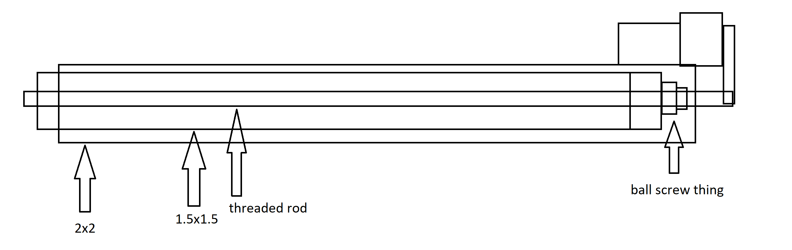

I feel like it’d be easy enough to install a screw drive in the thrifty telescoping kit. (ignore the crude drawing)
(basically one of these in the center of it)
It’s real easy with 1 stage…2 stage completely doable but it’s more annoying. Also, idk how fast it would be.
Screw drives always have some disadvantage. Not only do you have to custom source one, but if you have fine control, it’s slow. If you have a fast screw drive, you don’t have control. It could work with the right pitch balance, but it’d be very heavy
Leadscrews tend to be heavy, slow, inefficient, and a pain to use. Under nearly all circumstances I would advise against them in an FRC setting, unless the non-backdrivable part is a feature for you (such as in some climbers).

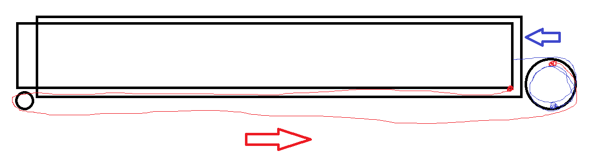

One good question to ask - how many stages do you need in the telescoping arm? If it’s just a single stage, then you could modify a COTS one pretty easily. Remove the springs, and replace them with pulleys. Run a string* from your winch up to the pulley and down the inside of the tube to the bottom of the stage. If you wrap it around your pulley opposite of how the string* going into the bottom of the tube is wrapped, then the two strings will give you a pretty solid in and out motion. Note that some design work is needed on the pulley to get everything lined up right, and you may have to run it on both sides, similar to the springs being on both sides.
*something durable and strong enough, of course!

How would a return on this mechanism work? In my mind it goes up well, but would still require gravity to return the arm to its original state.
Crude sketch:
In this example, by rotating the spool counter clockwise, the red string pulls in, pulling the tube out, while the blue string is released, allowing the tube to go out. Reverse the direction, and the red string is released, while the blue string pulls in, resulting in the tube retracting.
hey sometimes a crude sketch is all you need, and in this case it worked lol. I understand what you mean now, thank you!
