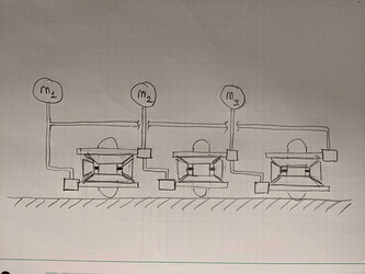

I was wondering of a 3 motor swerve design would be possible? I remember seeing a concept drawing some ware but the only 3 motor holonomic drive I can find is the three wheel omni drive.
3 motor? That would be tricky. You could do 1 modules, and 1 driven Omni wheel, but that’s not recommended. Now 3 wheels? Yes. A two wheel swerve can be done too, if you can figure out a way to support the 3rd side.

There is a such thing as a 3 motor mecanum drive using a complex differential setup, however with swerve, the modules need to independently rotate and spin the wheels which I do not know of a true swerve setup that can do this. A 3 motor crab drive without independently rotating modules is possible but wouldn’t be any good.

Three motors total? Maybe. Should be doable but may be complicated to get all the controllable degrees of freedom.

Hello! Yes, I drew this. I don’t think it’s completely workable, but I am interested in thinking about it.
Here is some noodling I did in Jan 2021 on the whole class of “underactuated” differential swerves. At the time I had a fairly naiive understanding of swerve kinematics so would definitely take a different approach now.
Then here’s what I said in Mar about it. Again, I’m not sure this still holds, but that’s what I thought at the time.
