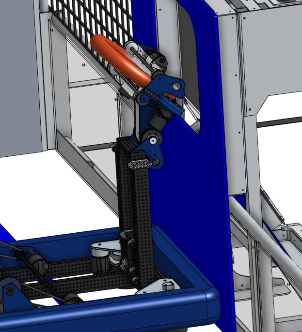

Could amp and trap be done in one mechanism?
The idea behind how the notes are placed in the amp and trap is very similar. Has anyone considered using the same device to do both? let me know if u do :slight_smile:
While you’re at it, add speaker too :slight_smile:
I was just about to say, i feel like some sort of shooter/variable arm intake would be able to do all of these things. Also check on this mans 12 hr CAD, great examples.
I think it’s quite possible.
Our team was considering this, but we’re trying to reduce the amount of moving components. rn we’re working w an interesting fixed system that can shoot both amp and speaker, but trap is not quite within its reach
I think it is definitely possible and likely reasonable, you will just have to figure out how to raise the amp scoring mechanism about 2ft up (likely by climbing) to run the same system as amp scoring.
How did you guys make/think up a design that could shoot into speaker and amp? What degree and how close do you have to be?
the idea is farrrr from anything finalized and we’re still on the whiteboards, but in essence for amp it’s a very steep angle up. For speakers, there’s some discussion abt variable height tho.
