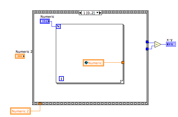

Global variables are quite efficient. Write a test to see how long it takes to read a million of something. On the mac laptop I’m using, an empty for loop took 2ms for 1 million iterations. Adding a double precision constant makes it 5. Changing that to a control terminal is also 5. Using a control local makes it 75, and using a global upped it to 77.
All of this was with debugging turned off for the VI. So you have a few nanosecs for this in most cases and when using something that could change at any time and doesn’t have optimizations will use more like 70 nanosecs. You can afford that if you do any calculations at all.
By the way, when doing tests like this, avoid using constants for things like loop iterations. If it can, LV will optimize your entire loop to run at compile time to give you unbelievable numbers.

Milliseconds divided by one million gives nanoseconds. And yes, I was simply showing a common and accurate way of profiling stuff, though I didn’t really show it.
The first picture shows a way to time this, and the second shows a way to get zero when doing something a million times.
Variables aren’t efficient, but inefficient has different meanings depending on what you are doing. Since this will allow you to change code and retune on the fly without even recompiling, I think it is a good tradeoff. If it seems like it is getting too expensive, you pull the global outside of a fast loop and read it once and put it into a shift register.
