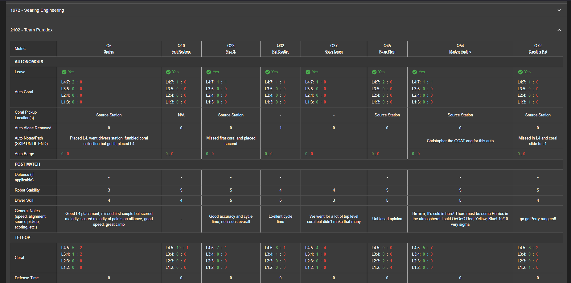

That being said, the display views part of the metrics was definitely the trickiest. I have a big table type view with sortable columns. I only setup the barest minimum amount of weighting (for scoring L1-4) and it kinda worked. The issue is that your weights change depending on quals vs elims, and they change depending on first pick or second pick, or if you’re going for triple offense vs a defense third bot.
I would also recommend having a raw reports view so you can check out what happened in a specific match

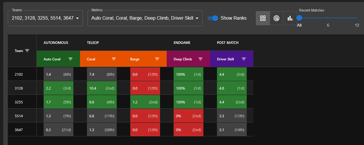

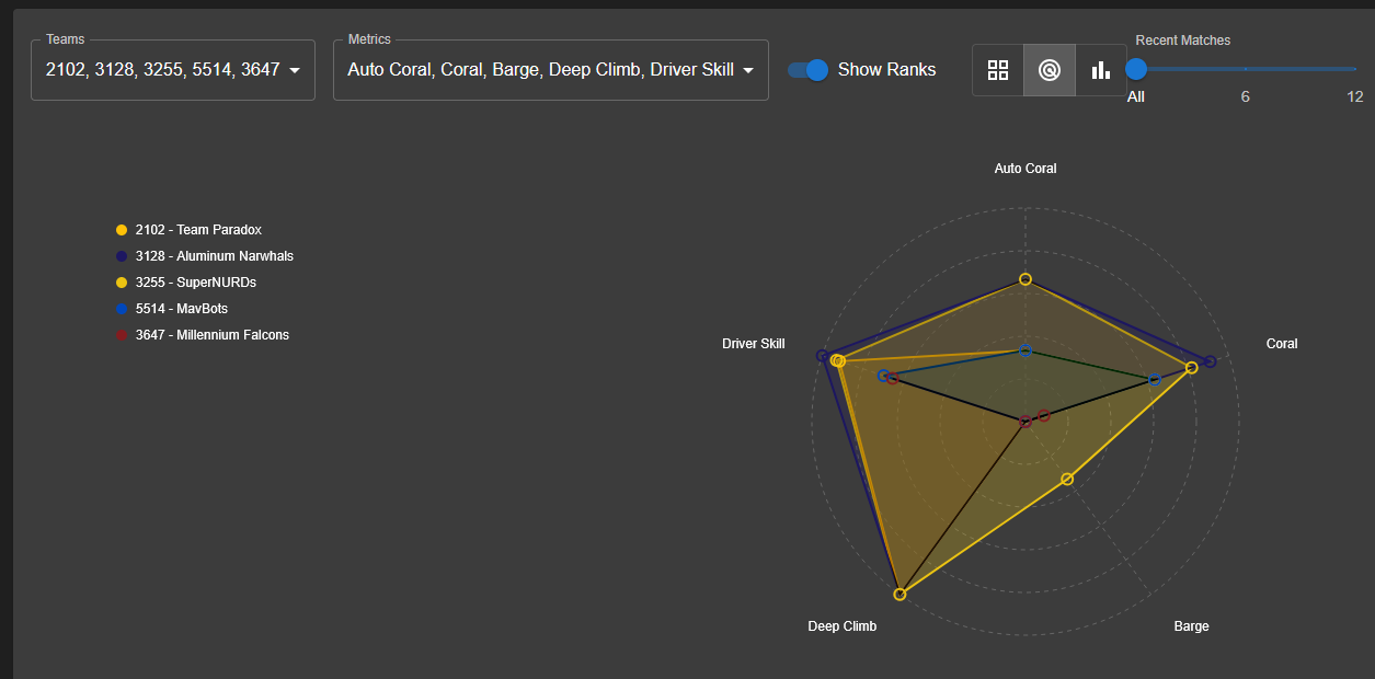

I’m also a fan of comparison views, where you can select multiple teams and metrics, and compare them. Both in table form and a radar graph
