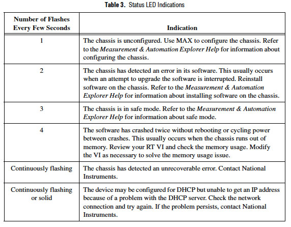

After reimaging the CRIO to the newest version, we are unable to communicate via ping or CRIO imaging tool. The yellow status light blinks. Anyone know what is wrong?
Thanks
Thanks
I’m guessing the left column is flashing every 1,2,3, or 4 seconds? What would be flashing continuously then?
The flash sequence would go something like:
flash, flash, flash - pause off (repeat)
It flashes once then stops and repeats
The image went awry or is otherwise corrupted then.
You’ll need to set the Safe Mode switch, reboot the cRIO and try with the Imaging Tool again.
