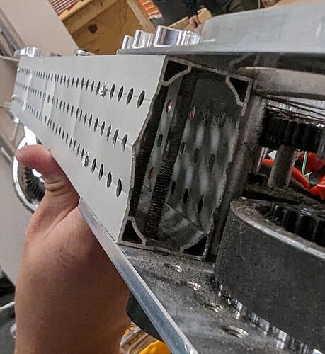

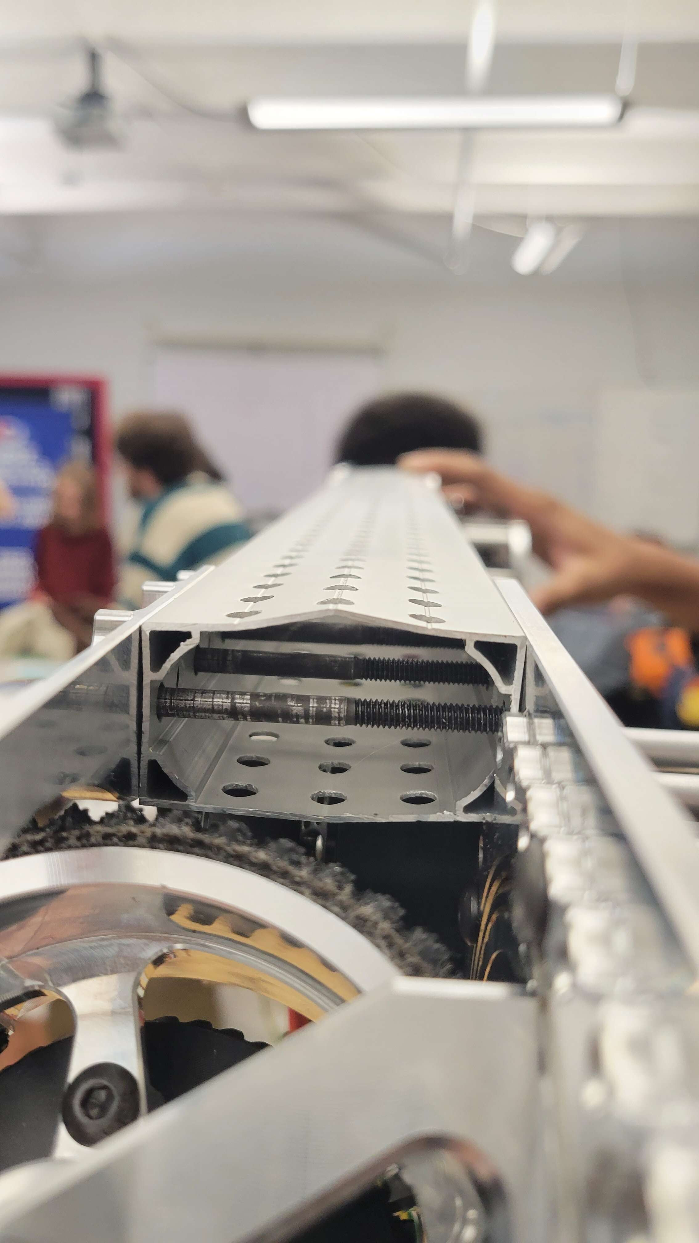

However, I’ve seen my students on 5010 and other examples of people just absolutely crushing it (quite literally.) Because the material is thin (like 1/16 wall tubing as well), it’s really easy to overtighten thru bolts and bow your tube walls -
Photo Credit @BryceHanson
Photo Credit FRC 5414

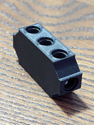

Naturally, I turn to 3D printing in these situations. You can find the STL files for these spacers here: 040 MAXTube Anti Crush Spacers - Google Drive

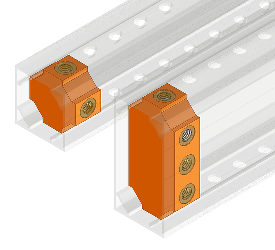

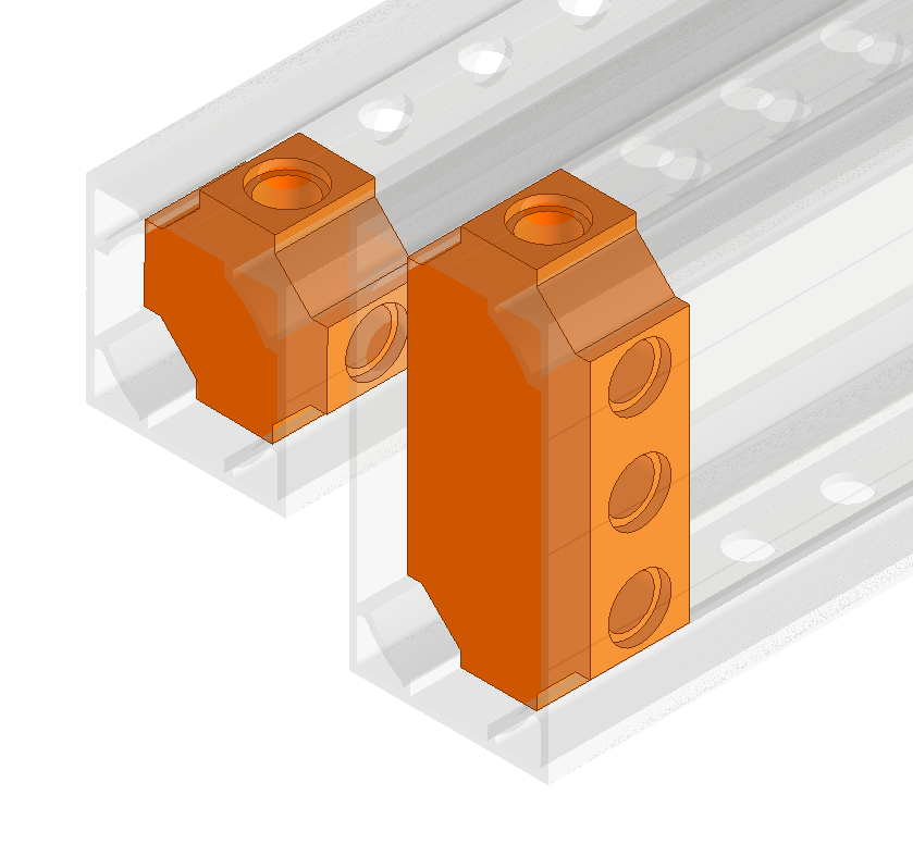

These spacers have .003" of clearance around the material edge and that seems to print well on Markforged or Prusa printers & inserts with a small amount of resistance into 040 MAXTube. Using these with thru bolts should prevent squishing your tubes -
However, it seemed silly to not get a free feature here when there’s one available. Using this McMaster part will let you turn these into light duty mount points, or simply insert a 10 bolt to make sure the spacer doesn’t fall out when you remove the thru bolts. Printing them on their flat face without supports seems to work just fine -

And for everyone saying rivnuts, those are not rivnuts in that 3d printed block. They are threaded inserts and I wouldn’t trust them to hold anything important, you can easily strip out the 3d printed block tightening the bolt. Rivnuts hold great as long as they are properly installed, there in lies the problem a lot of people have with them

You definitely could, but those aren’t rivnuts inserted into the plastic part, they’re a screw to expand threaded insert. My comment on rivnuts was if you were installing said rivnuts directly into the tube, as like Ryan said in his initial post, the plastic inserts are to prevent crushing, but aren’t exactly intended for high load situations (if you thread/bolt into the threaded part instead of using a throughbolt).

If the insert is placed opposite where the faster enters so you pull the insert into the printed part as you tighten they are much less likely to fail. We also increase our number of walls on our prints to give the insert some more material to hold onto.
