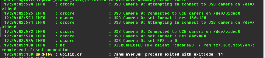

I’m not sure if this is related, but I’m getting an exit code of 11 as shown below. I’ve disabled the NI webserver as mentioned above, and my robotpy versions match what is shown in the list above too.
I believe exitcode -11 is a segmentation fault. This is probably not the memory issue, but I do not have much more help than that.
-11 is a segmentation fault. It can sometimes occur in low memory conditions, so my guess is that there’s still not enough memory to go around.
