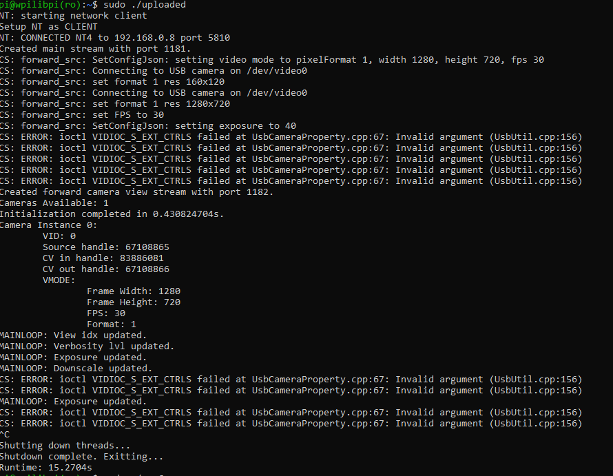

For the past day or two, any attempts to set the manual exposure for a USB camera using cscore has resulted in the error CS: ERROR: ioctl VIDIOC_S_EXT_CTRLS failed at UsbCameraProperty.cpp:67: Invalid argument (UsbUtil.cpp:156) and the exposure not getting updated. By default the camera is stuck in “auto exposure” mode, and ends up streaming at 7.5 fps, sometimes 15 if it is in the correct lighting conditions (it should be at 30).

Here are some sample outputs:
(our program)
(default streaming)
Here is the line that sets the exposure:
cs::SetCameraExposureManual(ctx.camera_h, _global.nt.exposure.Get(), &status);

Does it work to set the exposure settings interactively on the stream server web page? E.g. set exposure to manual mode, and then move the manual mode slider?
The exact V4L2 property names for camera exposure seem to have changed over recent Linux kernel versions, and the SetExposureManual() function assumes certain names, so it’s relatively fragile right now. v4l2-ctl -D 0 --list-ctrls (or something similar to that) should list all the camera property names. You can use these names with GetProperty() to set specific properties like you can on the web page.

Setting the exposure manually on the stream web page also failed and produced the same output, except for half of the time when setting the raw exposure to 0 would work.

I wouldn’t know if any of them have changed, but I can try implementing the direct property modification and see if that works. As a side note, I always wondered how the stream gui had so many options while the api didn’t mention hardly any of them - I guess now I know.
Yep, those names are not what the code assumes for those properties. The code assumes exposure_auto and exposure_absolute (instead of auto_exposure and exposure_time_absolute). Linux changed the names at some point relatively recently. Note for setting exposure_time_absolute you’ll want to implement this scaling function to go from the 0-100 range to the exact values required by the LifeCam (or just use one of the exact values, since you’re setting a fixed value anyway): allwpilib/UsbCameraImpl.cpp at main · wpilibsuite/allwpilib · GitHub

Ok I swapped in these lines
cs::SetProperty(cs::GetSourceProperty(ctx.camera_h, "auto_exposure", &status), 1, &status);
cs::SetProperty(cs::GetSourceProperty(ctx.camera_h, "exposure_time_absolute", &status), _global.nt.exposure.Get(), &status);
but it is still stuck in auto exposure mode unless the value being set is 0 (then it sets to a very low exposure). No error outputs except for at initialization where I presume other parameters that also had their id names changed are failing.
I tried manually sending values from the lookup table (5, 20, 156, etc.), but nothing happened. This is the same behavior I was seeing when setting from the web gui.
You need to set auto_exposure to 0 to get manual exposure control via exposure_time_absolute. Setting it to 1 is enabling auto exposure, disabling manual exposure control. You can confirm the menu values with v4l2-ctl, but I’m near-certain setting it to 0 is what you need to do.
