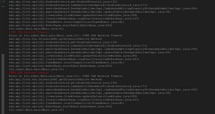

CTRE CAN Receive Timeout and pneumatics problems?
After adding a pneumatics command and subsystem file, there seem to be CTRE CAN Receive Timeouts that are causing the program to crash. I attached an image of it and the base code.
We have no idea why that’s happening?

Did you change anything as far as hardware? This is the error we get when someone reverses a CAN wire by accident.
Seems like the CAN bus could be terminated prematurely at the PDP before the PCM. Not sure if that would throw this error but worth a look.
First things first, open Phoenix Tuner and confirm the PCM is present under the CAN Devices tab. Then, check its ID is 0.
You are also instantiating a second PCM’s worth of DoubleSolenoid objects.
You have them properly on 0,1 and 2,3 for the first two. According to the DoubleSolenoid javadocs I think you need to use the second constructor option, where you specify the PCM as well as the two pins that are connecting the red/black wires of the Solenoid.
It will be something like:
hatch = new DoubleSolenoid(0, 0, 1);
habFront = new DoubleSolenoid(0, 2, 3);
habBack = new DoubleSolenoid(1, 0, 1);

As far as I am aware, there is only one PCM for FRC teams to use.
Perhaps your electronics team have tricked you :stuck_out_tongue:
http://www.ctr-electronics.com/pcm.html
The CTRE PCM can handle 4 double solenoids or 8 single solenoids.
In regards to the code, I think you can use this:
solenoid = new DoubleSolenoid(PCM_ID, 0, 1);
Where PCM_ID is the PCM’s CAN ID.
This is correct however only 3 double solenoid are used in this instance, the constructor that uses the default ID of 0 would be fine unless the ID had changed.
So is it not working because not all of the solenoids are connected? I thought that even if a solenoid isn’t connected to the PCM, it just doesn’t run and the rest of the code works fine
No sorry, not all the ports need to be used on the PCM.
