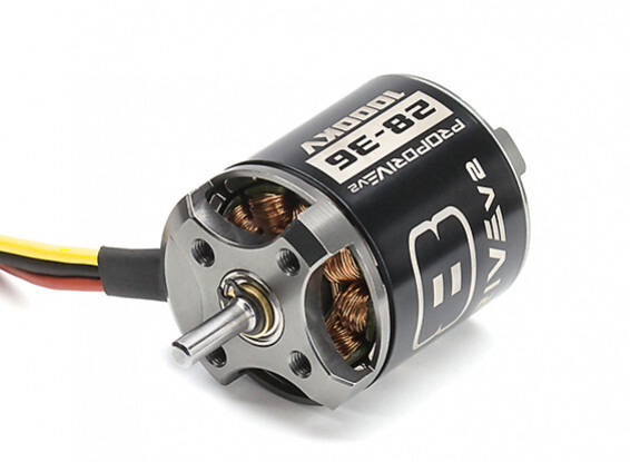

I’ve discussed in on other forums, and there’s some good debate about how well it would perform, but here’s my COTS motor pitch:
I think we should allow any COTS brushless motors and PWM ESCs (within limits).
For instance, a COTS 32-bit brushless ESC like this one:
Combined with a 150 to 300W brushless, sensorless motor like these: https://hobbyking.com/en_us/propdrive-v2-2836-1000kv-brushless-outrunner-motor.html
https://hobbyking.com/en_us/trackstar-380-sensorless-brushless-motor-3800kv.html
https://hobbyking.com/en_us/propdrive-v2-3542-1000kv-brushless-outrunner-motor.html
Would make for a nice little 550 or 775 brushed motor replacement. The advantages are:
  • Motors with a 5mm shaft would be compatible with COTS 775 pinions. Motors with a 3.175mm / 1/8" shaft would fit COTS 550 pinions with a little drilling / reaming.
  • The ESC comes with BLHeli32 firmware, which allows you to set current limiting to protect the motor from overheating (cheaper ESCs don’t have this feature).
  • The PWM input makes it safe, following the RIO’s brownout and disable instructions.
  • Motors can be found in a variety of “KVs” to match torque and speed requirements.
  • You might not have to regulate every motor and ESC combination - just give a max wattage or current limit. That would prevent supply shortages and international shipping costs.
  • The motor and ESC together can be bought for less than $120.
The disadvantage are that a sensorless motor won’t give you any fancy motion control features, but that’s not needed for things like intakes or flywheels. We’d still have the (very excellent) Rev Spark/Neo ecosystem for fancier motor motion control programming.
