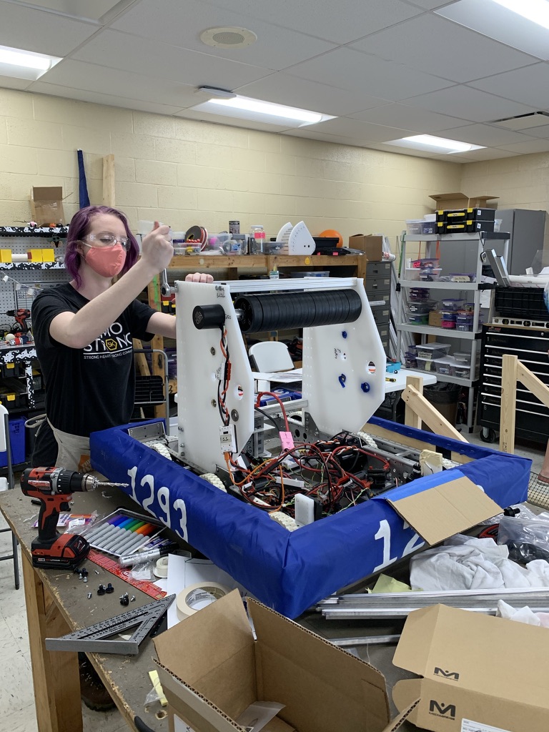

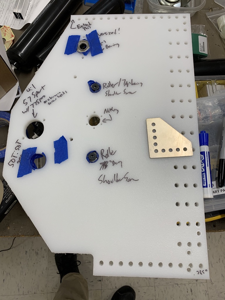

One plastics supplier that I’ve preached for the last several years: Sam’s Club. A 15"x20"x1/2" loosely-toleranced piece of HDPE (which amateurs may recognize as a cutting board) is still $7.64, which is actually cheaper than the usual $8.98.
Cuts like wood, and it’s plenty durable. We used two as side plates on our 2021 shooter rebuild, routed on 2815’s X-Carve.
Then we discovered some of our guesses were off, so we took them off, made notes…
…and spent a whole whopping $20 to make version 2 of our shooter with tweaks (fixed oversized bearing holes, eliminating unneeded material, changing the hole pattern for the AndyMark Peanut standoffs, etc). Once we got past the teething issues, it was basically maintenance-free through at-home challenges, SCRAP, and demos.
It sounds silly to say $40 of cutting boards changed our entire worldview about how to build robots…but we certainly weren’t talking about adding a CNC router to our shop beforehand!
