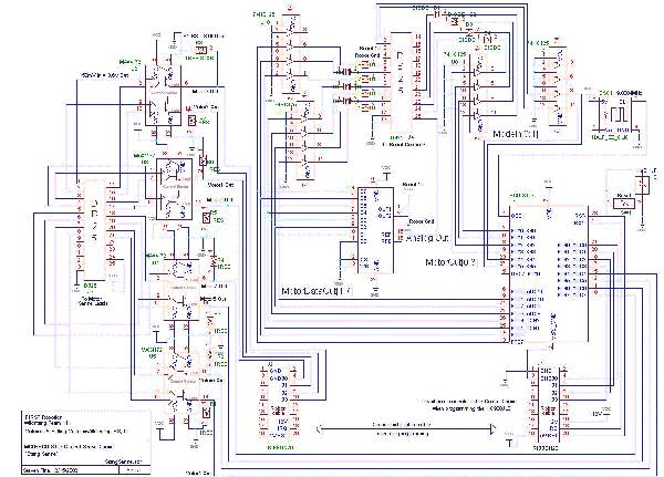

Many years ago we developed Stangsense using a MAX4172 Maxim high side current monitor. We simply made a series of one foot long #10 wires with a sense lead at each end. The MAX4172 then measures the voltage drop across the wire (which is ~0.1 volt/ft/100amp) and then ported that to a A/D and some multiplex circuitry to a digital input on the IFI controller. It then allowed us to port that into the dashboard stream which we configured a Palm to accept data from and we had data on current from a variety of motors along with the sampled battery voltage which was part of the dashboard stream as well as other useful items. I believe the schematic resides on CD here someplace for the price a search.

I am having the same problem and it won’t allow my user and password in. I found the schematic here on my home computer so I have attached it. I am pretty sure it exists here on CD someplace but here it is again.

I cant read that schematic but it looks way more complicated then it needs to be. The MAX4372 from Maxim-IC requires basically no additional circuitry and will allow you to use a resistor or more properly a shunt of very low resistance.
normally what one would do if they wanted upto 10A is use a 10 miliohm resistor and then put a 50v/v amplifier on that.

The chip to which you refer was not available at the time. The chip called for is easily scaled by one external resisitor to produce a usuable range for the input current we expected. Please note that this is a multichannel device intended to look at up to eight different current sense inputs and channel them for our use to the OI. We also developed this for a handheld unit which we then used to help teams troubleshoot problems. One of the first was the ThunderChickens which were using a multimotor transmission that year. It pointed out a dead motor in that system after team mentors had been scratching their heads for a while.
For anyone trying to develop another method, please remember that there does not exist a bipolar power supply on the robot to which standard analog options can be connected.
Oh dont get me wrong what you did I am sure was great, I just cant read the schematic (too blurry). Things change with time, I know that the meters that I have made over the last eight years a very different. Keep up the good work.
