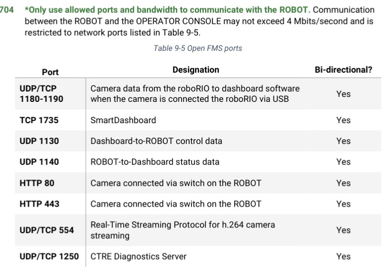

R704 allows the following ports to be used by communication within the RIO-coprocessor-radio-DS ecosystem:
As well as ports 5800-5810, for “team use”.
