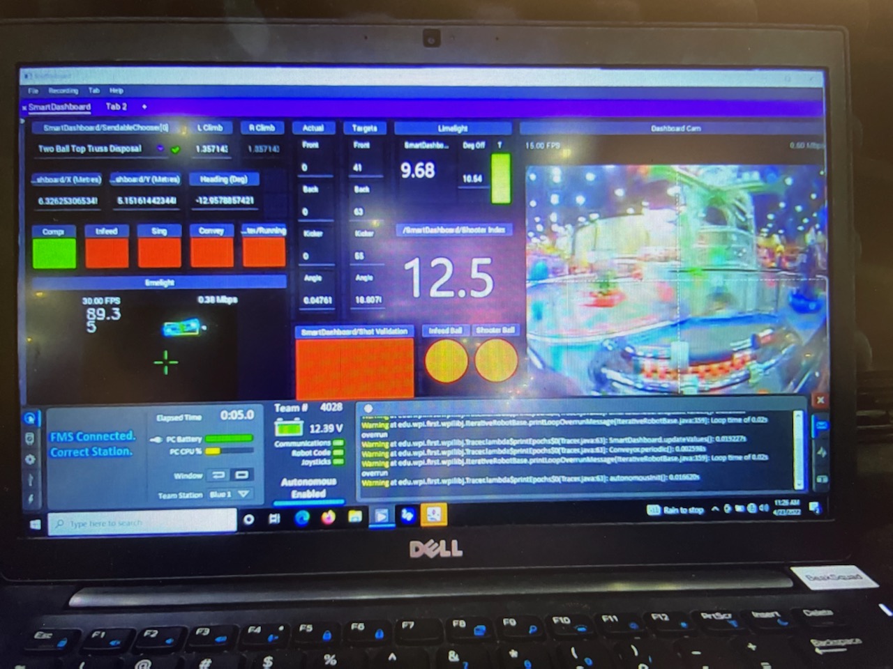

At Worlds we had a little widget that would display whether or not we had a ball in one spot, as well as its color.
Frankly kinda made it in a rush and couldn’t figure out how to set up the Gradle project, so I ended up forking Shuffleboard and modifying the example widget. Find it in example-plugins (BallStatus widget): GitHub - Team4028/shuffleboard-test
Example of it in action:
Sometime later I’ll see if I can figure out setting this up in a standalone project, and also fix the hierarchy to org.usfirst.frc.team4028 rather than the example stuff. Last time I tried that it broke.
