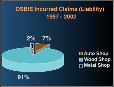

Also, a band-saw and a table saw aren’t really comparable when making long cuts. A table saw is designed for long cuts. And band saws are not safer. I wish I could find more info regarding this, but here’s one image from my presentation. Also, if you plan to ask, no, I don’t know who OSBIE is.
OSBIE - Ontario School Boards’ Insurance Exchange (first result in a good search “OSBIE shop accident”)
Your data is from this article: http://www.machinesafetymanagement.com/wp-content/uploads/2014/05/osbie_oracle_canada-2.pdf

One could reasonably conclude that woodworking and woodworking tools are more dangerous than metalworking and metalworking tools. I would opine that this is because metalworking saws and the like all have work-holding, where woodworking tools generally do not.
Note: table saws tend to have higher numbers of accidents because they’re used a lot. This data does not seem to include hand-held power tools. Hard to compare circular saw data to table saw data because circular saws are frequently used on construction sites, on ladders, up scaffolding, etc increasing the likelihood of an accident.
I look at your data and draw almost opposite conclusions, influenced by thinking about which machines have user-held parts vs complete workholding integrated.
Your OSBIE Shop Incidents counts look heavily influenced by the “kinds” of cut being made.
Bandaws & Jigsaws are used to make weird shapes, with users having to hold the workpiece themselves and figure out with experience what radii they can cut down to. It’s not surprising that they’d total more than 50% of your instance counts. While they’ll have high instance counts, the severity is rather low - workpieces don’t get slammed into your abdomen, they’ll trap a hand on the blade.
(I’m surprised sanders/benchgrinders aren’t on the list, I’ve definitely had way more interesting experiences on those than on chopsaws or bandsaws.)
The fact that 26% (a full quarter) of reported incidents are coming off tablesaws - with tablesaws only being used for straight, simple cuts - is impressive in a bad way. And likely related to the fact that users are handling their workpiece themselves rather than attaching it to a machine bed.
The radial saws account for just 3% of incidents, likely mostly because workholding strategies are in place on those machines.

Are you thinking about severity and then posting data about occurrence?
I think the flaw with both of the OSBIE charts is that we don’t know the actual usage rate compared to the reported injury rate, so we can’t draw any conclusions. It’s entirely possible that Ontario’s curriculum doesn’t include significant metal shop work, so there’s very few injury claims. You can apply this same idea to the tools, the most injuries come from the tools used the most.
That’s fair. Do you have a different or better dataset to look at?
A more useful statistic would be to normalize the data to injuries per100,000 hours of use (or some similar discrete time increment).
