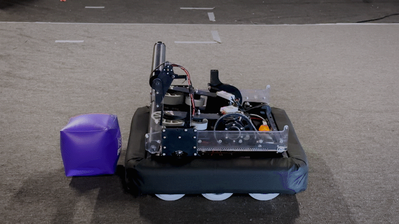

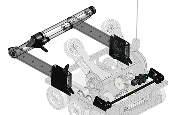

This off-season, we built almost a direct copy of what we saw from 254. 10DP 6mm thick polycarb racks with steel gears for our intake’s activation. As far as I understand, plastic gears are ok for low torque- high speed applications. Even though our setup is very inefficient, this thing cooks in our eyes.
Reasons for it being unoptimal:
  • We have a NEO 550 running it since we didn’t have a full size BLDC for it. (I love 550 for rollers.)
  • We have a VP gearbox and 3 (very tight) belts before the racks and pinions.
  • Gears meshing with the plastic racks are laser cut.
  • We hand filed the polycarb teeth after CNC since our router sponsor didn’t have the needed diameter end mill. This comedic thing was our friction reduction process. :skull:
Stars were aligned for it to work bad, but this was the result we got with suboptimal tuning.
It even works fast enough for a 5 cube auto.
I don’t know how much lifetime this thing has or how will it take a beating in comp, but this journey has made me less biased against plastic gears. We need to up our material selection game.
