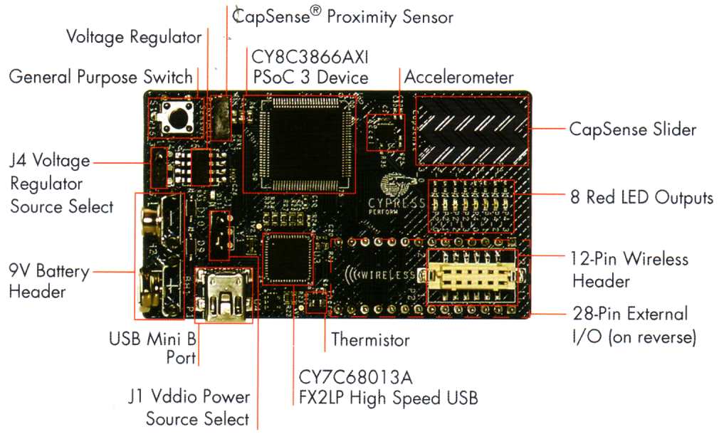

Look at the back of the Cypress board and you’ll see the pins labeled that you wire your swiches and potentiometers to:
http://www.chiefdelphi.com/forums/attachment.php?attachmentid=8352&d=1264090529
Wirewrap, a prototype board, or purchasing a special mount from AndyMark can be used to connect your switches.
There’s no programming necessary on the Cypress or Driver Station.
If you look on the Driver Station I/O tab you can see if it’s working and even change some of the characteristics of how each contact is handled.

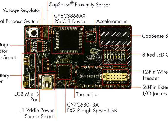

You do have to flash it. See How to Configure your I/O Module
You don’t need the 9v battery. The Cypress board will use the battery or the USB power, not both anyway.
DO connect the Cypress board directly to your Classmate, NOT through any USB hub. It does draw a lot of power and last year a lot of teams had it drop out when match time came.
You can connect an LED to Digital out using an appropriate resistor.

This covers the compatibility mode I/O. Where are the extra connections for the Enhanced mode?
I am interested in the Button Inputs.
Hi Randy,
Enhanced Mode is set via the Driver Station (I/O tab -> Enhanced).
Tell it you want to use enhanced mode and what you want each pin to be.
I’ve attached an example that sets up 16 button inputs and shows the pin assignment corresponding to the markings on the back of the Cypress board.
Hi Mark,
I found information on the 16 DIOs. After you select the Enhanced mode, the Operator’s display has the 16 DIOs plus 8(?from memory) Buttons and 8 LEDs. I think that LEDS are the tiny LEDs on the Cypress board. What I am looking for is: What are the Buttons, how do they work and how do I connect to them, if they are additional inputs?
Thanks
That information is in the Cypress Board Pinout but I don’t see Button 1 called out.
In the attached, I believe the Buttons are the 5-element Slider on the board itself, and the LEDs are shown.
