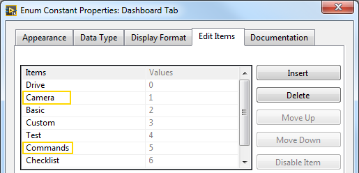

"Dashboard Main.vi" TabControl Enum items do not match the Tabs on the driver station
Dashboard Main.vi
The enum used to retrieve the control references on the ‘Basic’ and ‘Custom’ tab of the Driver Station are not correct. Missing ‘Camera’ and ‘Commands’ which causes ‘Basic’ and ‘Custom’ to reference the wrong tabs.
The Enum Items should match the Driver Station Tabs
Add ‘Camera’ and ‘Commands’
To make ‘Basic’ and ‘Custom’ line up correct.
This will allow the renaming of the controls on the Basic tab to work!
