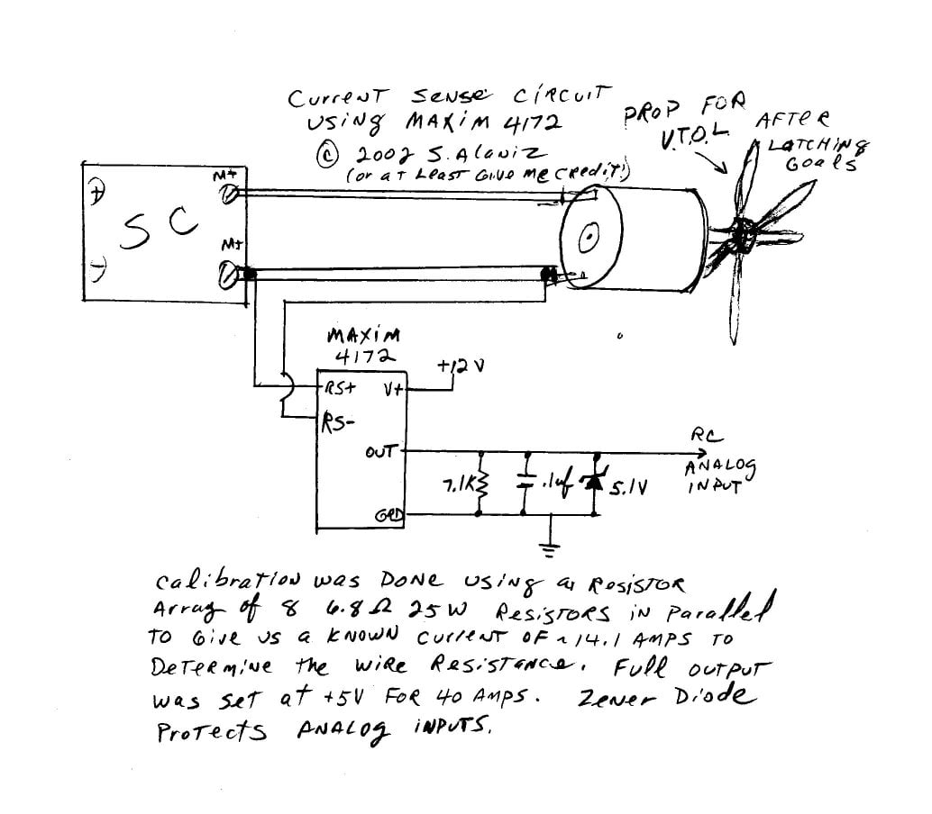

Tim Skloss,
Great design, could I add one suggestion? I know the circuit breakers are designed to trip in .1 seconds once the current reaches 40 amps, but in case of a catestropic failure it could exceed that amount for a very short time. In the unlikely event something happens we’ve added a 5.1 V zener to the output of our sensors as protection for the RC analog inputs.
We actually take our measurements at the outputs of the speed controller and I think our circuit works… we’ll know how well as soon as they allow us time to wire the robot.
Best of luck!

Measuring the current across the circuit breakers could be a good idea. I must give that some thought. I don’t like to measure the current on the low side of the circuit because that must change the ground reference of the victor. It all depends on how much resistance is being added. If you are measuring the difference in existing wires, the is not likely to be a problem.
The rules specificially state that you cannot modify the current path to the victors with the exception of adding insignificant resistances to measure the current.

Tim oops! Just re-read you’re first post. I guess you’re not using the analog inputs the same way we are. never mind! Quick question, do you use two or four opticals for phase/direction of your drive shafts? (I assume you’re not using “tank” drive since constant motor speed would prevent you from turning.)
Last question, HOW did you get your team to STOP rebuilding and give you time to put all this stuff on the robot? We’re STILL waiting for them to give us time to wire up the electronics (Oh we need electronics? Sure there’s a 6 inch square section we left for you. How long do you need it for? We can give you 30 minutes…I HOPE you chasis guys are reading this!!!) Sorry I digress.

OK, Finally figured out how to post this. This is our scheme for current sensing. we were able to “calibrate” our wires since the Maxim chip gives us a very accurate way of calculating backwards. We havn’t actually tested it on the robot but we were able to get very good readings from last years robot’s arm. I think a .22uf cap would have been a better choice but in the end we’re getting more information than we need. We’ll know tomorrow just how good this works. We’re monitoring 6 motors and using the Analog inputs on the RC.
